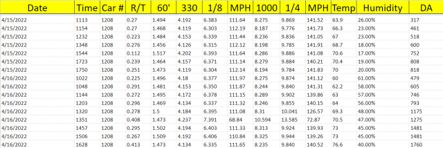

All righty, all the data from the event... The 60' is telling...

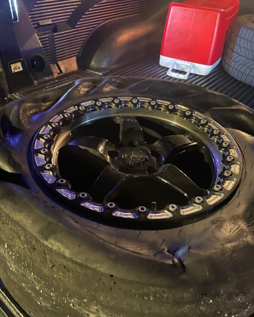

Today was just a very trying evening… should have stayed home…
At 3:45 locked myself out of my house.
4:30 got back in.
5:00 get on the road for the track.
Get to track. Make first pass. Timing equipment is off…

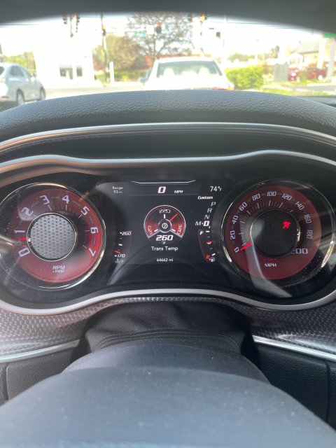

Make second pass, trans is at 260*
Adjust some things in the tune… HP tuners says temp is 186…
Make a couple of hits.
Final hit, car is just launching like a bat out of hell. However removing TCC lockup is causing issues. Will be adding it back into the tune. Too much heat.
Go to put air in rear left, valve stem is broke, nurse it home… and pray…
Ten miles from home, boom she goes…
A5A1ABB3-C95E-4D94-B0D5-699E754BD6F9.jpeg EB0FE6E3-08A6-4776-837F-309C5A61511C.jpeg
God wanted this tire dead, hit a large pothole and thats a wrap.
Get in friends car, get to house. Forget hellcat keys dont have house key, dont have garage opener… its in hellcat… drive back to hellcat, get opener, get to house pack streets in truck, a jack and some lug nuts…
forget the fucking impact at the house… use torque wrench as breaker bar… get street on rear left, get home, take dog to crackdonalds
get a coke with no ice, pour jameson in when i get home…
currently on couch sulking…

Did you just shut tcc completely off? To bad about the tire. That’ll put a damper on your race season
1,786
14,565
23 Challenger Demon 170
Lucky no damage to the rim ! But it still sucks….
I am lucky! Till this happened. Lights just fell on my car…

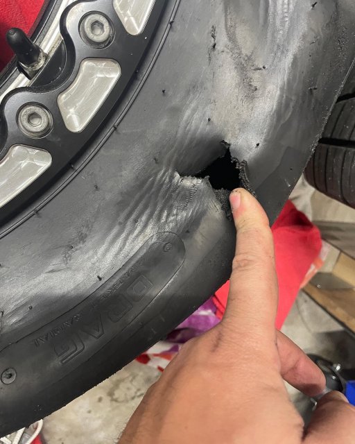

View attachment 68931 View attachment 68932

I had a drag radial get punctured at 11pm on the way home, had no spare, wife had to bring me a jack - tire.and next time I went, spun out in the rain.
Trailer was purchased the next week.
Sometimes you get a sign.

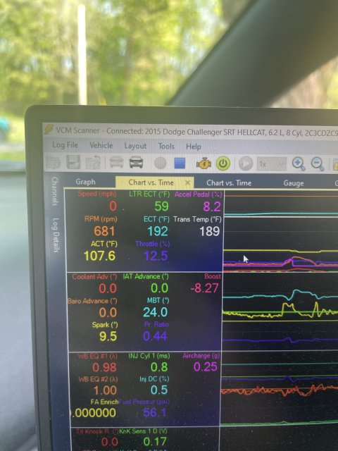

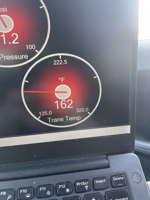

So for peer review here are my logs. I didn't get the sixth log as HP Tuners just stopped recording in the middle of it. The last log has me scared, wot 5 as it blew right through 2 onto 3. It was also using Shift ID's I have never seen before. I have also attached a tune that is my daily. It is the same as the one I was running at the track except I have turned TCC back on for gears 1-5 and I have lowered the WOT spark for 93 use.

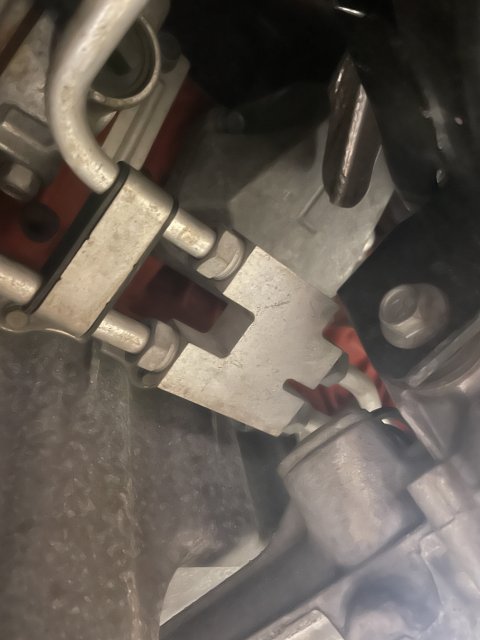

I'm at a loss on pass 5, I have no idea why the car was behaving that way and why the trans fluid temp was fluctuating between 163 and 260. My fans were running hard but HP Tuners was logging the pid and temps never got nutty. Yesterday at the shop I was underneath the car and the only thing we can think of is that the thermostatic bypass is acting up or something went wrong with the write of the tune to the PCM.

Add the PID "trans engine torque request mode" to your log. On mine when it's shifting it goes from "none" to "decrease" and I see my tqmgmt settings in the tune show up there. That happens at every shift. It does slow shifts by just a hair but keeps the trans alive. On your WOT5 log I don't see any timing pulled at any of the shifts and the actual tq stays very close to commanded as well.
That could be that trans bug in HPT that makes logs get a bit laggy when transmission PIDs are put in a log, but I do see other of your logs where timing is being pulled at the shift.

We believe it to be the tazer. Im sitting in stop and go gridlock after unplugging it and its cool.

I was just getting ready to take a look but sounds like you have it figured out!
