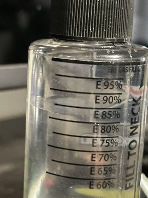

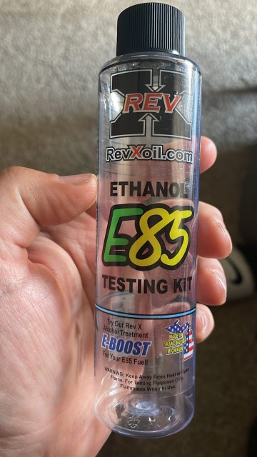

Thread Starter #679
Got about 15 gallons. Testing e82.5?
63,227
220,653
about where mine has been. This week it was 85% though. I have only been using one station that is just down the road from the house
