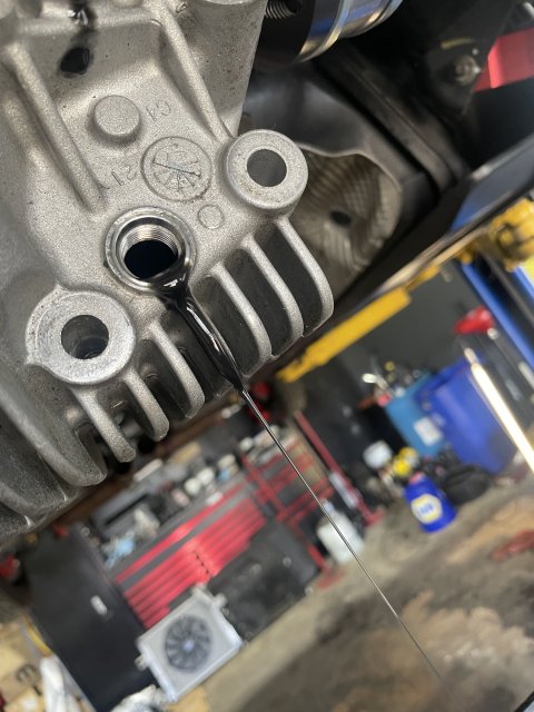

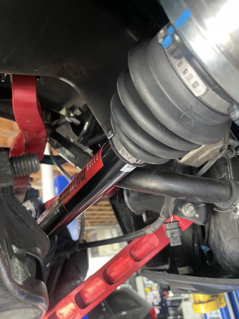

Was putting axles in, decided to service diff as well. Car feels way different in a good way. Drivers side axle was showing wear and tear.

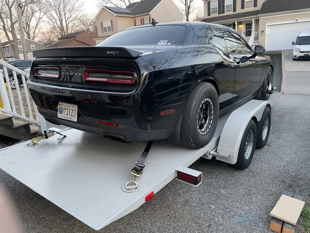

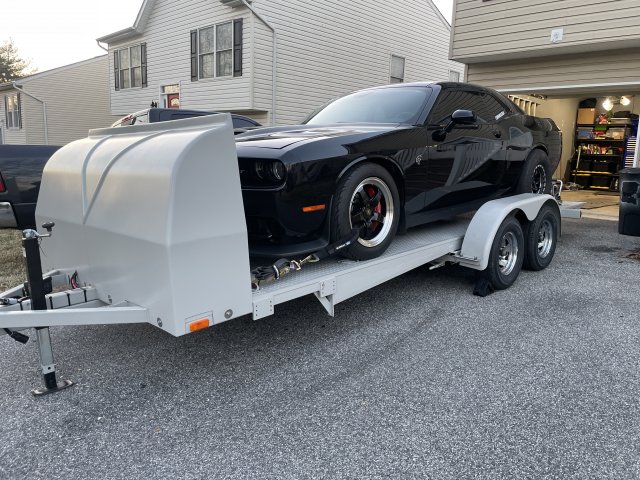

then to my delight learned the trailer would clear the driveway slope due to it being flat. I thinking I could get used to this bougie life!

Nice! Looking good on the trailer! Get used to your garage smelling like gear oil for a month lol

LOL, I learned that lesson already, I went to my friends shop and borrowed his lift.
I just brought my drain pan back inside been sitting in the yard for few weeks airing out after brake clean and degreaser lol. Worst smelling stuff ever. Changed it a few months ago and then topped it off again a little while back

Axles again, latest GForce axels are failing for many.

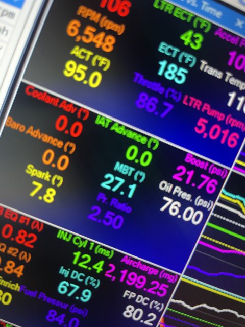

Not a problem broski. Start of pull: 62.6
End of pull: 87.8
Keep in mind air charge temps start to pull timing based on the following values in the tune:
You could move Part Throttle Ref IAT to 999 and it would never pull timing...
Didn’t you upgrade to triple pumps? Pump DC 89%, FP 79/80 psi, Or is that how it works on the control setup you’re using?

I’m going with axles. Those currently seem to be a problem.

driveshaft. Those axles are pretty stout
61,304
214,270
are the new DSS axles the way to go now?

winner winner chicken dinner, at the top end of the run she was fine, went to turn right to the return road and it was crunchy as fuck
This is how it is, pump 1 is going hard but the computer don't know about 2/3
I don't think its them but well know soon
see notes above also may be at play.
