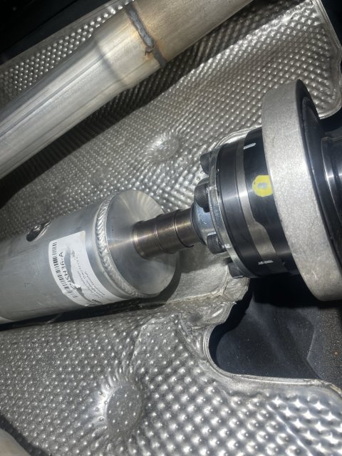

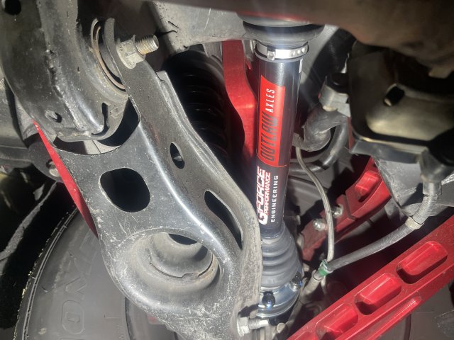

@16GoManGoHC2 got under the car today. None of the diff shell is broken. Axles where given the shake test by hand, seem fine. Trying to find a Demon diff. The regular 3.09 aint it.
AB7F5680-D4B8-41CF-B993-92A3AC3F4895.jpeg 60B931E5-EB08-4277-9D5D-ABCEB0DDCF5C.jpeg
checked the cv on the diff too full send till she goes
View attachment 101209 View attachment 101210

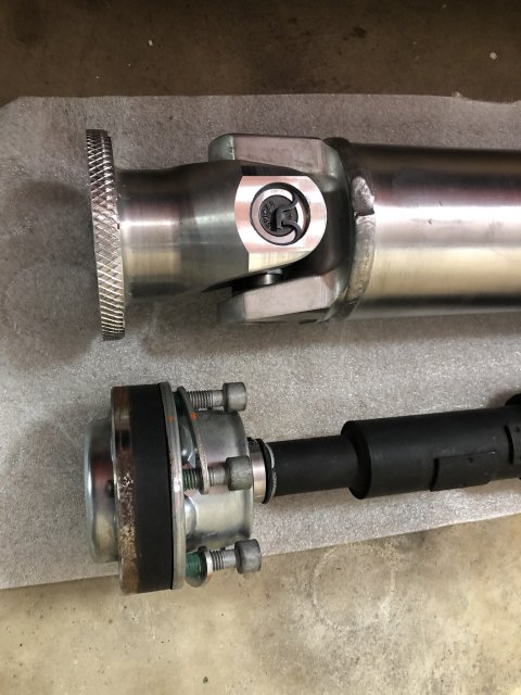

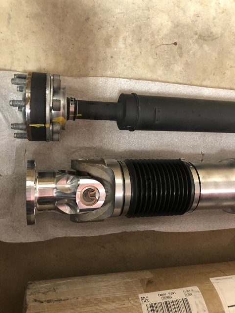

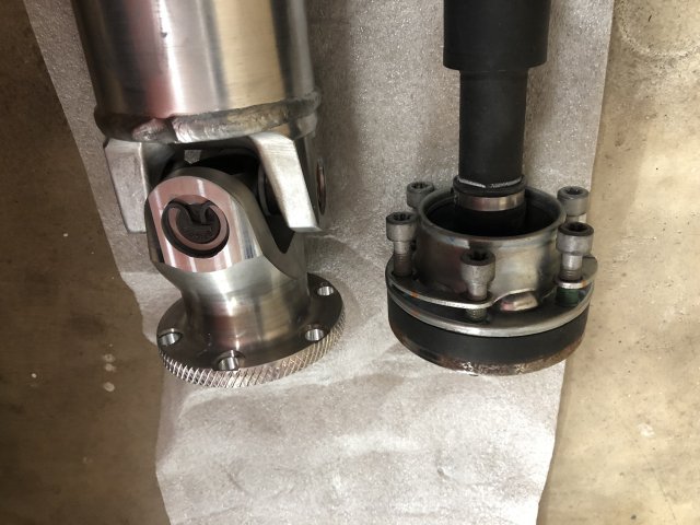

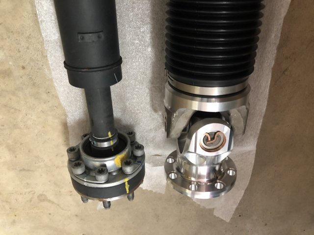

Man that spindly little shaft on that CV style DS is scary looking. You need one that looks like this, DS breakage is not even a concern of mine, the Wiles is like a Battleship compared to it.

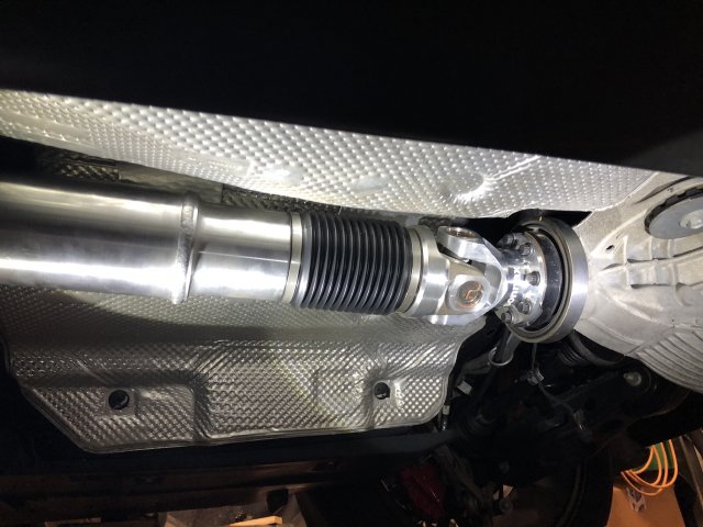

Yea, find a Redeye 3.09 Diff is what you need 6E08615D-4DAC-4015-A298-2862DFC5DCC6.jpeg 061ADB78-3D2D-42C9-A17B-B8F1D6AC8CD9.jpeg 23CFD83D-3771-405C-9C3E-C8104E7AB081.jpeg

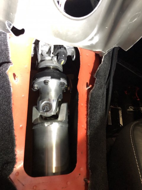

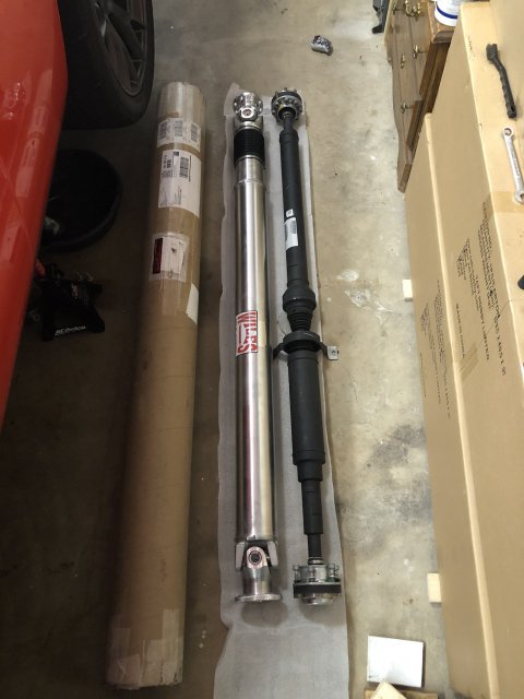

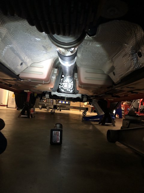

I have one, it’s still in the box, weighs 30+ lbs lol. I have faith in the Wiles DS, it really is built like a battleship, looks like it can take 5000 hp when sat next to a DSS CV type. Here it is compared to the stock CV type DS. But I do think about putting the hoop on, often.

There are lighter loops out there
3,814
9,032
Please post links, as I’d have no issue buying a different one but getting one around the big Wiles ends it tough, they are over 4” OD, the one I have will clear it but interested in lighter for sure.
