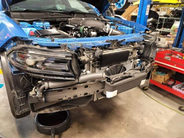

Looks good @WhipCat, just curious - what is the aux. fan used for ?... since you have the chiller & factory fans would be on with a/c.
Surprised there's room behind bumper for a fan.

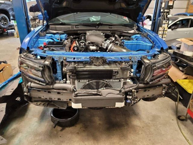

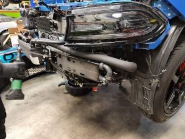

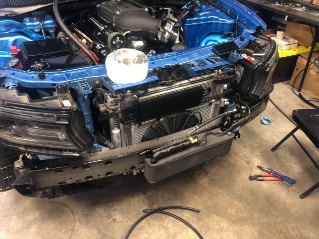

Progress with the FI interchiller.
- Had to ditch my 2 gallon front bumper support tank. The plan to make up for the capacity I once had is to serpentine some hose back and forth to create some extra fluid. This core makes my old 9” core look tiny.

zhc
7 Second Best E/T
#1019
412
1,400
2016 Dodge Charger Hellcat
I think you should find a way to keep the 2 gallon tank or have a custom smaller sized tank made.
Otherwise you’d need 44 ft of straight hose to equal just 1 gallon of capacity. That’s a lot of hose that will absorb heat back into the fluid plus the bends creating more head pressure restricting and slowing flow making heat extraction less optimal from the intercooler brick.
My little 1.25 gallon tank gives me enough chilled fluid to last just under 8 seconds WOT, just enough for what I’m doing. After 8 seconds is when warmer fluids start cycling back through to the supercharger. More capacity, more time.

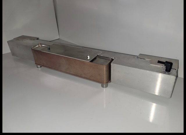

Couldve swore one of the chiller companies did a new bumper support bar with integrated tank.
That could be an option.

Yea a Florida company makes a front bumper that may fit it. I may see how this goes without the extra capacity since the core is about double what I had prior.

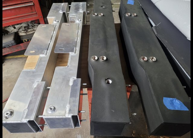

This has already been made for us. $400 or so.
5C866AEA-0BD9-46F1-8A97-3D36DF297A05.jpeg F21AE1CD-BAB7-4DAD-9B75-6269CA591574.jpeg

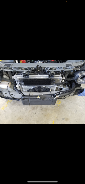

Thread Starter #335
DA798DF5-7410-454E-AC89-61A0AE2CFF0E.jpeg ABDE32A7-5A22-4557-9252-6AAA189F6059.jpeg E19AE00A-3824-4E60-9D34-0C08A54FE943.jpeg Almost wrapped up. Needs an ac recharge.

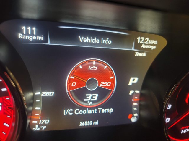

Thread Starter #336
Initial start up in drag. Still at the shop. Hope to get it tomorrow. I’ll see how cold I can get it.
11,025
Ice cold right there . I'm curious how well it will work in the heat of summer . I will be watching .

That is awesome! Is the cutout based on the FI interchiller core? What's the name of the company that makes it?
It’s similar size the Florida interchiller company makes it. The Australian core and their core is .2” difference.
