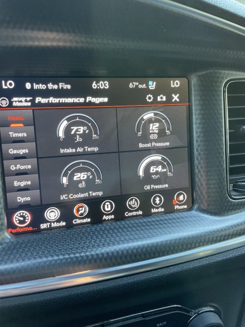

Ice cold right there . I'm curious how well it will work in the heat of summer . I will be watching .
I’ll get a good apples to apples compared to my old setup.

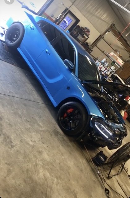

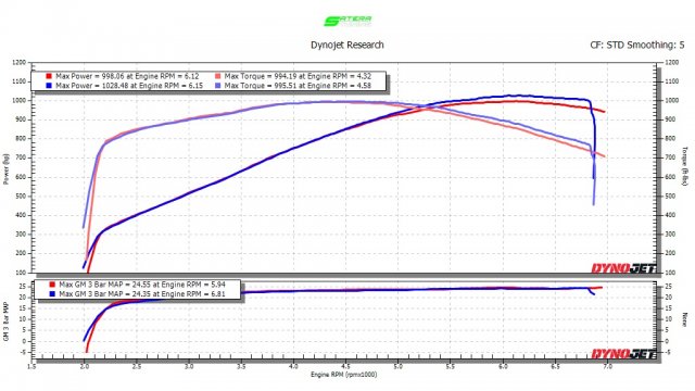

My pump E setup. Wanted to get an apples to apples, but I’m in summer trim now. Made about 1000 on my 275 snow tires, and we gained 30 wheel with the 112TB, but on 29” drag tires. Watching the videos I could see the crazy amount of wrinkle the tire was giving. I’d say safe bet 50+ gain from it, but trap speed will tell all. It’s a beast of a TB for sure and ideal for this particular setup.

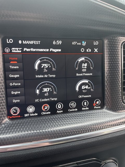

This is after about 10-15 mins of driving when it was 60-70 out. This system is out performing my killer chiller with the 2 gallon tank as far as cruising speeds and daily driving duties go. I have no tank anymore, but this core is double the size of what I had prior and has some more bells and whistles. Next test is wot IAT recovery.
This system would kill with a small tank I believe.

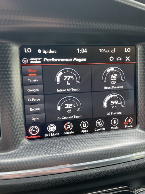

Ambient was in the 60’s, disregard the actual readout since that is my IAT. This kit seems to be holding up well so far. I’m going to start doing WOT testing on the IC temp recovery soon. 6860EF00-B9FD-4EFC-AAA6-EF724AB8F2B9.jpeg
