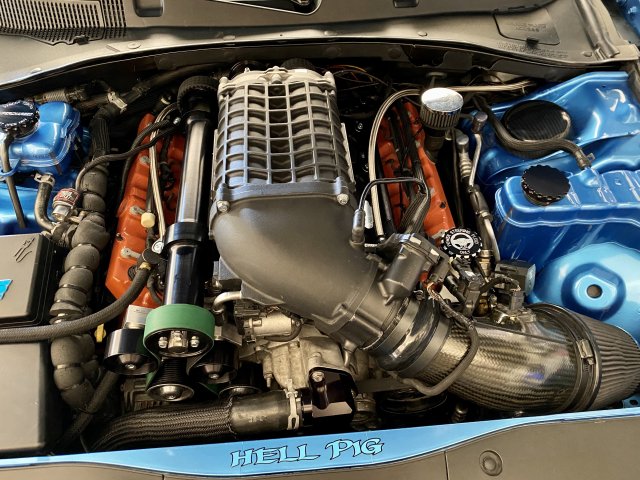

I understand the problems with a stock ported front bearing plate. I did this to mine 4 years ago before any shop was doing it. That's why I had to go to a Whipple. It put to much stress on the bearing plate and flexed the rotor's. I went with a billet aftermarket bearing plate this time. I'm still in the RND phase with this car. I agree the 3.8 Whipple will be the best S/C for an upgrade when they come out.
One thing about my setup it will never be just a race car / trailer car. I have way to much fun driving this 4 door sedan.
Hopefully the FAS bearing plate issues were a short term thing. One thing I know is those blowers don’t like RPM. We are seeing more and more come apart. As long as you aren’t WOT a lot, you might last a bit. It’s an all in setup for sure makes boost and also a lot of heat.

I'd re-route the TB connection to behind the air intake tube.
FFBOS
FFBOS
#1008
692
1,180
Mount Prospect
2016 Hellcat Charger
Thread Starter #147
It has a zip on it. Ain’t going anywhere lol. Behind creates too much of a kink for my OCD. 😂

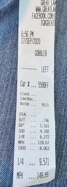

Good to meet you yesterday. Track was a shit show, but got one good run for data in. Can’t wait to get back.
3,293
10,474
Good results Brian. So...... rounding up, you ran 119mph in the 1/8 and 150mph in the 1/4. Stock 6.2 displacement with stock heads and at full weight with the un-ported version of the 2.65 Magnuson. On the first time out! ...... Hello 🤨
FFBOS
FFBOS
#1008
692
1,180
Mount Prospect
Thread Starter #157
Thanks. Yes I’m impressed with pussy footing it out of the hole to grab a log. Tried one more pass and it was a no go, then more people broke. My tuner made some nice changes to the shifts that will send even better. Also found out we didn’t even hit its “peak” for timing on pump E.
