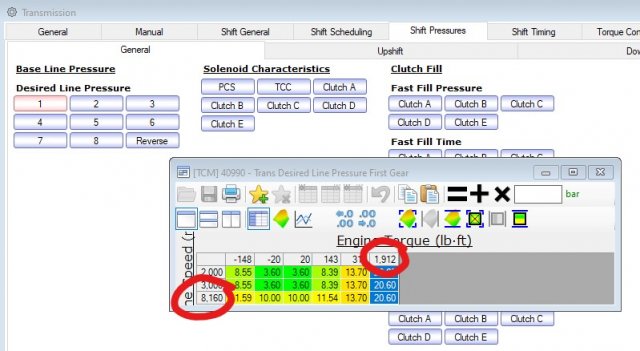

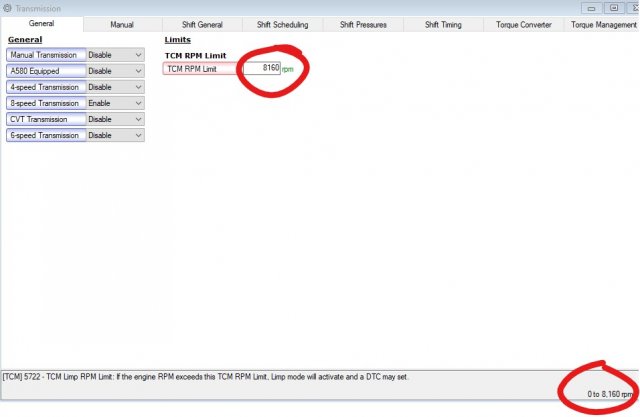

Food for thought, you can always attempt to up the max values to avoid banging into a threshold.
Factory settings in this TrackHawk tune were 6750 if I remember right:
I am not going to commit much brain power to this simply because I don't have anything, or any reason, to test on/against. But, there are usually work-arounds in the software before a new OS gets written.
