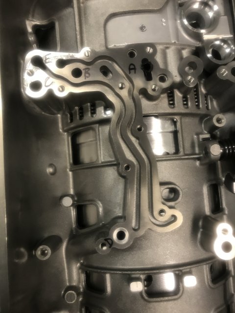

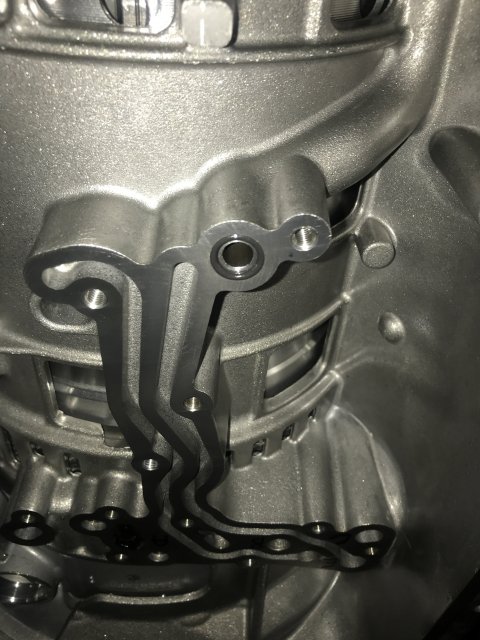

If you look back at the case where I marked the passages to air test each clutch pack you will notice that the passage marked D has a recessed area , almost looks as if a seal would belong there but it actually doesn’t but I was able to add an oring to it to eliminate any possible leakage between the Valvebody and the case CFA3C27E-A4CD-4BDD-9A1D-EF3FBA245AFE.jpeg 210EC991-BDD7-493B-8539-8E6FEABD2B95.jpeg

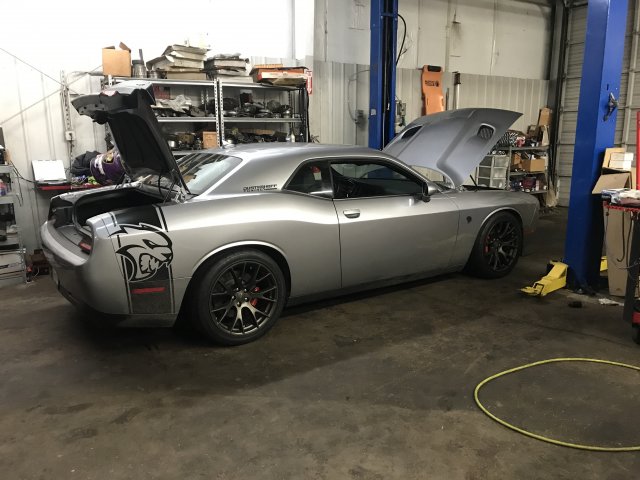

It’s been awhile since the stock wheels have been on the car almost forgot how it looked 14D53E4E-922B-481C-A5F1-072627396E72.jpeg
