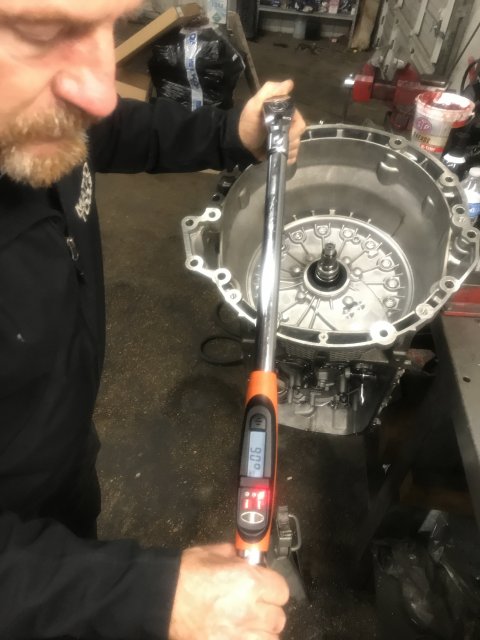

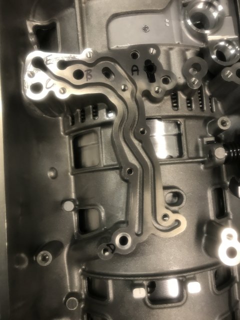

Thread Starter #448
Here’s some pics
I marked the places to air test the clutch packs also 2A5674DE-A80A-46C7-87D7-68216CD02803.jpeg 0F06185A-3B69-4EA4-9D2E-842CC1BC1357.jpeg
