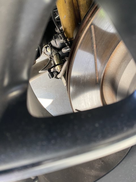

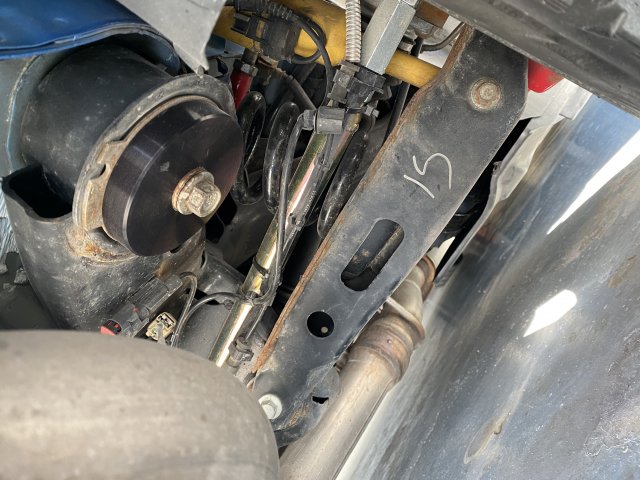

I can give you a street review. I noticed almost no change with the cradle lockout on the street. Arms stiffened up the rear quite a bit, but doesn’t bother me at all. I daily drive the car. Big plus is setting camber closer to zero for the rear tires.
Just locked out the cradle and put Nigel’s toe arms on.

What difference did you notice on the track with the cradle lock out kit. Install looks like a PITA LOL.

If you think that’s bad, check out the instructions for the solid aluminum bushings.

No squirming in the rear . I'd say the rear cradle can move around about 1/4 inch . The lock out kit keeps it square . But on the street the rubber is still there to absorb the vibrations .
It's pretty easy to install . The worst part is getting the limiting plate off the front of the cradle . But do as the instructions say and drill it ( I used a small bit to make a pilot hole then went with the bigger bit ) . Once you split it , it will pry right off . The rest is pretty straight forward .

Completely ignore the instructions lol. I have a little instruction write up that made it easy if you want it just PM me.

Exactly. That will be eliminated . I call it torque shift . I will to let you take my car for a spin to see the difference.

Either way it is a pretty easy install and worth the price of admission.
