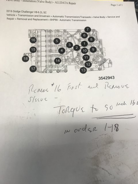

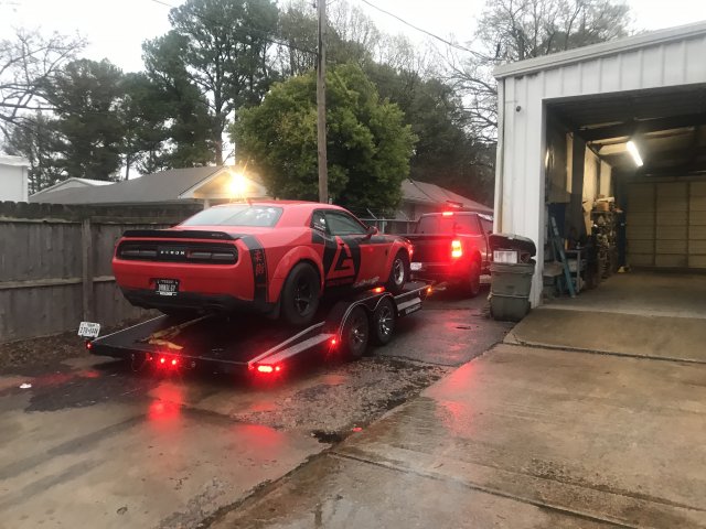

Even Demonology knows where to go for transmission repair 😃 A40DE18D-5A99-4A0A-B4A8-CEDC78FF18FF.jpeg

only problem is the devil cat will have to meet him on the track and take that demon back to hell and cage him up

Way to go @hellno , can't wait to see how it does , I guess you do know a little about transmissions :LOL:
Just enough to have fun 😃
