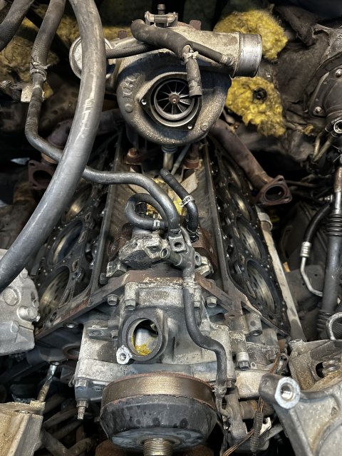

Doing head gaskets on my duramax right now that took my time. Will have buildup after truck

Oh that’s a fun job! NOT ! Although not as heavy as a Cummins head😮

Nope not fun add 401,500 miles on it

Book time of 43.2 hours at 150 a hour I will do it myself lol

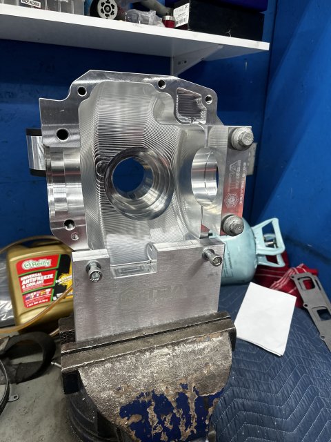

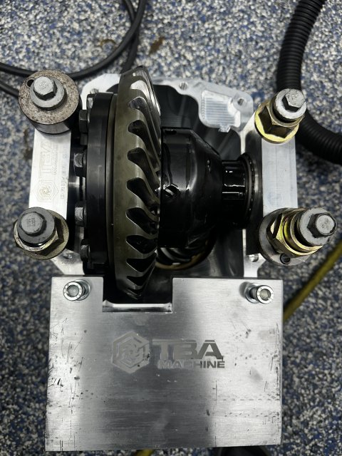

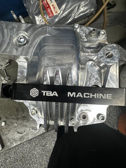

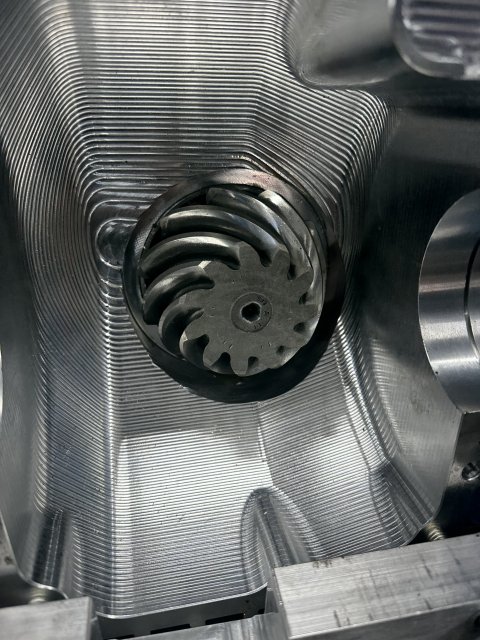

Update. I had time to get this together. And compare to the one aj sells.
Plus on this one over aj.
1) case looks better
2) snap ring that holds everything together is cut Deeper and will not fly out have seen this on other diff
3) more room to add shims to get back lash correct and preload for carrier bearings
Threads are cut better for fill and drain plugs
dislike about tba can not use performance development brace but TBA sent me one of theirs.
over all you can set this one up and not have to fight with it. They give all shims and seals needed if you buy just a case. I put a wave track in mine

anks for doing the compare! Looks beautiful. I doubt you even need a brace with it. I wish you could put internals other than ZF ones in it. So you have to buy a XF diff and take the guts and swap them over? Has to be a better way

Wave track makes a carrier that’s what I put in
