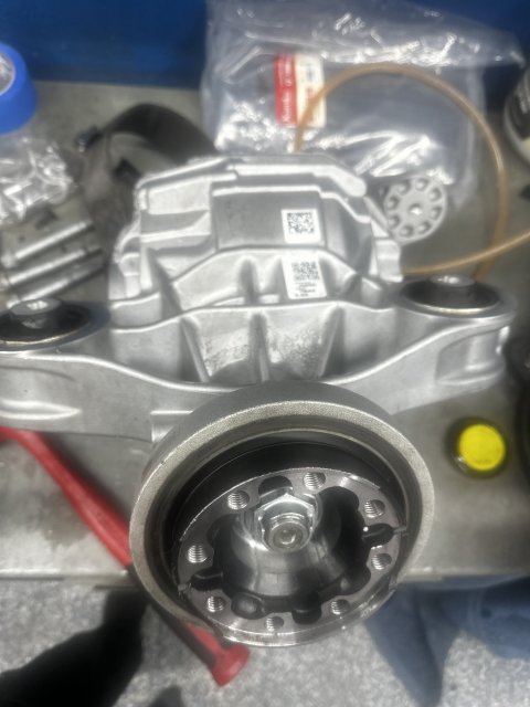

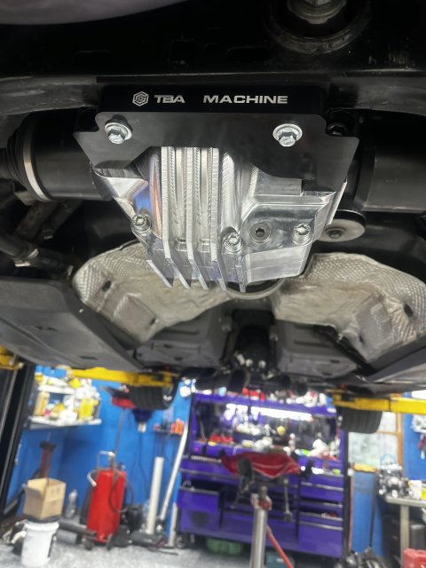

new diff is I. Sexy looking. Thanks Todd

This thing is purdy looking, kinda Jelly but I got some goodies on the way so I can't complain :)
0DFACDA9-BABA-4A56-BC4A-4ECB4C7F443D.jpeg 2FE9CF0A-18FC-4A22-993A-D5E92BFADE68.jpeg Yes you do
7,018
18,150
#51
If I end up needing this I'm having it sent to you for setup.

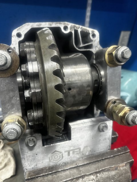

@Hatermkr I had someone ask me a question about these factory diffs in these cars. Is the diff cover part of the main bearing cap or is that not even applicable on these?
Hatermkr
Hatermkr
#15491
1,279
2,652
West bend
2016 helldemon
Thread Starter #59
The caps are part of the back half of the case. TBM machine makes bearing caps you can put on to set up rear end. That is the only way with the with out the case 100% together
