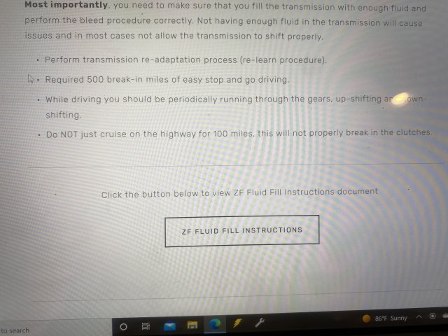

So I think I am out of my element here. Last night we installed my Pure transmission. We got it all buttoned up, did the fill procedure and got it ready for driving. We are following the guidance here:
https://www.puredrivetrainsolutions.com/break-in-process

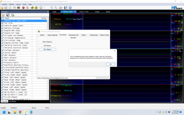

Mike's Wi-Tech couldn't locate a relearn procedure to run. We switched over to HP Tuners. Cleared all TCM and PCM DTCs. Reset all adaptives and then did the Fast Relearn procedure. Mike said it went through all the gears. Drove it home and it went into limp mode. Would not get out of sixth gear. Stopped in a parking lot let the car reset after turning it off. Went into limp again and got it home. Today, reset all adaptives, reset all the DTCs and attempted to do the Slow Relearn this time. HP Tuners gave me this error:
Attempted to do the Fast Relearn and nothing, same error.
Reset everything again and just put into reverse, backed it out of the garage and drove it. Went right into limp mode again. I'm kind of at my wits end with this car. I don't know what to do and I can't put any more money into it. I have reached out to Pure and hopefully they will get back to me soon. But if anyone has advice please don't hesitate to chime in. Tune, log and error codes are attached.

500 mile break in
Shit I quick learn and beat the hell out of it 😂

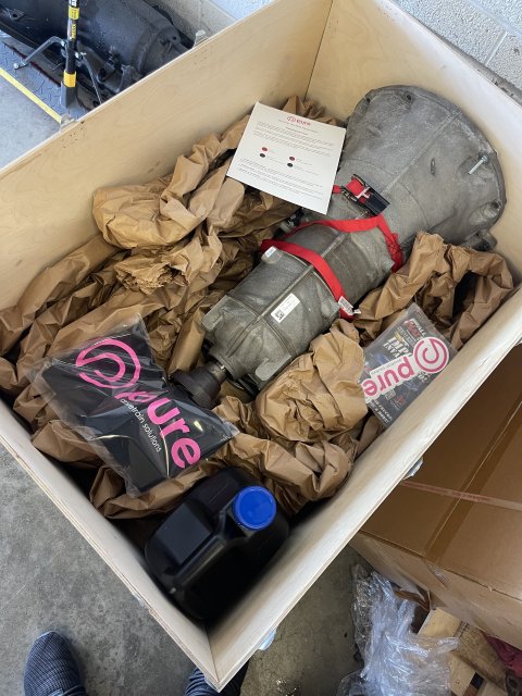

Spoke with pure again today, was told there were two, one ounce quarts and the two gallon container. Evidence A: crate opened upon delivery.
notice no two additional quarts.
