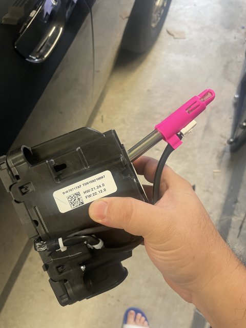

shifter was put in, code didnt go away, car goes into limp
