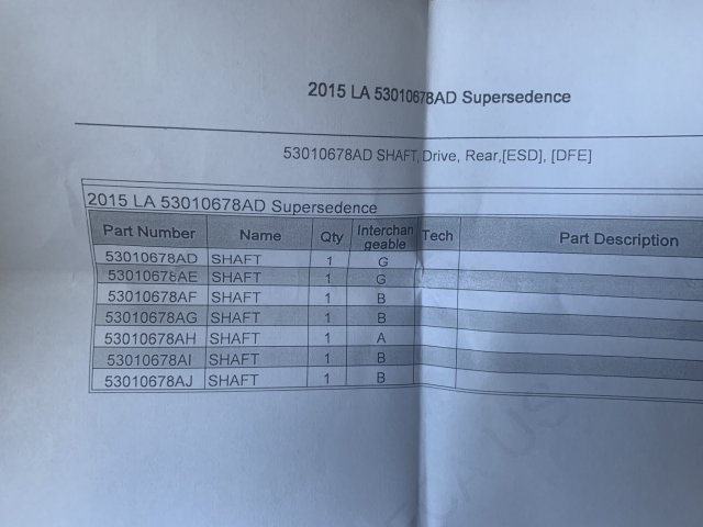

Went to the shop today, recall work was done. Brand new cats, O2 sensors and a PCM flash. Wonder what it will entail. Will compart logs after I get her back. Spoke with service manager and we talked about the drive shafts being a weak link. He explained he agrees 100%, he said there have been seven revisions since they were produced. He printed out the interchange sheets and showed me AA through AJ. Thats crazy!
Drive shaft wont come in till Monday. Delays are temporary, improvements are permanent (or until it breaks again lol).

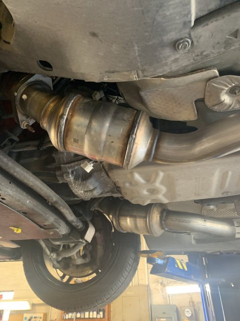

Me too, the cats from the fix appear to be bigger, we’ll see. Also going to hit up a dyno as well. Was around 640 at the wheels prior to this change. Maybe even lost power from the driveshaft (debateable tho)
You know, small shops who don't have a huge R&D budget are able to put together some pretty good drive shafts (some of them) and it is a sign to me of the weakness of corporations that on the Dodge / FCA flagship car, essentially, they can't get it right enough after 7 tries with literally millions of dollars and some of the best CAD and testing set ups on the planet. Kind of sad. but then, that electric truck company, Nikola, that has not delivered a single commercial or personal truck yet, has a bigger market value than FCA. (Admittedly, they have 10 billion dollars in pre-orders, but still). Maybe the majors are dinosaurs?
I agree. Manager and Tech though decided to nip it in the bud here tho, they ordered me the Demon drive shaft. :)
5,202
9,661
The cats do look a little bigger in the pics or its a allusion from the pic ?
