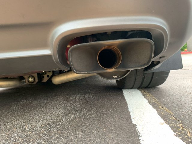

I’m out. Great info. Here are the tail pipes after a day of WOT on a road course.
