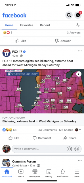

So when does it start snowing up there?
By the way temps have been up here I'm not sure it will ever snow again . 100F plus humidity is just stupid .
