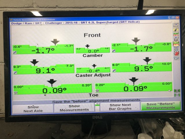

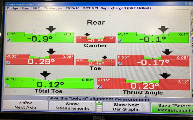

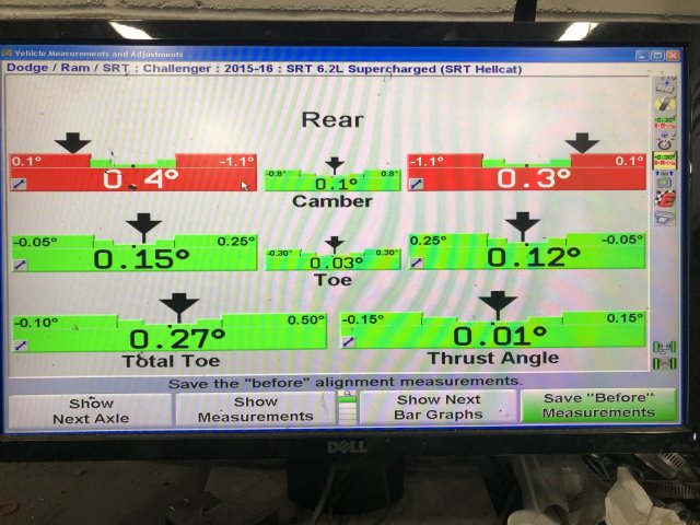

Alright. So I’m out of there. I was there for 5 hrs. he charged me for 3. Yes, 150.00/hr as he advised me from the start. Total 488.00. Below are my before and after rear readings in addition to the front. I haven’t played with it as I had to get right to work. I was looking for as close and flat as he could get it bearing in mind a few of the thoughts you guys suggested here and the other place. Thoughts pls. Thanks.

That really isn't bad for a first timer and a 5hr crack. The numbers look pretty good overall. I personally would like to keep toe close to 0.10 and if you want to get closer to 0.0 camber go down 1 tab on each side...so if you have 7's go to 6's. Each tab is ~0.20 degrees adjustment or thereabouts...but all that is just being picky. On a good hard launch that should plant plenty flat for you.

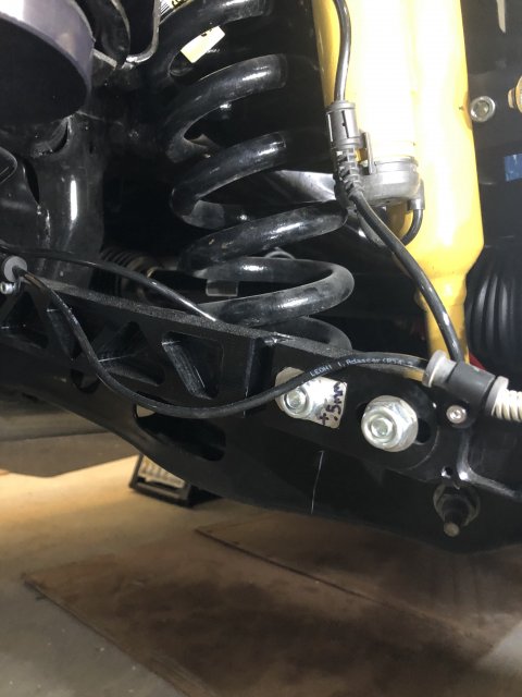

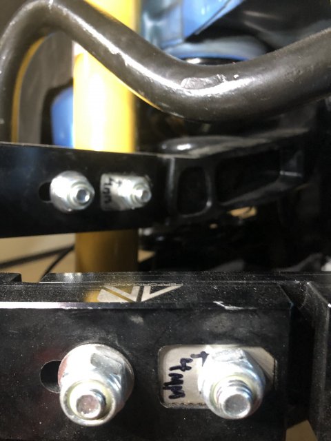

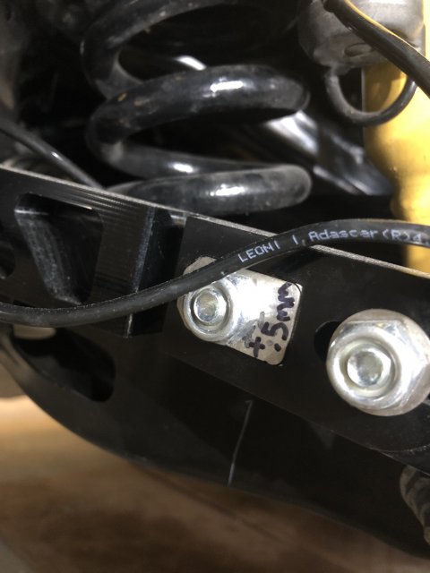

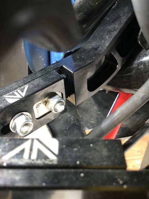

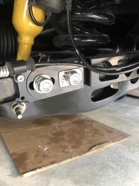

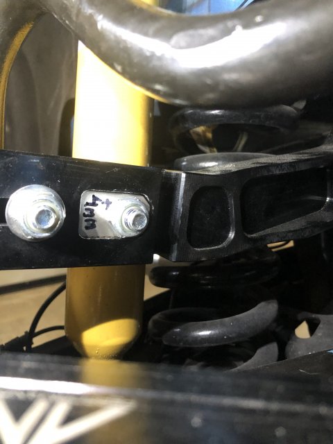

@vortecd under the car today. +4mm on either top arm, and +.5mm on the longest bottom arm. P/s pics first:
B186CB02-8966-4AB6-B3A7-BEA50592D570.jpeg 9C7A6F24-891C-4FB2-A0C1-490DE719FB89.jpeg DDD0B51A-7915-4E79-A618-7B759A1AB887.jpeg A766CEAE-ECA8-4210-8802-C6A84A6183D9.jpeg
On the d/s both upper arms took +6mm with the longest lower are taking another + .5mm
5F4CEB95-0E86-47A8-A8AE-ED36A4C24577.jpeg C4BD940A-8B37-4531-BCE1-50779B4205C0.jpeg D3988D3E-CBD3-415C-B87A-F1D8B14DC5FD.jpeg D8A177A0-1222-4A15-8A6C-690489AFDC69.jpeg

That's less than my car took. I needed 6's and 7's.
Glad to see the toe rods needed minimal tweaking too. They must be pretty close from AAD.
