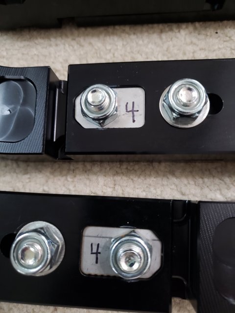

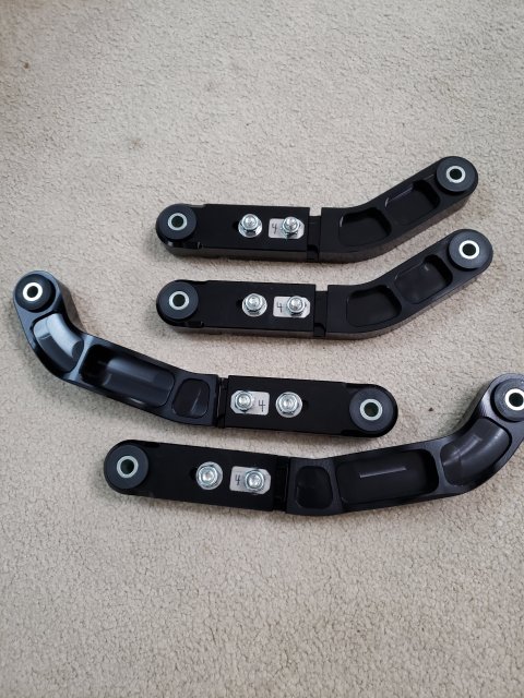

Going to do my arms this weekend or next. I decided to start off with the 4 tabs 20220518_173526.jpg 20220518_173529.jpg

What I remembered most is I needed a few 18mm’s of various types and a few extensions. Good luck, easy but a bit time consuming. Dropping the cradle the way to go imho. Don’t forget to unbolt the brake line on the d/s. Also, if you’ve got a rear strut tower brace don’t forget to secure the nuts holding the shock bolts which also hold the brace.
Edited to add, now that I think about it I did cut the one bolt on the drivers side on the upper front frame side arm. Cut from the bottom up, not through the wheel well as others. I wasn’t going to cut my sheet metal either. Thanks for the reminder fubar. I’ve dropped the cradle before to do the BMR Cradle Lock Out Kit so I got confused for a second there.

With some extra patience and a 6-9" blade I cut the bolt and flipped it without notching the body or dropping the cradle. It will test you...but is doable.
The rest is pretty cake.

What was interesting in the instructions is it said you can make all your camber adjustments with the long bar (one next to spring). I would think they both need to be the same but that isn't how it reads. I just started with them both the same

That call gets interesting. I would start with both the same. If you run into toe adjustment problems you can start playing with the “front” arm, but that is a dark highway. I spent maybe six weekends all together screwing with the alignment and those tabs, since I have the whole set. But changing out just one of the two sometimes returns surprising results, like N/C!!
