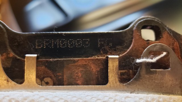

Ok this all great information but you gotta' ask yourself why? Meaning, that's no accident. That pad is cut that way. Again meaning, this is an EXTRA process and more time (and theoretically money) to make it. You can see the material was there and taken away. There must be a reason. Maybe they recalibrated the break pressures front to rear at some point in '19. I dk. But I will say this, even with what looks like a waste of surface area, my car stops on a dime. Now I'm really wondering. ??
If you were going to recalibrate, you would change compound. Not cut the pad in half. If my rotors looked anything like those rusty ones! I would be screaming mad!

OK so they made a deliberate change for some reason, or possibly a substitution since I could see this being turned down for a smaller rotor using the same pad......I took the wheel off and tried to get a picture without taking it out....put my finger in there and was like....where's the pad? Then I said aww hell with it, I do have a small ballpeen and a punch that works....so let's pull them out.
This kind of has me P.O.'d a little.....WTF Dodge???
The last picture has the PN, if anyone wants to cross reference that. I am wondering what the reason is....seems like a waste of rotor surface to me! Unless there is a good reason for this shit.....PowerStop here I come!
View attachment 14827 View attachment 14828
Just looked at my rear pad and it's identical (well, except for the wear groove in the middle)
