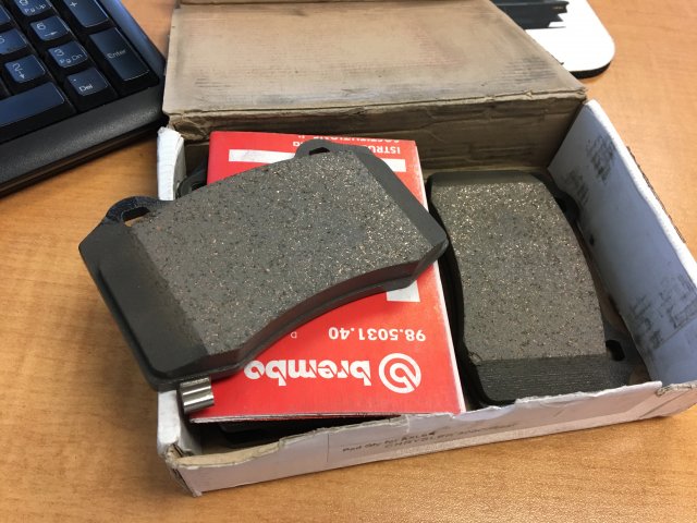

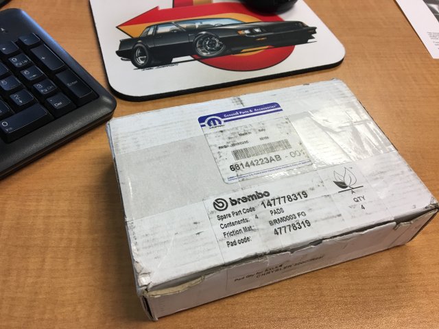

My parts manager is on the search for a set of AA or AB pads, if there's any out there.
EDIT - Looks like he found two sets at two different dealers here in Houston. I should have both sets here on Friday. Since I only have around 300 miles on the car so far, I'm sure I can just swap them out without doing anything with the rotors.

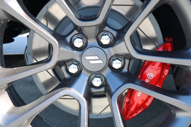

here's a pic from a new on the lot Charger.....
20,164
lol, oh man is that rich
20,164
That brake solution....
2,695
Looks like the new standard across the board for the performance brake package. Doesn't SRT have anything to say about this? Not boding well, when the performance experts at the performance end of the mother company get over-ridden by office people responding to customer comments on non- performance issues. Soooo if these same people bought RE's and complained the supercharger whine was too loud, does that mean they grind off 25% of the supercharger. Oh wait, then it would just be a regular Hellcat. :p .

I was looking at that too. What's the point of a rotor that big if you're going to have all of the unswept area? not to mention that this will cause the rotor to wear in a concave fashion.
20,164
That is still bizarre to me. I suppose they did testing to determine that the sloped pads actually decrease the hated sound, and that there is no significant decrease in performance.....
