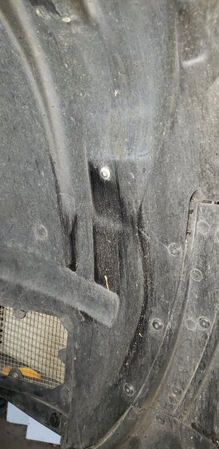

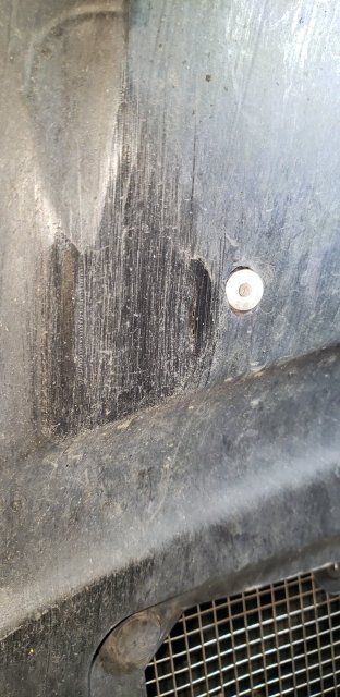

Yes, the 315/35 PS4Ss rubbed on the center of the front inner fender liner, just a little. I assume on track, as I never heard it rub. Left side slightly worse, both rubbed the heads off those plastic rivets so I replaced with aluminum. Might've been worse but the OE upper arms didn't hold camber so the outside shoulders of the tread were destroyed pretty quickly. Again, not sure when it rubbed, just know it did.
The 315/30s have not rubbed that I can tell.
I wonder if anybody has tried 325/30s on OE rims and to what effect? I'd be in for those if no rubbing! 20220302_180305.jpg 20220302_180407.jpg

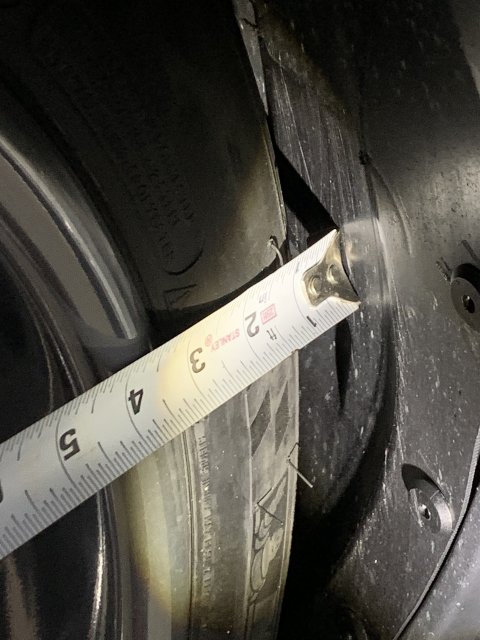

You guys want to know what else fits?
Take the wheel and crank it left or right. You will find the outside edge of the tire nearly hitting the front liner. ***Dodge your junk liners suck*** we don’t have squat for room because they fit like baggy pants with stupid Chinese push pins.
Measure the remaining room before you buy a taller tire. A fatter one makes it marginally worse. I say that because with a gapped out 11” wide wheel to match a staggered rear 12” wide wheel…A 305/35 rubs!
