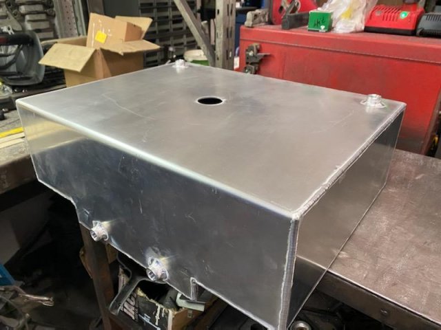

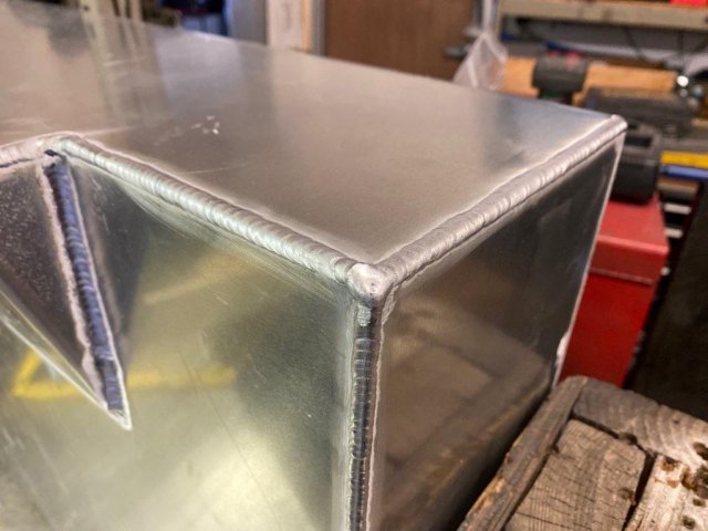

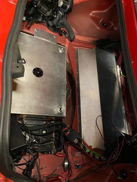

So what do you do for a fuel tank in one of these 4-link conversions?.... you ask! Custom made 15 gallon in the trunk with a 2500hp rated Aeromotive brushless external pump.. what else? B2C05228-0578-4ABD-803E-7C37A305A229.jpeg E478BC22-631D-4EE8-B197-03B8B38DF81C.jpeg

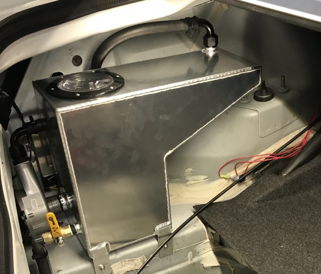

So.... back to what’s going on in the shop and not manufacturing politics. Here is the new 15 gallon tank in place and you can see the cover over the cut out that allows the differential to move with the suspension. Because the IRS diff is fixed, there is no need for space above. Not the case with the live axle so the overhead had to be increased some. 7C256272-ADF9-4A04-B04B-C6B0EE3AE583.jpeg

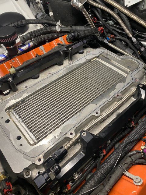

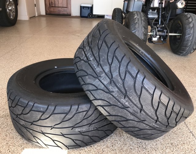

So what do you do when you have a 15” conversion and want a bad ass street tire that will work on the dyno? This. 😝 6F0431F4-E35B-4275-92E3-90EAD68A9576.jpeg

As fun as those are, it’s actually out of necessity. They are exactly the same size as the 315/60-15 Radial Pro I’m running. 30 tall by 12 wide. The race tires are no bueno on the dyno so I need something that is going to be the same diameter for gearing and be able to put the power down to the roller. Looks like it would make a great street tire too.

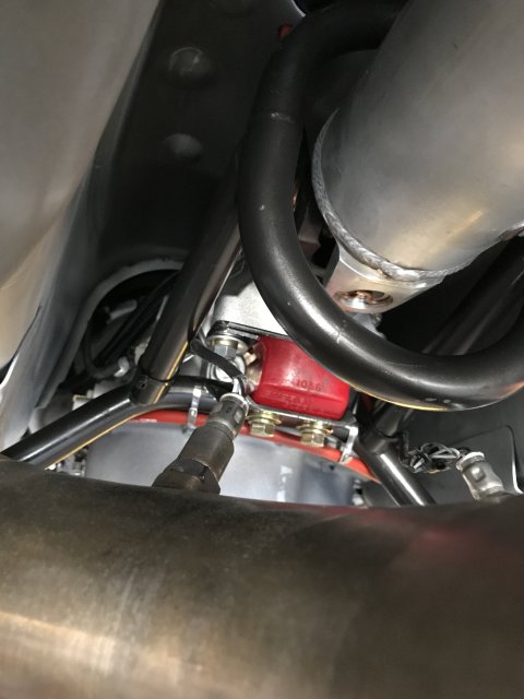

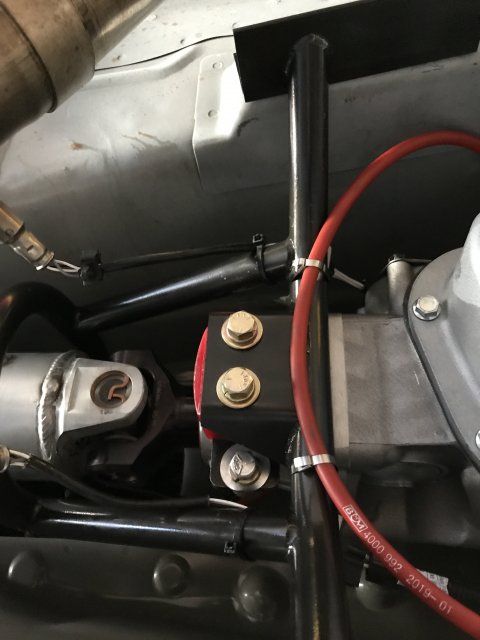

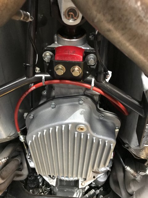

New cylinder head stud package is in and Stinky is up and running. Replaced the T400 crossmember with one of the Gearhead Fabrications Chromoly pieces. Super light and strong with a built in driveshaft loop. That thing is locked down now! 7FF8C016-18F5-47DD-AB34-159D20CAA5FF.jpeg C4BBF184-DA05-4DE5-9D3C-2BC5E958D361.jpeg EB50CAF1-9828-47DC-AA45-3AD6F265BC0E.jpeg
