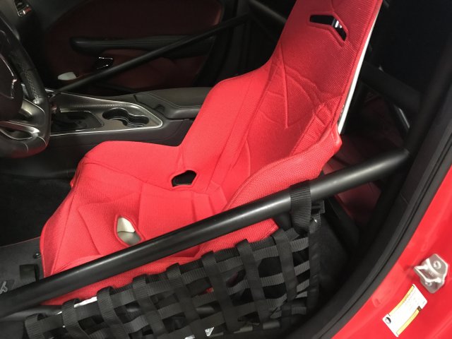

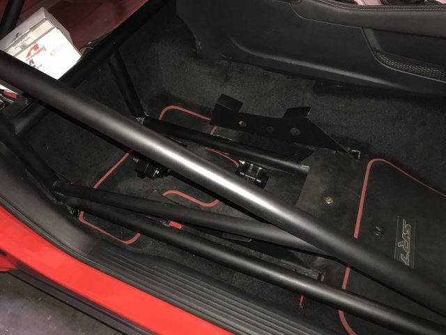

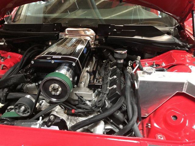

1100 mile round trip to Calif and then over to Phoenix to bring the new project car to the shop. It’s starting to take shape! DB7AE370-0D7B-4512-B4B4-4BF1DE25ACE5.jpeg 1F20E02E-B9E8-470B-AC64-94AC89A1590F.jpeg 93AC2C75-692F-446A-9F2C-165DFC8CB01A.jpeg 8DD173C9-026F-47A5-BD0A-3BEB50B741A5.jpeg 21CFAF8B-FA8D-4FBC-AE73-357FD9B41A84.jpeg

Why the change in head studs?

He put in the big boy 625 head bolts and studs in.
I will let Marc clarify the reason why he did. Another good insurance part to protect the engine at his power level.
I can't count how many times I used that transmission mount in custom applications.
Just a upgrade to the ultimate in preparation for more hp. Don’t want to risk a expensive motor by lifting a cylinder head. Trying to stay one step ahead.

That cage looks different because it is. It’s basically a 7.5 cert without the added “funny car” hoop. It’s a 7.5 “prep”. The reason for doing that is to give the 4-link the necessary support to work at high power levels without bending the stock body all to hell. Everything gets ‘triangulated’. This car will end up a seven second ride but there’s a lot learning and experience to be acquired leading up to that. The owner/driver will be best served sneaking up on it. When that time comes, the additional bars will be a easy addition as all the hard stuff is done.
