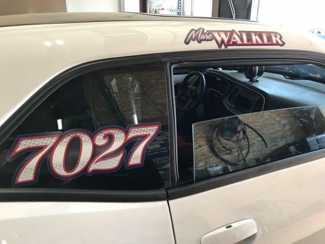

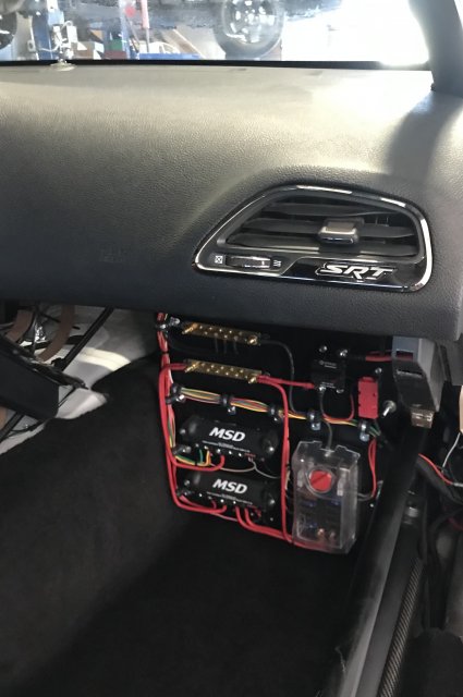

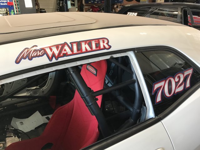

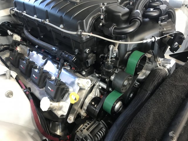

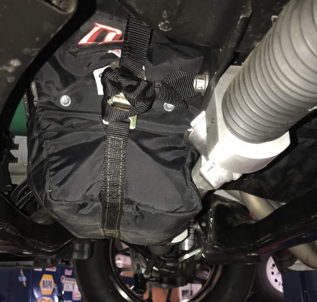

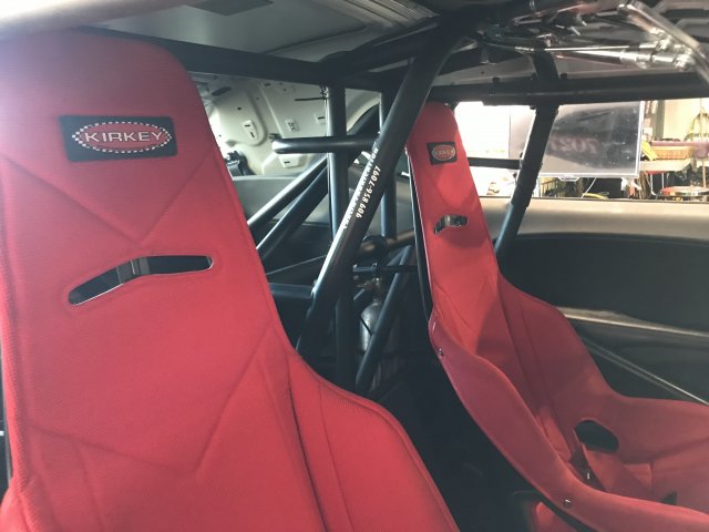

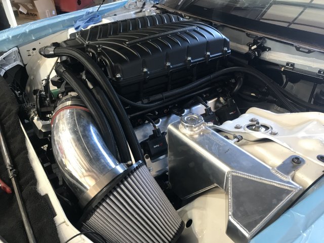

On the dyno next week. I couldn’t wait. I had to pretty it up a little. 🙃 A41DFFE9-C2CA-45DC-BD53-A3AC185BE83B.jpeg 02472ECE-7471-4536-99D7-FF72FE6071E3.jpeg B4122B0A-84AB-445C-B0AA-DA1286AFF6CB.jpeg

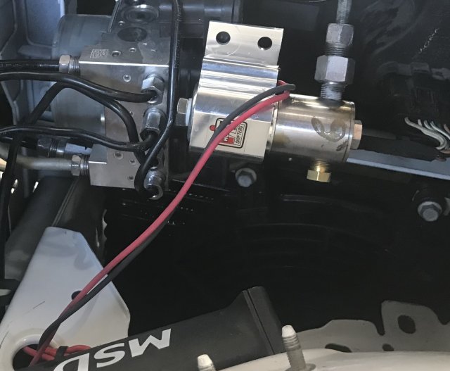

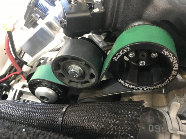

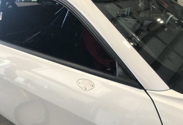

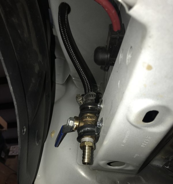

Got the custom idler pulley (to increase belt wrap) made and the Hurst line lock plumbed. Also got the power windows working. The list is getting short now 🥳 B6B2287D-9708-474C-A072-F22CBD10E74E.jpeg E08644CC-5174-4C53-9760-A36E7D11D465.jpeg 446742CE-B1C3-42F7-B6D7-C2B2A57FFB60.jpeg 6D9DAEF3-627E-4C27-9422-214B82F64A49.jpeg

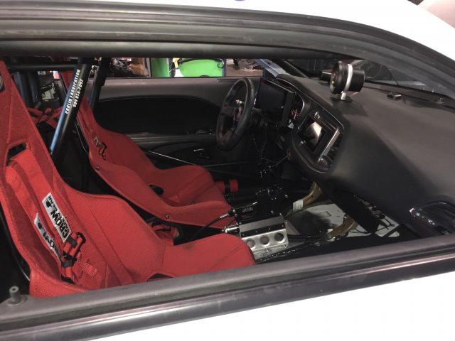

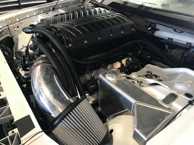

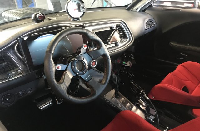

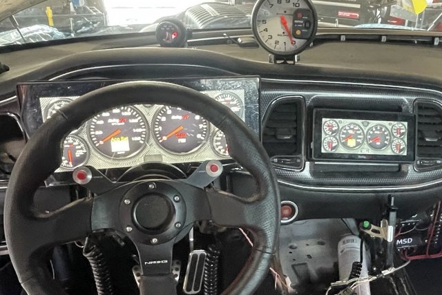

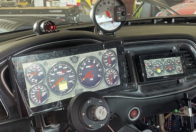

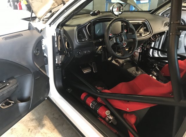

Things are just about to the fun part. 🥳 9CD07E6A-7601-4F65-AE9A-3E90E354F033.jpeg 3EDDB865-F68D-406B-B29B-EF8867DFF1A2.jpeg

You guys model that after the new Mustang dash? :LOL:
Getting close can't wait to see some testing.
Lol. These Holley EFI Digital Dash’s can be configured any way you want. I could put a picture of my dogs face on there. Those screen configurations are just one of the base setups. We’ll be changing that.

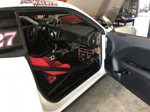

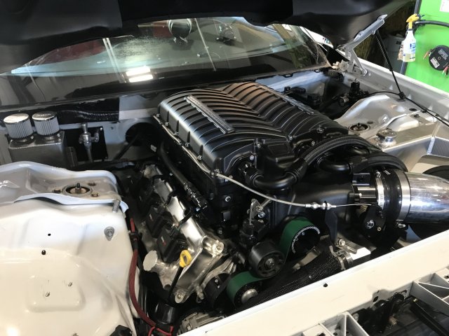

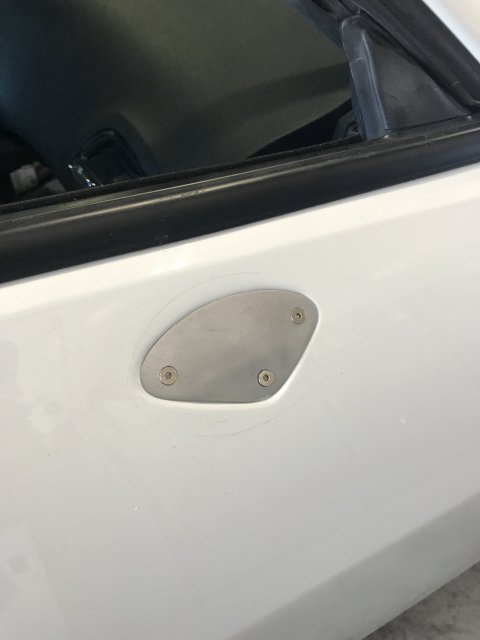

Well big day today. The long long list of things to be done is…. Done. Interior is in and will be on the rollers tomorrow. Some assorted pics….. A12C2308-8C20-4B52-9CB5-D83E2E65A777.jpeg 183FE2E8-BC55-46D9-981F-EFD667215F98.jpeg EE2CF511-CF78-406C-9C74-EFAABD8BA2EC.jpeg 5A23F66D-008B-4B71-A71A-F49BEE30316B.jpeg EABF8987-236C-439C-BC31-91D4B65736F0.jpeg EF2B2FFA-F970-46D4-94EE-9946E27F0D32.jpeg 63D1B6B5-058D-4F4F-AC39-DED180B84776.jpeg 39E47085-60FC-4FB3-B27F-CA0B7C779F4D.jpeg C67F06F7-DAE7-412C-9ED0-327FEAE600A3.jpeg 3DD28239-AEEC-4FA1-99E3-E481226F04E4.jpeg 2BC0BB1F-BCE6-4BC7-9CA0-09D83EF01F4F.jpeg F907E44B-4185-45B0-88AD-B0786C0F3458.jpeg

Beautiful. Looking forward to tomorrow’s results.
(I can’t unsee cyclops aliens on those seats. ;))

I love a man in a diaper.
I mean, motor… motor in a diaper.

Got the custom idler pulley (to increase belt wrap) made and the Hurst line lock plumbed. Also got the power windows working. The list is getting short now 🥳 View attachment 84685 View attachment 84686 View attachment 84687 View attachment 84688
I wonder if you could have went with a griptec pulley and not use the adjustable idler pulley? You are making way more power but I'm not seeing any slip with the 3.00 pulley on my Whipple
3,633
11,720
Thread Starter #1,158
The 3.0 is just there to get everything comfortably dialed in (including suspension tuning) before moving to the 2.75 and 25+ lbs. Sort of batting practice before swinging for the fence. That idler was a result of experience with the blue car and proved to be helpful. When we go to the smaller pulley, it’s going to need all the wrap we can get. Before this thing gets figured out we’ll be replacing it with the 3.8 Whipple. That thing is going to be a whole mother monster. There’s only 10 of them and we got one. Hold on to your hats 😵‍💫
