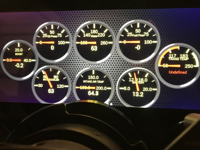

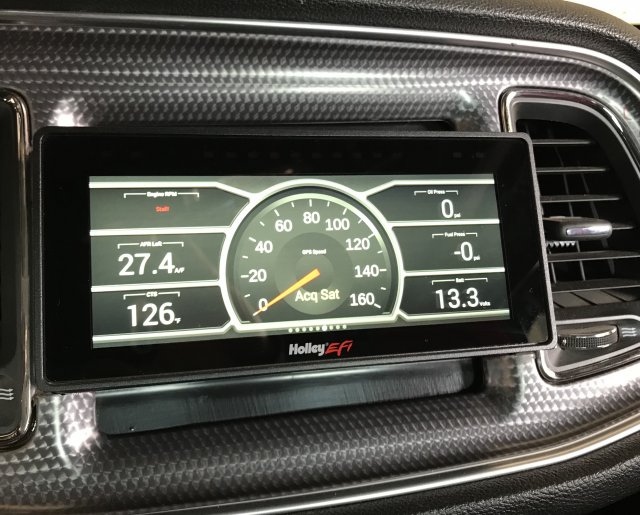

I found the digital dash display that suits the car. This whole system is something else 😂 F3F5B11A-FC64-4E6B-93FE-024FD11C7871.jpeg D1685717-2A51-4F4E-94C6-9A798A98F795.jpeg 18E57951-916F-4EBF-B3CD-B61CADAAA315.jpeg 1ACAE23D-4084-4222-B118-D879CAC3DD00.jpeg

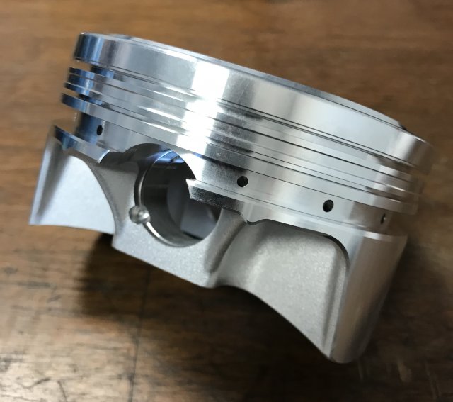

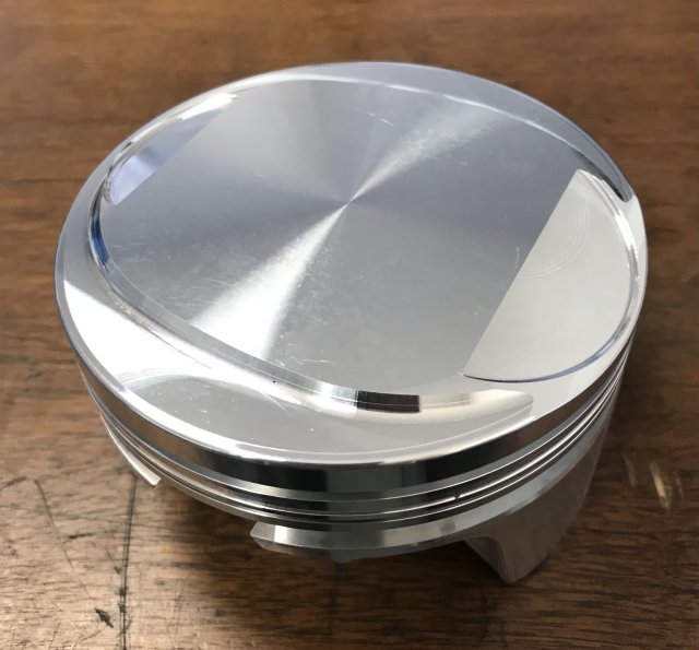

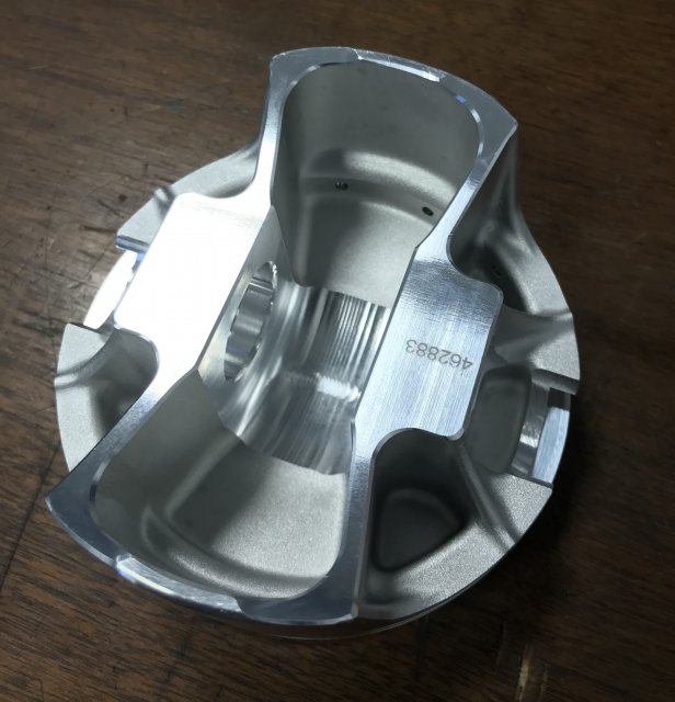

So…. Anybody else waiting on parts? 😐. Right now it takes about a year to build a motor if you’re going with the good stuff. We’re building a ‘Right Stuff’ 401ci bullet and just about all the stuff is here! The pistons came in last week. 4.125 bore 11:1 CP-Carrillo. They go out for coating this week. 🤩. In addition to that……. The real OMG just happened yesterday. I paid for my 3.8L Whipple (only 11 in existence 😳) and it will be ready within the next two weeks. 74B78AE2-60C4-46D7-8FA8-56702F923286.jpeg 256A4F85-BDB8-4676-AF19-CC03FE69D282.jpeg 0EDF0B4F-813B-45D8-B627-F12AFED601DF.jpeg BA0DBBC3-9DA5-45D9-978F-E0DAD5CBEC72.jpeg

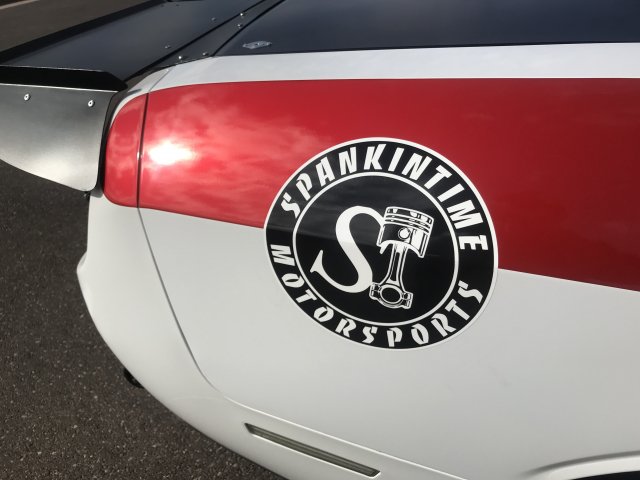

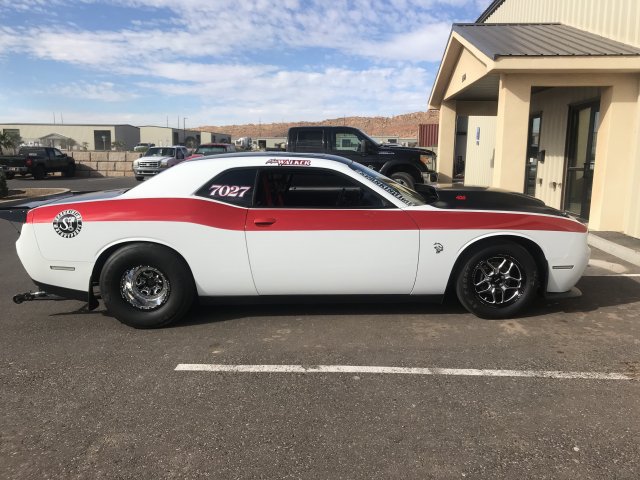

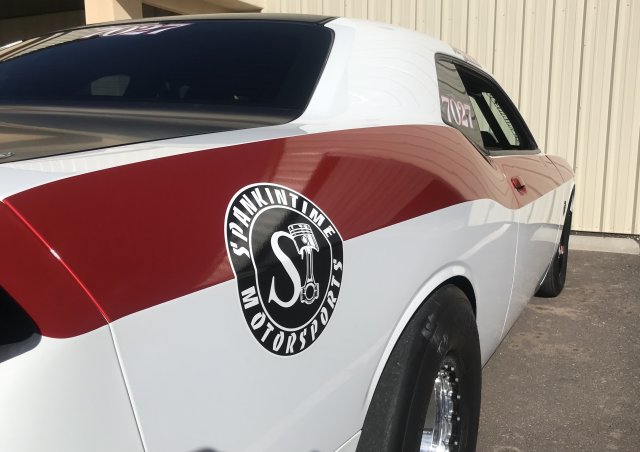

The new Stinkeye 😎 9B136C19-513C-451F-A0E0-67DFBF7DB26A.jpeg A64BF920-1115-4368-979C-60DB555E81C7.jpeg 9C5E47FE-FCBD-42FC-9E75-F2FB9AA9F347.jpeg 5E99BCA6-4ED5-47CA-945E-7067E3D40736.jpeg 13CDB19D-91DB-413B-8EB5-1C524FAC2494.jpeg 72F03AA2-79D5-4DF8-9434-D24F690348A8.jpeg

The Utah plate is still STNKEYE

You outgrew Tommy! The paint job is very nice. Not overstated.
3,624
11,682
Thread Starter #1,189
Thanks. Yes that is what happened. I wanted to take the car to another level and he wasn't interested. The Holley EFI setup that replaces all of the OE electronics isn't something that is easy to do. It's actually much more than I imagined. As it happens... the person I'm working with now is one of the few with experience at this level and the shop is only 30 minutes from my house. As you can see.... the work that's been done is beautiful. High hopes for the coming year.

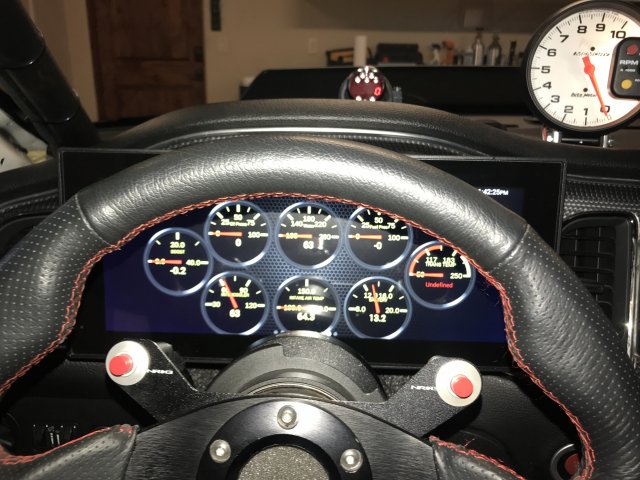

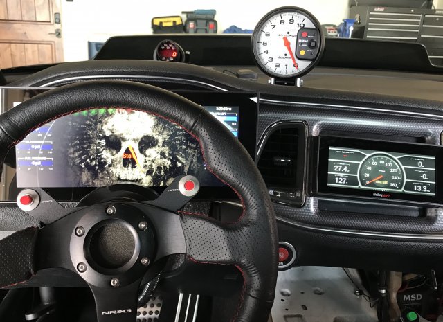

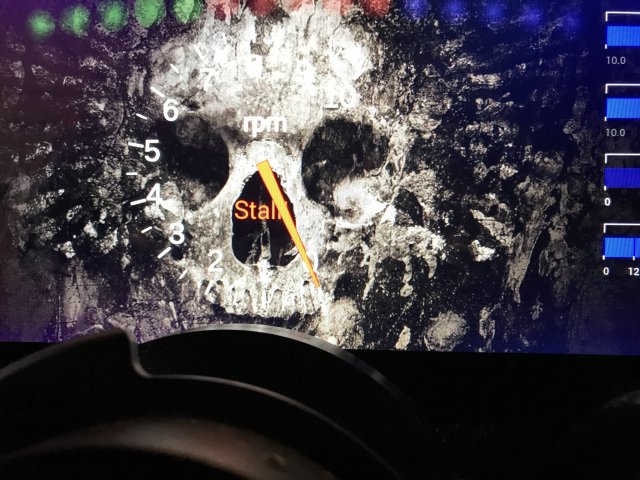

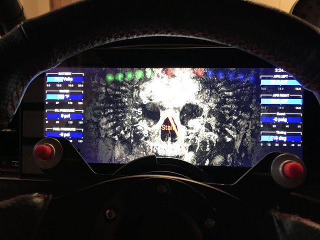

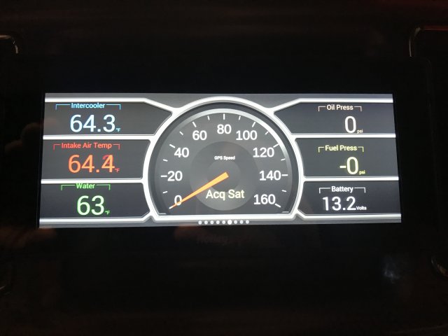

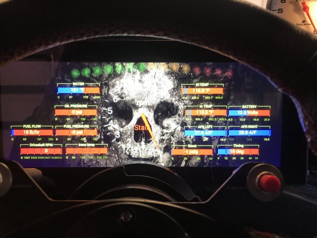

Been fiddling with the digital dash setups. What a hoot! Absolutely amazing what you can do with these things. I originally was going to just use the small 6” screen to display some gauges. Then I saw the big screen on Bryan’s (the blue car) and went… holy smokes! I already had the small one so I ended up with both. That turns out not to be a bad thing. If one of them has a glitch, then I still have a back up with the critical stuff working. While I still have the scary skull screen if I want to just omg people…. Here’s the setup that I’ll end up using. Everything right there and visible through the steering wheel without having to move. The speedo in the center display is GPS and it will be fun to do a GoPro video of that on a pass. Ever watch a speedo go from 0 to 170 mph in 7 seconds? Me either 😂 470843D5-0DB5-4027-99BF-46DF7C85905C.jpeg 8F1D5300-0815-4282-B94E-ACDFCA0D88DC.jpeg 069D6A96-BED4-4086-8D4C-A19B3787DD40.jpeg 025AAE47-D66D-40A3-B508-7A4840A93D1F.jpeg

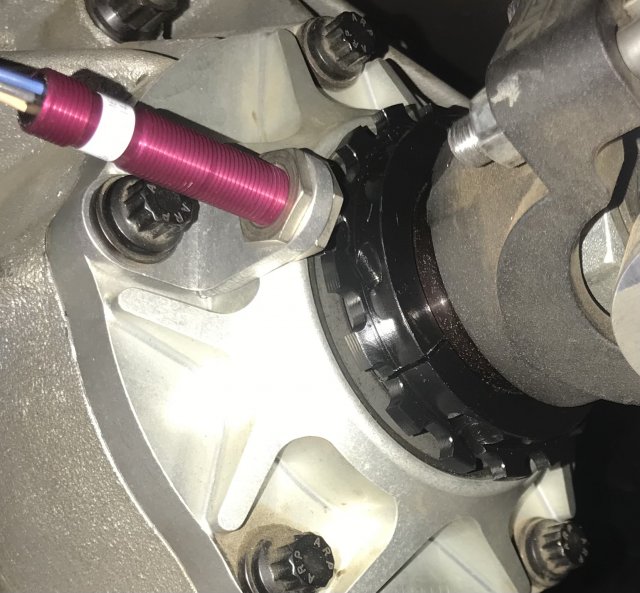

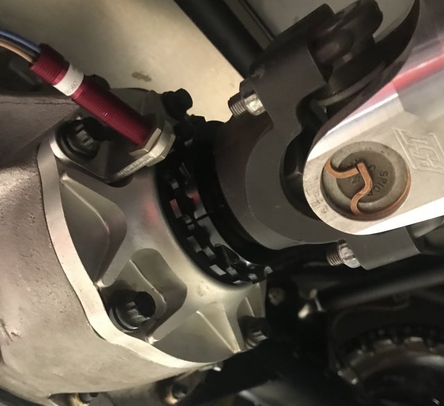

Who can guess 🤔. F4F479CC-B964-4253-80BB-36D07942CC20.jpeg 7D2E2654-EDE8-4D3F-8365-CCB5F934222D.jpeg

Haha. I’ll give you all some time. I’ll will give you a hint…. It has wires coming out 😜

3 wire hall effect sensor same as crank sensor sensing speed off pinion shaft.
You got it 🙂. Driveshaft speed tells the ECU how fast the wheels are spinning in relation to how fast the car is moving so it can manage traction control. Acceleration will be monitored by a G-meter sensor.
