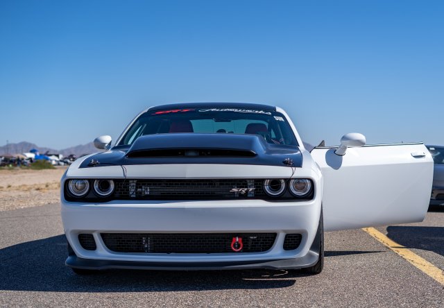

Beeeautiful!
11,025
2,695
3,630
11,710
Thread Starter #114
That's like poster quality photo material. Nice! Oh btw your missing 2 exhaust pipes. Lol
Yeah. He forgot to photoshop those back in there.

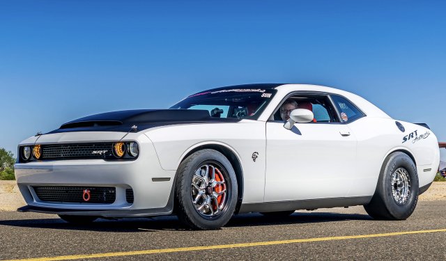

Thread Starter #116

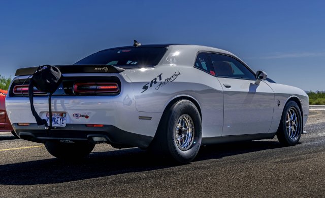

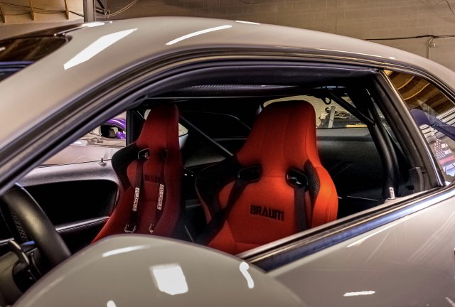

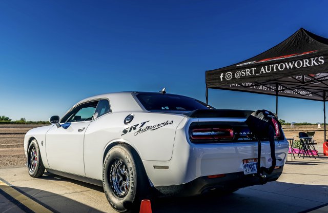

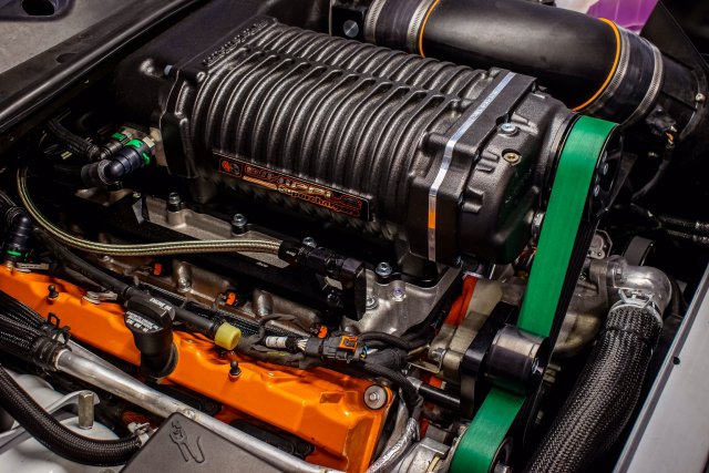

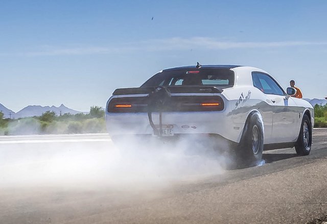

Ok Ok Ok. One more set. The pro pictures are coming in from the weekend and they’re too good not to share. From here on out we’ll keep it performance related. C9BDE660-1471-40AC-A0BA-9A2DAB151B92.jpeg 35499A6A-6D26-4195-BB97-A6F86E140B7D.jpeg 9701926D-1638-4484-826F-3BC5259D5B64.jpeg 2EAABCC5-B1DD-4F30-9E89-C40B8C4899FE.jpeg 9A5A1BB9-D159-4576-8402-3469BE163F29.jpeg
