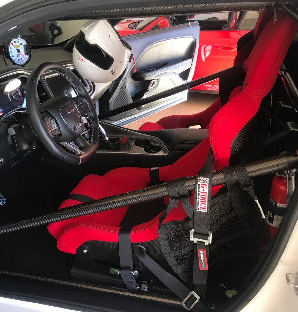

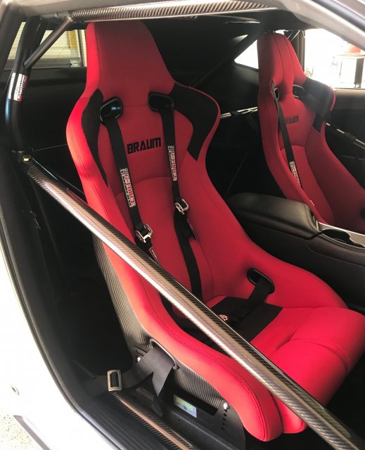

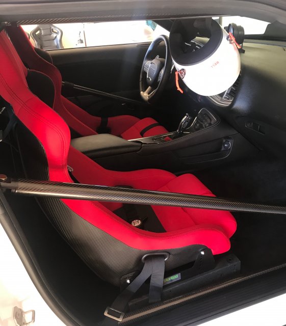

Some new interior shots for today. I love these seats! At 23 lbs each I can just leave both in for racing and not pay a weight penalty for being lazy IMG_9220.jpg IMG_9222.jpg IMG_9224.jpg IMG_9225.jpg

Looks sharp/clean. If you are going to keep your 8 speed for a while for giggles maybe leave it in drive for that 6200 rpm shift. You just never know.

Thanks Linda. You didn’t remember wrong. The seats before were the black leather “street” version of these. They were adjustable. I changed to a one piece seat for safety at the more serious speeds. These are super comfortable and fit like a glove.
