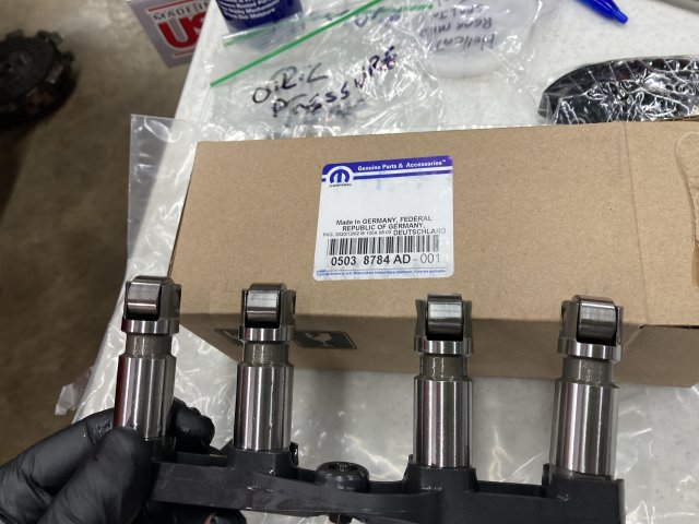

Thread Starter #222

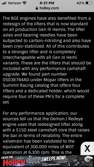

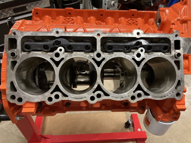

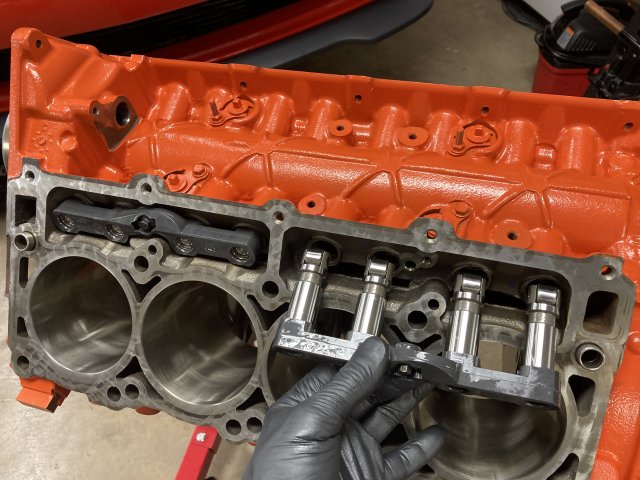

Add new Demon/RE spec roller lifters, the latest version supposedly has cryo treated rollers and needle bearings.
812EB005-C080-4237-9667-C7A8B734E563.jpeg F4D7F6D2-5EE7-47AB-891E-5BC6690C5419.jpeg 484B9D6F-BA53-4439-AA01-E34E7BE56AC9.jpeg D91A85EA-284D-4E8D-B9C1-10DEE3E6DD51.png

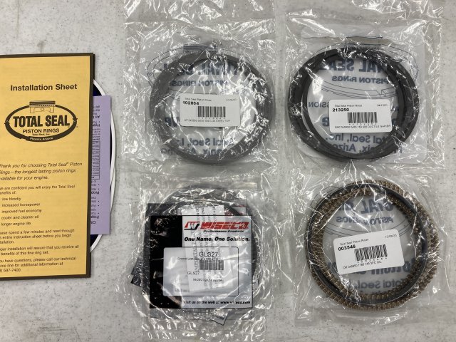

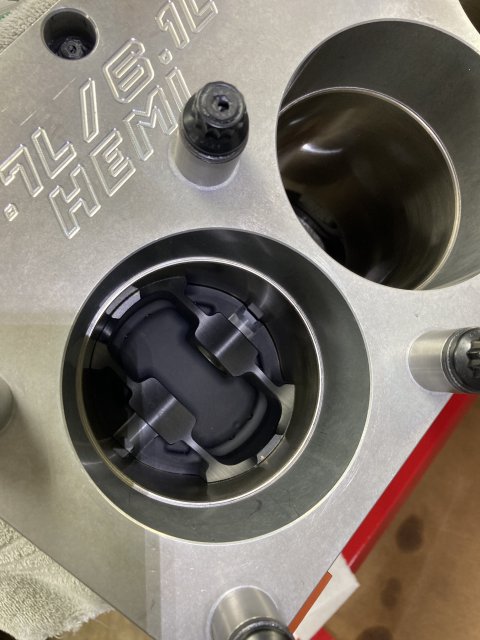

Thread Starter #223

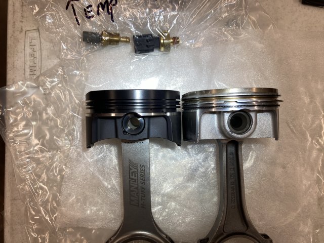

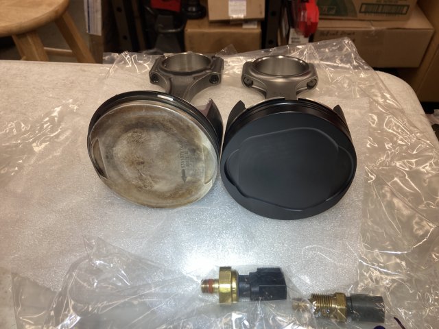

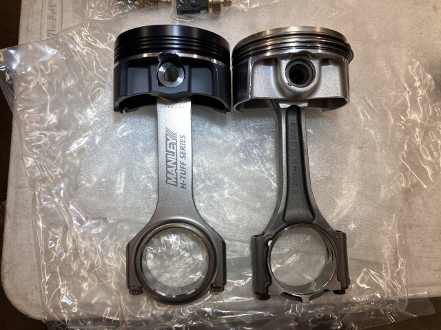

Start thinking about sizing rings. Here’s the new WISECO custom piston mated with a Trend H13 .250 wall DLC pin to a Manley H-Tuff 4130 rod compared to a stock piston and rod combo. B0406255-5AA3-42C0-91C3-A5DAEA7AC61F.jpeg 0E3A34DE-3A55-485E-8C44-34139F00B120.jpeg D92C712F-AD39-4881-934E-6247DF338D15.jpeg

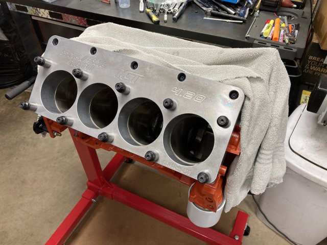

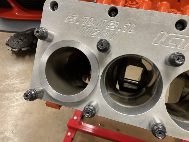

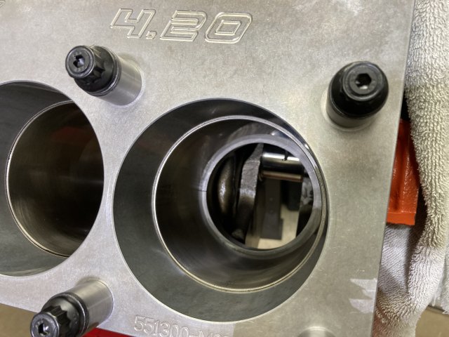

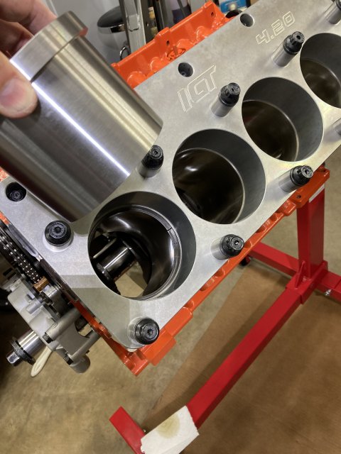

Thread Starter #224

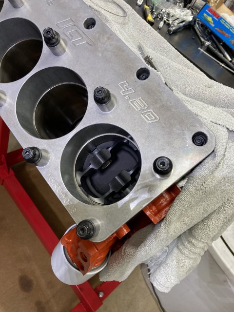

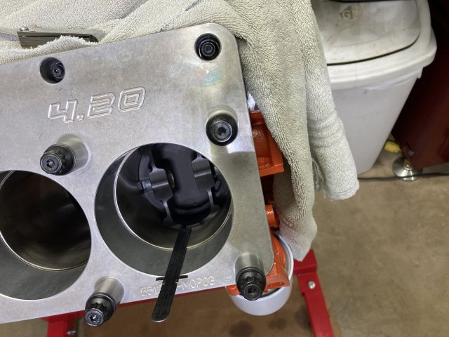

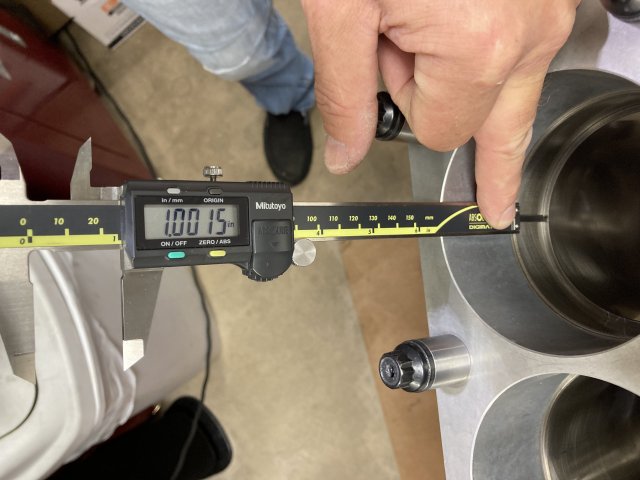

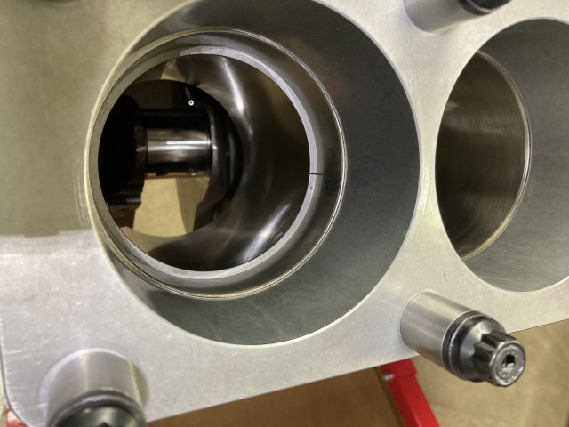

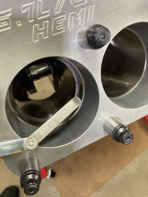

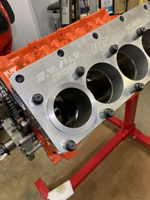

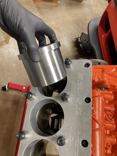

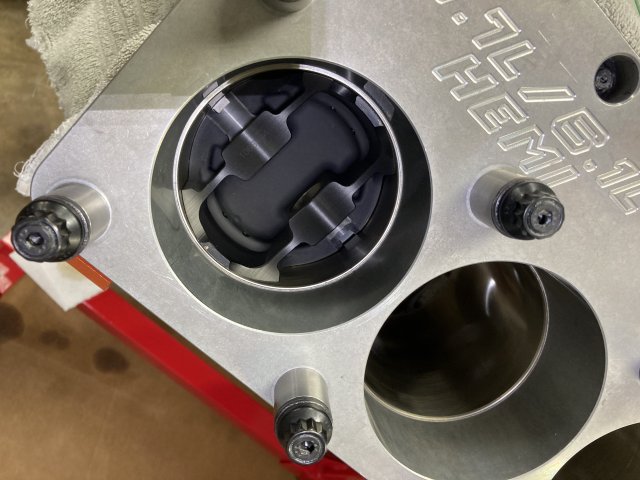

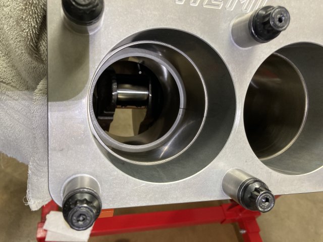

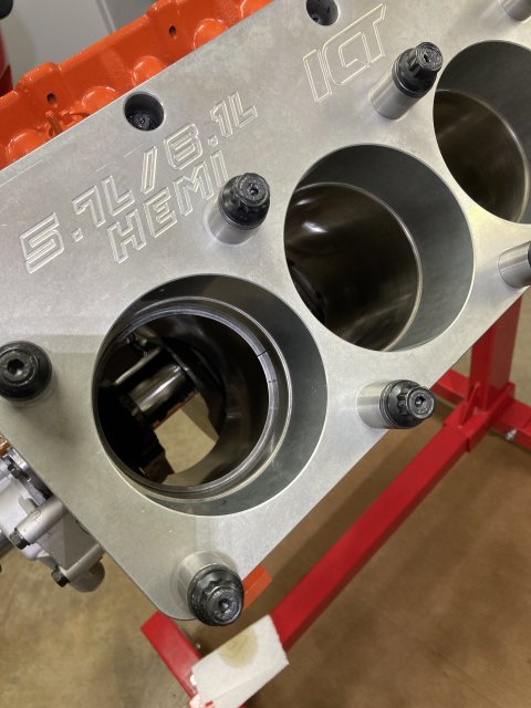

Add Torque Plate, THANKS @Hpindy so rings can be sized in bores just as they where when torque plate plateau honed to 4.0925 bore. Made a custom ring squaring tool so with tq plate installed the rings can be perfectly squared in the bores 1”down from the deck as Total Seal wants for them to be sized to .028” gap on both top and second rings. E380BFA7-F44D-4DCD-A971-26F7D0458AE0.jpeg B9C0C278-CA1A-4546-BFE7-50B7E49B52E1.jpeg 0D92A147-A464-4B09-B8AB-13A3001615E6.jpeg D8F8643A-A09D-4233-8CF7-C5AE50C84CB0.jpeg

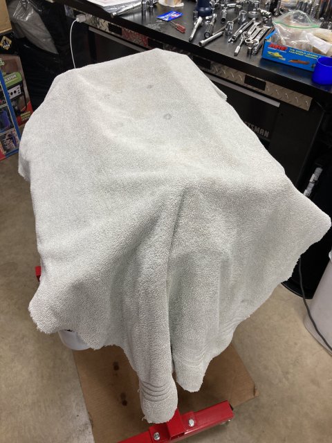

Thread Starter #226

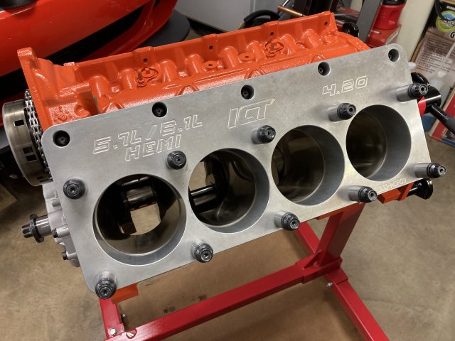

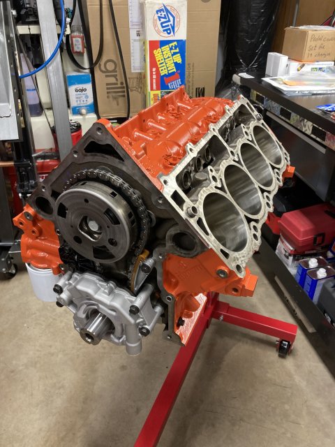

Been a long day, time for block to get some rest and hopefully start sizing rings in the morning. There’s 5 per cylinder (top, second, oil ring top and bottom, oil ring groove support ring) to do, 40 total so this process is going to take a while.
777A1B75-179C-4D9A-94F3-F4BAA70E5422.jpeg 30D78251-C94A-4CCE-B7A6-C040C333D8D6.jpeg
Stay tuned for part 2 LOL!!

Add Torque Plate, THANKS @Hpindy so rings can be sized in bores just as they where when torque plate plateau honed to 4.0925 bore. Made a custom ring squaring tool so with tq plate installed the rings can be perfectly squared in the bores 1”down from the deck as Total Seal wants for them to be sized to .028” gap on both top and second rings. View attachment 45562 View attachment 45563 View attachment 45564 View attachment 45565

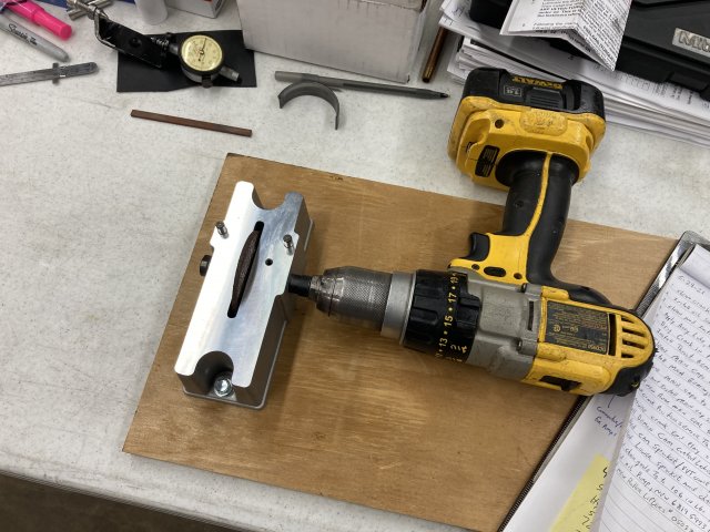

Thread Starter #229

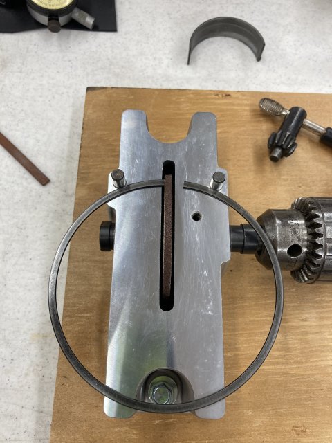

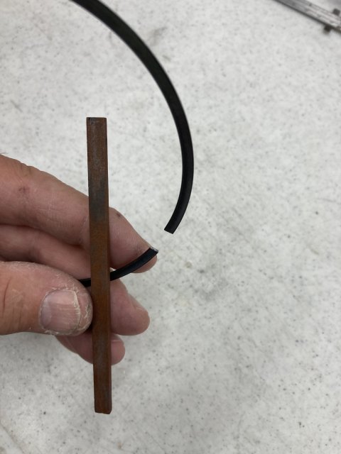

First thing to do, make this cheapo ring filer easier to use!! This makes hands free control GREAT and controllable!! Tested on a old ring first, works GREAT!!

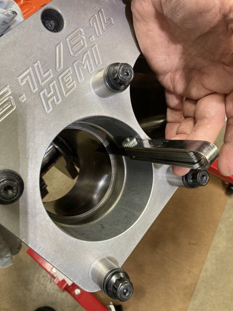

Thread Starter #230
SWEET!! .028” first shot!! Now if only the rest go this easy!!! 🤞🙏
Grind only one side and Be sure to stone burrs off the filed end AF9C1C4F-8959-43F5-A744-13A8E01CD7E8.jpeg 0BA3C46A-2256-401C-ABF0-80707487721B.jpeg 8E10DE29-D7D5-41A7-94BF-34B6F6A27279.jpeg 84EBBF0C-D6AE-4B8F-9D08-6774F2DC0CB1.jpeg C5E5D5A9-DE30-40E8-9DD1-3641C73DFC43.jpeg 77E4D72A-DF15-4993-A91B-ADEDA0A6EED1.jpeg FF281883-B56E-4564-BF75-D284D90A949C.jpeg ED5CDB34-6939-4DB8-A8AD-A6346628F2BA.jpeg 4D28FFA2-F826-4391-A304-0930BBC346BE.jpeg

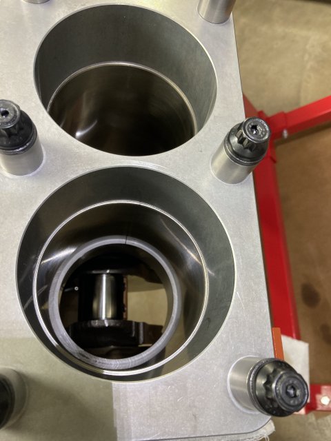

Thread Starter #235

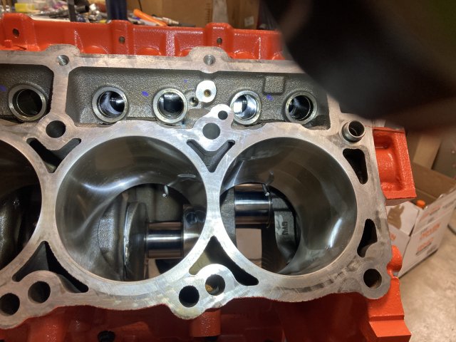

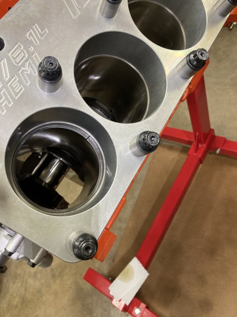

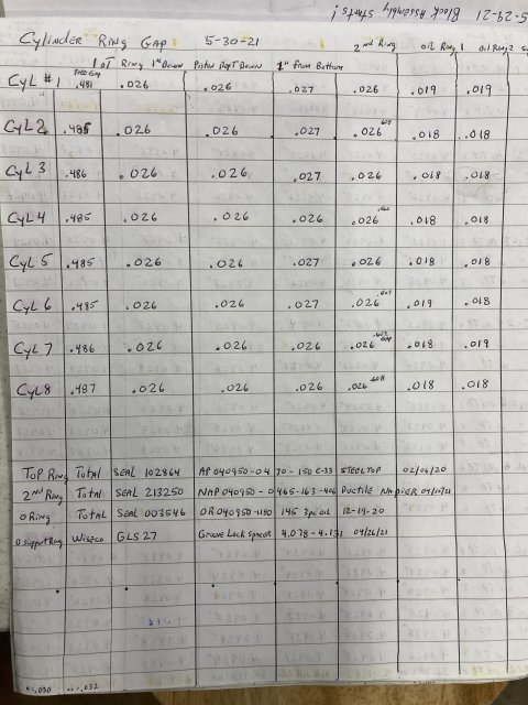

Ok, all the rings are gapped, target was .026” on top and second ring, .018” on the oil rings. I pushed the top ring down to mid cylinder and bottom cylinder and was elated to find gap didn’t change on most and the ones that did was less then a .001” on gap which means less then .0003” on bore which is just what dozens of measurements with a bore gauge told me it was. Torque Plate honing is worth the pain. A16785B9-17C3-4B5B-A7B4-734BEB7639AD.jpeg 04F51493-EA60-4FBC-AD01-591D01FEC0E8.jpeg 6D2F69FF-F479-401A-8B88-F0610AA35E5F.jpeg 67E3A5DD-75C0-4C97-8B08-E381C17705AA.jpeg 3CC53ABA-A6F4-4533-B0D5-75E038C4D9E4.jpeg 877776FE-9B5D-4DB4-9C76-114196E17F10.jpeg B392E074-4F31-4C1F-8AF8-3BF076420F85.jpeg 911BF4FC-D12E-4731-BF88-7C7B3767B7E1.jpeg 4F8A8E92-9F6C-4A19-90DE-5505994631A4.jpeg CCE1D5FF-E6ED-4E28-827F-67B41360D5E9.jpeg

Thread Starter #236
Here’s the numbers, the foot pedal variable speed control of the cheapo ring filer made it work like a pro model!! 55DCD0C4-7196-451A-9685-109A0FDE51B2.jpeg [

Ok, all the rings are gapped, target was .026” on top and second ring, .018” on the oil rings. I pushed the top ring down to mid cylinder and bottom cylinder and was elated to find gap didn’t change on most and the ones that did was less then a .001” on gap which means less then .0003” on bore which is just what dozens of measurements with a bore gauge told me it was. Torque Plate honing is worth the pain. View attachment 45740 View attachment 45741 View attachment 45742 View attachment 45743 View attachment 45744 View attachment 45745 View attachment 45746 View attachment 45747 View attachment 45748 View attachment 45749
