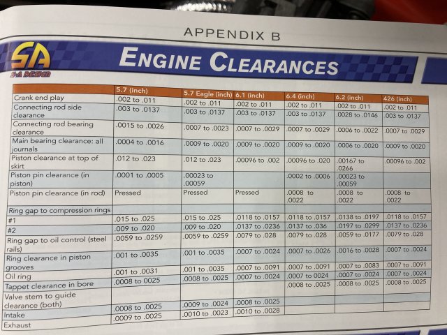

So .026 on new rings what were the stock gap? .022?
This was stock gaps as found was around .019” and also the chart recommended in book is .014 to .020 So this is about .007 more then the as found gap and .012” more then the minimum stock gap. Also there’s .300” of piston above the first ring to help keep them cooler. I figure after break in and the cylinders wear in .0001-.0003 that will open the gap up a thou or 2. Recommended for medium boost 15 to 30 psi on E85 is .007” per inch of bore .0285”. Being that I’ll be around 18 psi max, the low end of the range I used .0065” per inch of bore so .0065” X 4.0925”=00266” gap. So I’m only .0025” tighter then what is recommended for 30 psi of boost, I think I’ll be good. Was going to do .028” first but pondered on it a long while and went with .026” on both first and second rings. The second will get no where near the heat of the first and is a much softer ductile ring so it should always have a hair bigger gap then the top ring.

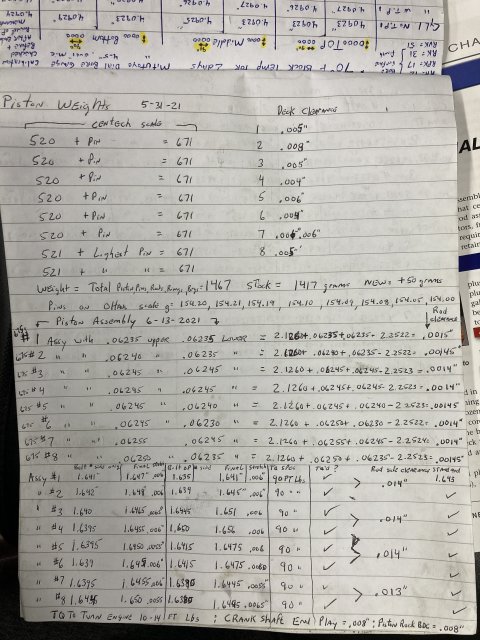

Thread Starter #242

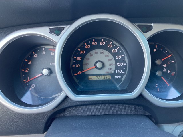

Didn’t get to play much today. Measured piston skirts to check piston to wall clearance, 4.088” 1.300” down from bottom of oil ring groove so right at the recommended.005” of clearance. Weighed pistons there where 2 1/2 gram heavier then the others so weighed the pins and put the 2 lightest pins in the heaviest pistons and weighed them with weigh matched pins and all 8 hit the scale at 671 grams with pins. After that it was chores all day getting ready for beach trip to Edisto with the grand daughters!!! Can’t wait!! Washed my and cleaned my 4Runner for the first time this year, changed all 4 O2 sensors and installed just cleaned injectors and changed the oil, vacuumed, windows, hosed down the under body and frame rails. Was a busy day. Not bad looking for 18 years old daily driver in the snow and crap 55 interstate miles a day round trip to work for 226,000 miles now. Needs waxed, hasn’t seen a coat in over a year, still going strong, 4Runners rock!!

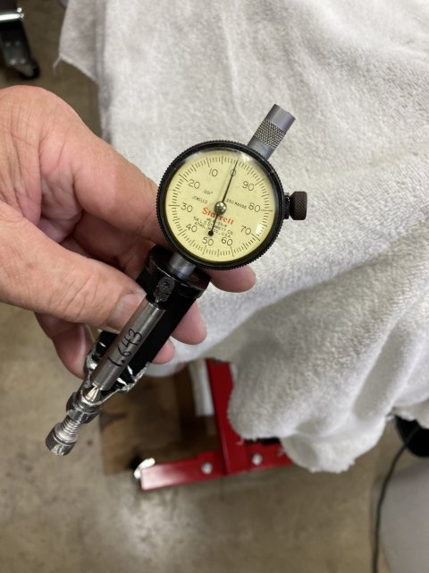

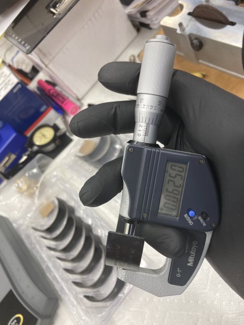

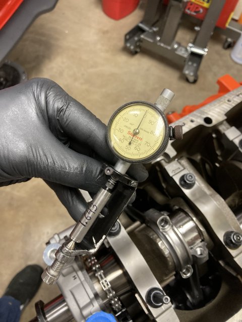

Rod Bearings finally arrived, been on order for 3 months. King pMax Black ceramic polymer coated bearings. They are advertised at being .06250” thick, King prides themselves on their tolerances, all 16 measure .06250” thick!! This will put my Rod clearance right at .0013”, right where I wanted it. Hats off to King, Now as long as they work and hold up as good as they look and measure LOL Now to get vacation over with and back to business LOL 176F7020-25CA-4607-9425-11D8584B122B.jpeg 252926B3-4002-4084-9E70-D02731CE8FEB.jpeg

Do your mics have a round anvil or did you use a gauge pin offset?
3,679
8,687
Thread Starter #249
.2000” Ball end on the Mic of course!!
I've got an old pair of .0001" analog mics with a ball end, but my good Mitutoyo QuantuMike with .00005" are all square jaws.
(An aside, the QuantuMike series are the "fast" pitch thread version. I'm not a fan... Just my preference I guess)

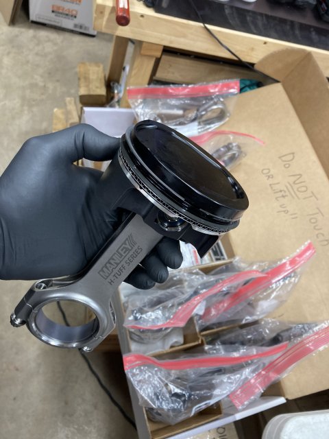

Ok, vacations over, back to business, and unfortunately back to work tomorrow :(

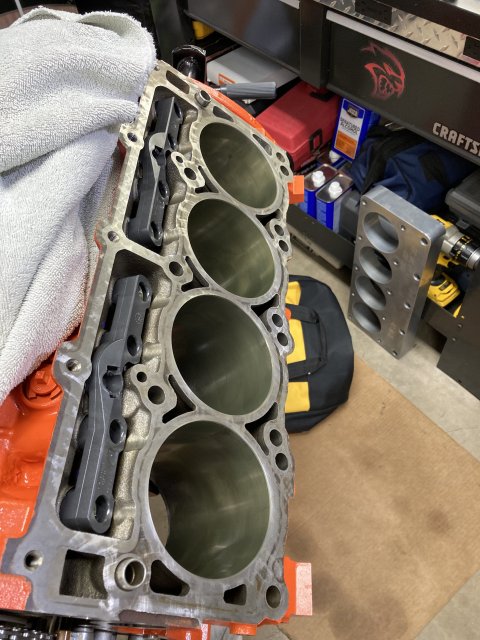

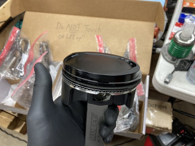

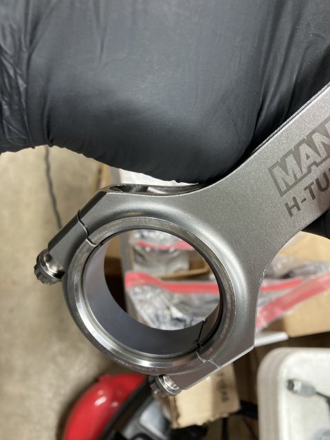

Today I got the pistons cleaned and inspected and assembled onto the rods. Rings and bearings installed, ready to go into the holes.
DE8DE655-0167-42E1-9842-B1271C1540E0.jpeg F9B8E150-73C9-4CCC-A6CF-31ED569F11C0.jpeg ADE349F5-C257-4FB3-B0C1-BCAC3E18EAEF.jpeg 6D764C12-E0C9-46F0-AE08-3CD59978A2D9.jpeg 981EC303-669C-46B4-B281-8617E8E553B0.jpeg
3,679
8,687
Thread Starter #255

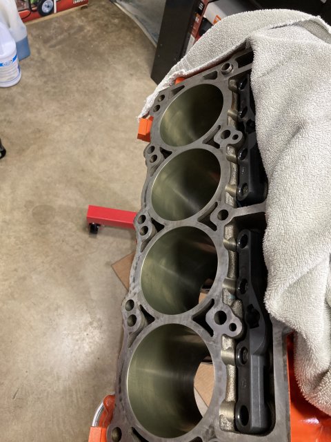

E33EA64E-4ED8-49A9-A02B-7B27B04E6957.jpeg DBB2912F-3E91-40C0-A7FA-780D9DC98211.jpeg Bores coated in Total Seal Quick Seat, will also lube rings with Total Seal’s piston assembly lube, rings should seat quick and tight. The Quick Seat turns the bores green if they are totally clean, it’s ready for pistons.
AB70BCA0-063C-4939-9186-5BB52262D35B.jpeg 80924430-4F95-41F3-9356-F00E2667B4A9.jpeg 076C42E4-3FF9-4A23-9206-604C5AC038F3.jpeg

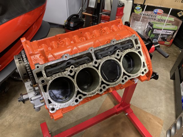

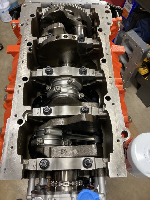

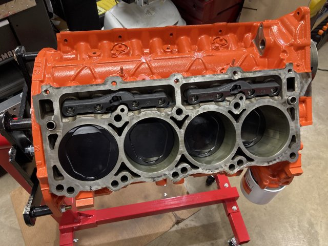

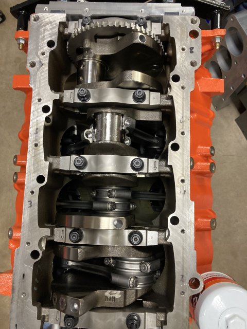

Houston we have a short block!!
15C698C9-1D72-4494-B307-9A5A8E9B1272.jpeg DF4DBF87-AF0C-4880-9BB1-00F193466CB0.jpeg 5955378B-0CC7-41C4-8D97-9DCE597F3F94.jpeg
Time for bed, 445 am comes around waaayyy to quick :(

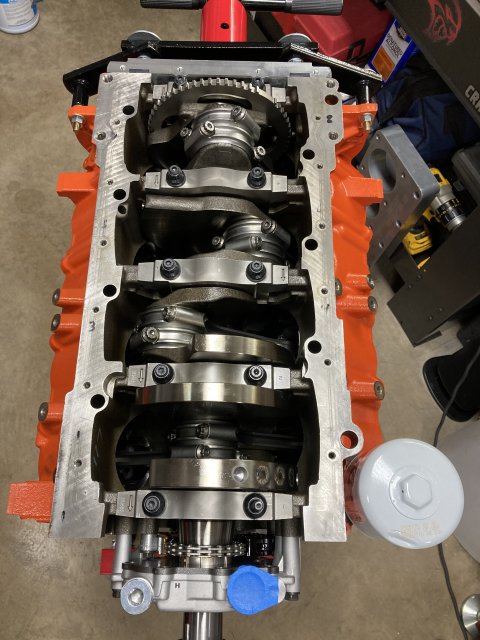

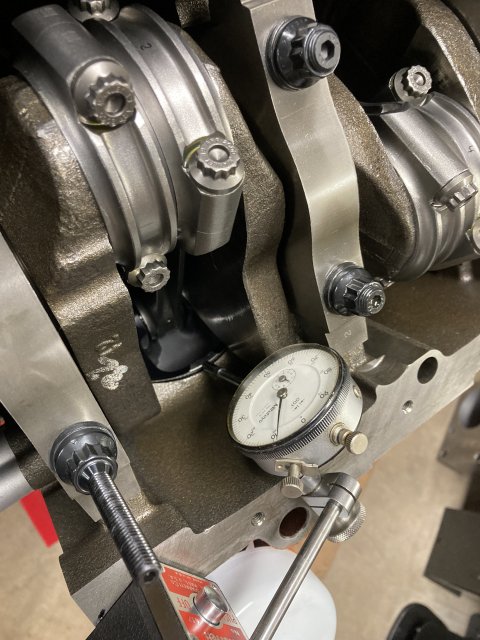

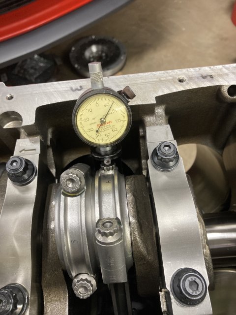

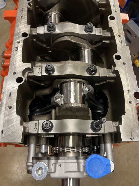

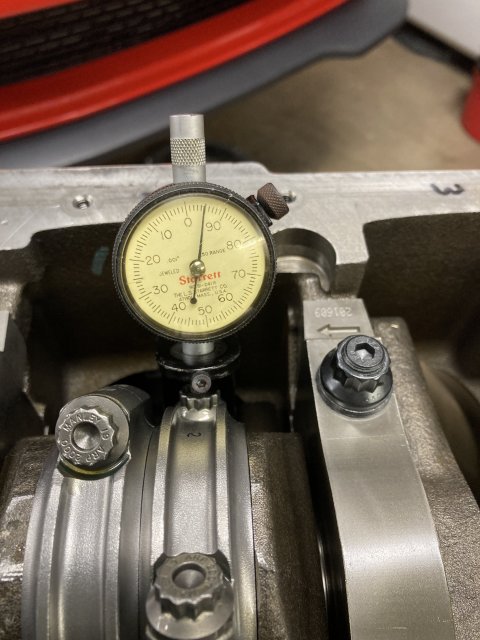

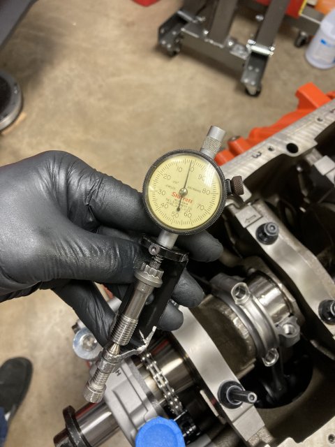

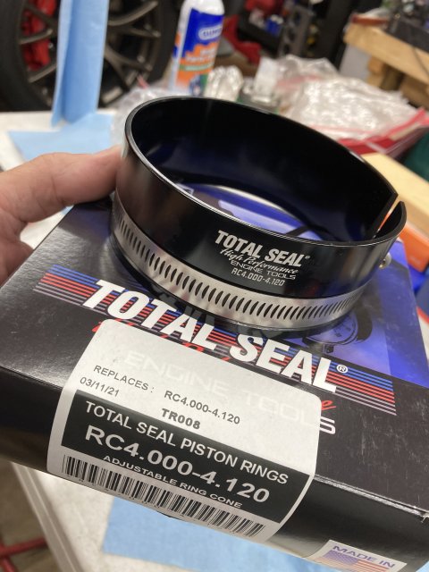

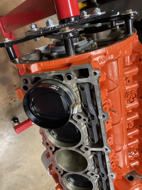

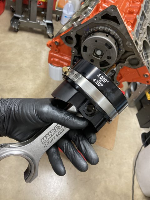

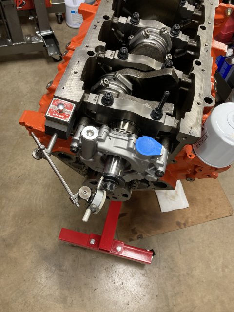

So here’s last nights doings. Recheck each and every piston to be sure rings are right side up and gaps in proper places, locks in place, rod orientation correct, install in Total Seal ring compressor set to 4.090” ID. BTW I HIGHLY recommend this ring compressor, worked EXCELLENT!!

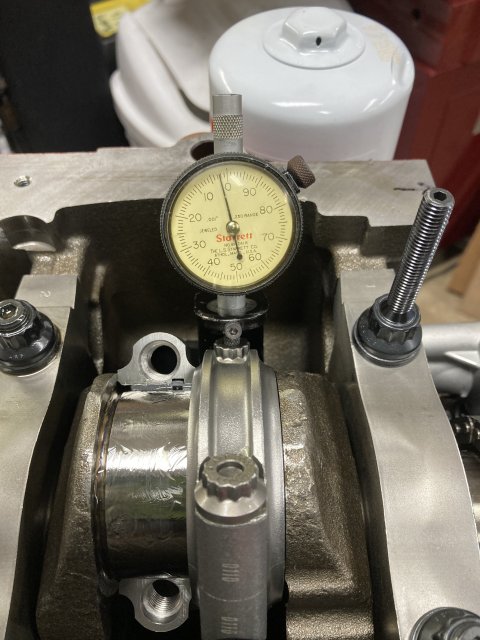

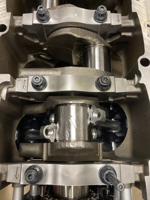

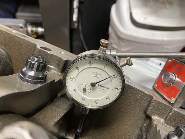

Install 2 piston assemblies, lube bearings snd journals with Driven Assembly Gel, measure and record length of each rod bolt, put cap in place, Tq to 40 ft lbs then 90, measure stretch on each rod bolt to insure its between the .005-.006” stretch wanted by Manley. Verify stretch gauge I made from a desk lamp clamp after every rod to calibration standard I made. F2F3AF15-85D5-4A97-AD27-97F182DF5EF9.jpeg 2C6EA5A1-79A7-4772-BBB2-56263EE69133.jpeg AC440711-5484-49F5-95C2-3E2D459FF422.jpeg FE76C4B8-2D88-4D8D-B214-EC515EE7833C.jpeg 11FCDB0E-8EE8-4402-9407-D5C8DF673576.jpeg A91627F9-ABED-4729-AEBE-32891EF91644.jpeg 0E833EAC-82A0-4A67-A6AD-51057B1F135F.jpeg 755D35AE-DD86-4E20-A911-C3DC1B490E98.jpeg B0DCFE4E-62C3-4BCA-A8A6-E84EE4E3760A.jpeg 74647730-6AB6-48C3-8ED3-43F90F4652D1.jpeg B224EE26-CC64-438C-AE19-CBB806E635ED.jpeg 555A6D4C-6F9D-4C0B-8B02-42A1256B595E.jpeg 60CBE1F9-C047-405F-8C6A-8FDE094EF400.jpeg 4A0BFD8D-C590-4E2C-8544-C1E089E007C4.jpeg E968A594-0B62-4CD4-AD73-D2D51E3A0C60.jpeg 99F9550C-F38C-429D-9C36-85E9C1A71B4B.jpeg 022FB70A-9CB4-4165-8749-D761B6220779.jpeg 97AAABF2-FA2C-4621-904A-4F17F5681188.jpeg 595045A8-040F-4496-B93C-501786259C2E.jpeg 03B2A81E-9882-4673-9A44-1EAB18044FD5.jpeg 26E310C1-2921-4505-AD8C-C9B9BB9E4384.jpeg

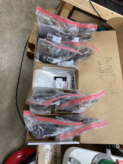

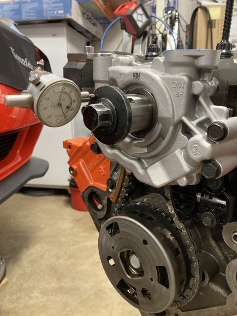

Check clearance between each rod set main journals, ensure oil squirters are not hitting pistons. Measure crank end play before and after all pistons are installed, measure piston rock BDC, measure Piston deck height clearance. All passed. Next step change springs, retainers, and locks in the heads to a higher RPM capable Comp Cams .630” lift kit.
