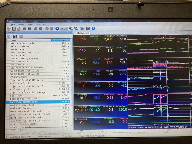

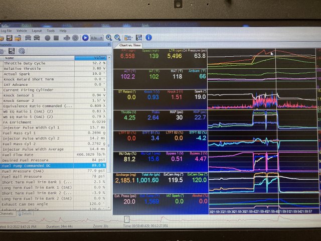

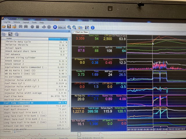

53190677-D101-405D-A9BE-D7B542BB4AEB.jpeg 431927CE-612D-4FE0-9A67-6F501F60032F.jpeg 43177E5E-0A77-41F0-AAA6-F217B2E278C0.jpeg

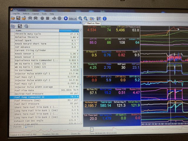

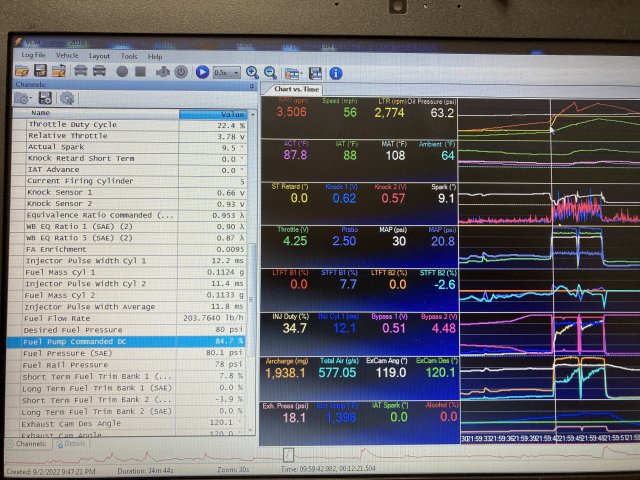

I see commanded fuel pressure appears to be bumped a tick. That can work, but also reduces flow so it's a give and take. The pumps are maxed at 89% DC but INJ DC isn't maxed out but close. INJ PW hits 16ms. In a factory tune the bypass will start to open when PW hits 13.7 above 6200 RPM.
Bottom line, you're close but as long as DC stays below 85% and your commanded EQ ratio stays around .81 for E85 I'd just monitor. Cooler air may put you over the limit. You've got some pulley options you could swap to quickly in cool air like a 3.125 or 3.250 which is a lot cheaper/easier than fuel system and injector changes.
Agree 100% on all points.

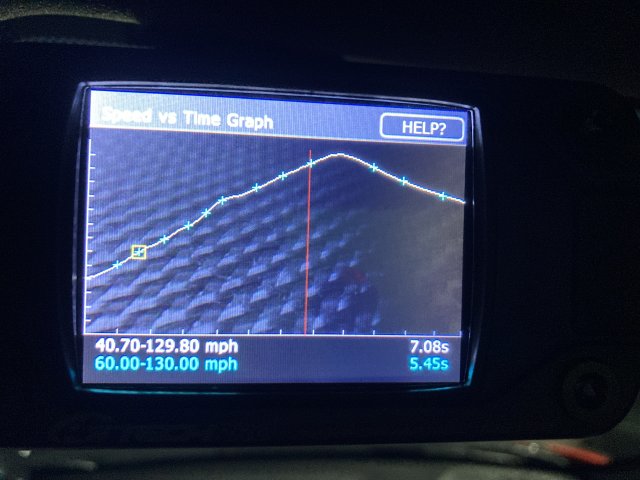

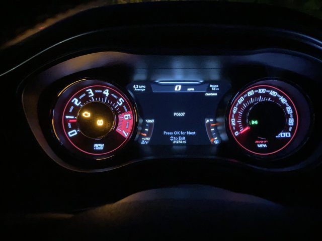

Well MUCH THANKS to @jonx96 last night for finding and fixing a issue in my tune that would throw the car into limp mode at light throttle and generate a P0607 code that even google searching and Whipple tech support could not fix. GOOD JOB JON!! Netted another person best 60-130 last night, getting closer to the 4’s now!! :)
F107A8AD-551C-4905-BA44-BDF61AF67401.jpeg AB1255EC-77EB-4FC5-AFA7-0FEF0F36250D.png 97E67F4D-D52C-497B-B002-D92F2A437C57.png 89E52874-FF97-4B92-9336-A94342B895A4.jpeg 3F1EFCF9-D851-4DBF-88A4-D3DF10722EC7.png 4AE45EB8-85A0-4AFF-BAB3-4DF36CFBB214.jpeg

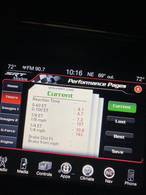

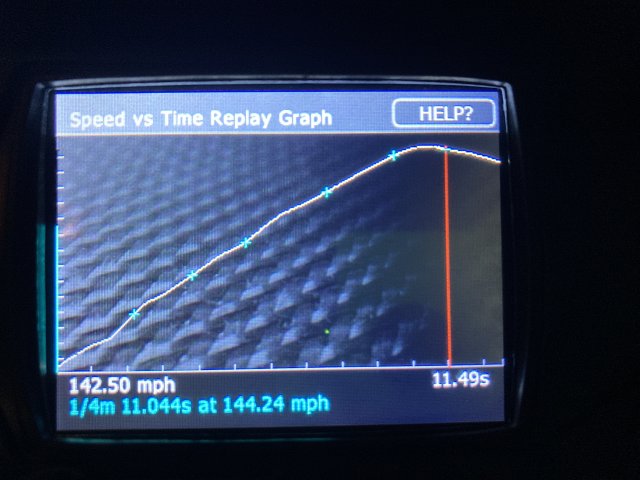

And what else did he do while we were at it last night??? Whipped up a quick launch tune and Got me into the 10’s!!!!!!! It still has allot of tweaking needed as I’m spinning like mad still but a 2.2 60ft on the street still netted a 10 second 1/4 finally!!! YAAAAYYYY!!
Party time!! I’m sure 9’s at the track will be no problem!! Issue now is I’m running out of rpm before the 1/4 completes, see the mph knee over at the top? 1/4 speed could actually be faster as I slowed down before crossing the line. Guess time to up the rpm limiter a bit so I can stretch it out a hair more up top. Or go back to the 3.73 rear but that may slow the cars acceleration in 3rd and 4th, don’t want that!! Unfortunately I ran the battery dead on the Draggy so the 10.8 isn’t on the Draggy, ran my laptop dead so couldn’t try another launch tune Jon concocted quick, the my phone died, and finally I was out of fuel lol 1/4 tank sent me home finally around 11, with a BIG SMILE though!! :)

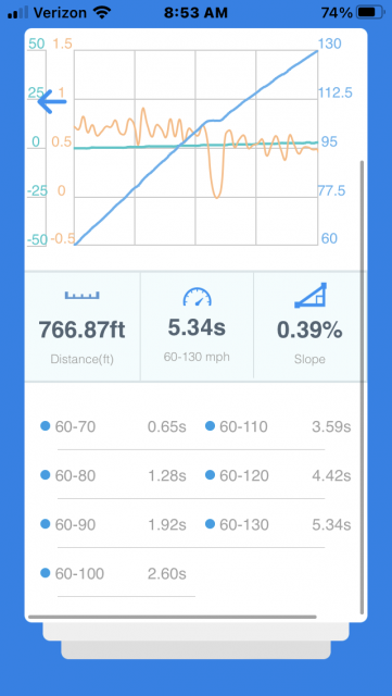

And she’s running pretty clean too, weird fuel seems to keep up a hair better around 1/2 tank??

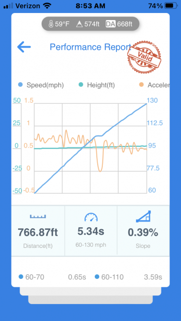

My 60-130 runs are started at around 55 mph, so it’s not a come up on it flying already 60-130 run, I need to try that and see if maybe that nets a 4 second pass!!

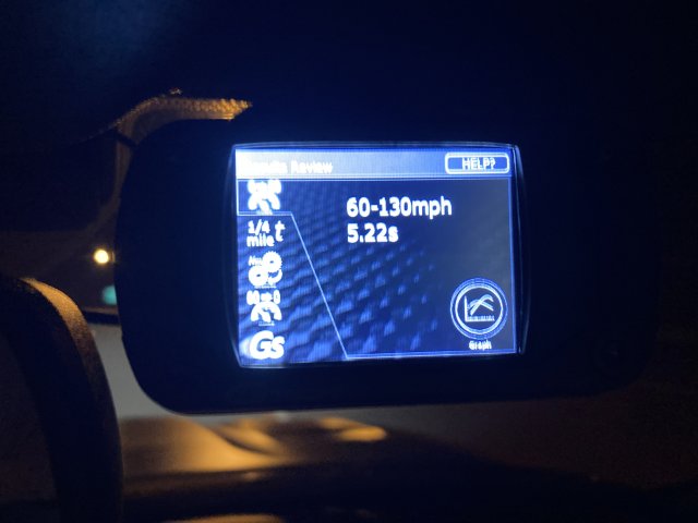

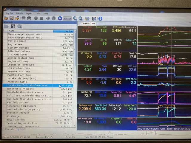

Here in the HP tuners graph can be seen the starting point is around 55, throttle voltage is just hitting max right at 56 mph. Near no STKR even exceeding 23 lbs of boost, look at that 2.70 Pressure Ratio and 2200+ Air Charge!! Remember this is just a RedEye cam on stock un ported cylinder heads with JBA 1 7/8” shorty headers THROUGH CATS and stock exhaust!!
EE139123-D12E-411C-9549-A03515CD58BF.jpeg B4A7488A-92B3-48DC-873B-EB020AFBC915.jpeg 0B46CF2D-18E1-4D9C-AA5A-59665B65D58C.jpeg 8A446FA6-183B-40D6-B5DC-86DB09E70F3A.jpeg 6A8576DA-0D3C-4AE7-B0C8-58B8130BA2E9.jpeg
Notice in graph at bottom 2 more pulls right after the 5.22 60-130 run, they where the 10.8 and 11.05 1/4 runs, no cool down, hot lapping. STKR there in third is a bit of tip in issue but the timing pulled there brought it back down to normal timing path numbers, not worrying me, let’s me know the knock sensors are doing there job and settings are on the cusp of where they should be. I’m HAPPY!!

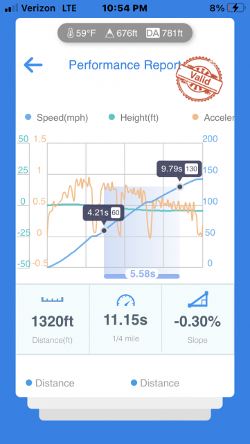

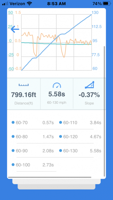

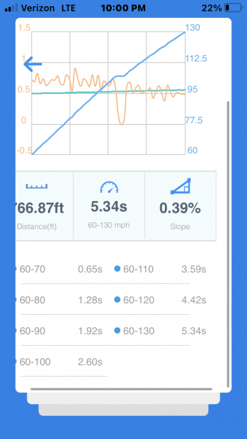

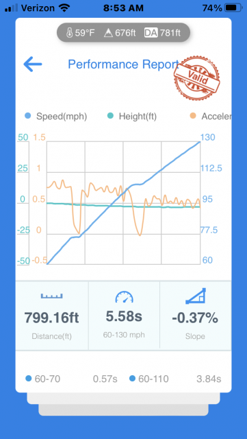

In actuality my 60-130 times are slower 2-3-4 verses just 3-4, that extra shift costs time. It may be quicker in the 60-70 range but the shift 2-3 costs time, see here in a 60-130 snippet from a 1/4 run. But I can start out sooner in third, like 35 mph as she has the torque even from 1500 rpm
In third to start pulling hard by 45-50 to gain some momentum in passing the 60 start mark, but I feel that’s cheating lol.
See the difference in the 60-70 and 60-80 times?
BF011F19-940D-481F-9CC1-A05B1B188EFF.png 3FC0016E-B41A-48A1-B415-1B36F504C1C0.png 376CDDFD-B295-4D53-99AE-04C9C710B8F4.png 7A642F73-8050-4BF5-99D7-687D60CBA4DF.png

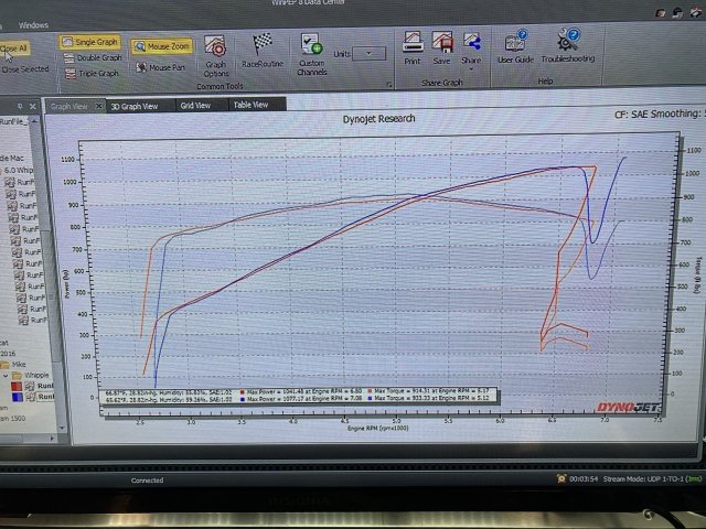

Dyno’d the beast last night. First pull was 1,041 HP 914 Tq, stepped up the timing a small amount here and there and next pull was 1077 Hp 933 Tq which spun on the dyno up top. Left it there and called it a happy day :)
Did a 60-130 hit on the way home, wiggled, shimmied, and spun about the entire way to 130, was a hold on tight white knuckle five and a half seconds lol.
0B4BE825-CF17-483E-82C5-BF43DC073C9C.png F12AA1AE-A1DE-4C43-879B-2699FD821431.jpeg
MUCH THANKS to @jonx96 for excellent tuning and support through this endeavor to get to my goals of 1000+ wheel in any DA, sub 6 second 60-130 runs in any DA, and the hardest a 10 second 1/4 on the street looking totally stock on 20” Brass Monkey rims and 305 Nitto DR’s with no burn out just launch.

Exceeded your goal. Congrats!
4,253
10,584
When I saw the 1041 I was kind of hoping for a 1100 :ROFLMAO: Maybe with out the dyno spin one day
