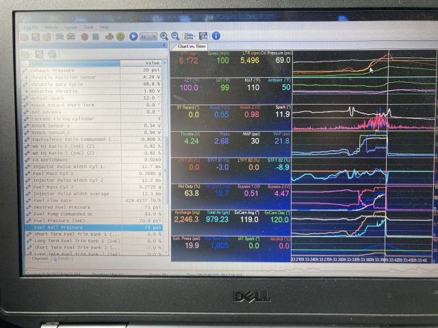

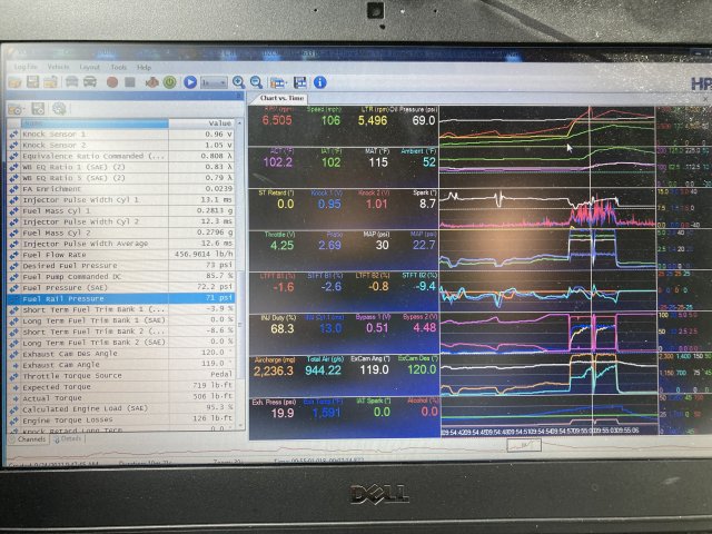

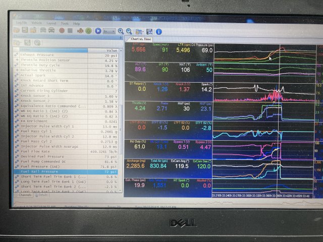

I did some dialing in of the injectors last night, in less than an hour had idle at 0% LTFT and cruise within 3-4 and WOT (one short hit) was +6, then my laptop battery died which sent me home :( I think we’ll have them dialed in before the weekend is out. I have a work related party to go to tonight so no playtime this evening to finish them up. Most I saw injector DC wise was 45% and 12 milliseconds at 5500 rpm, pump DC never topped 79% with a new set point of 78psi at WOT, 56 all other times. Looking good so far. 👍

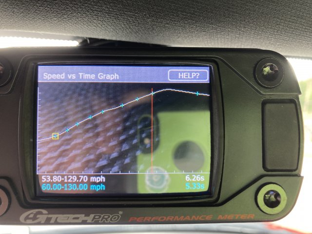

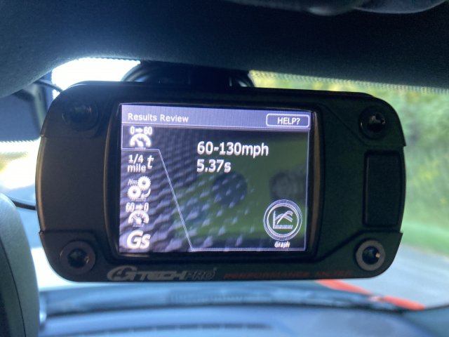

3rd gear pull trims looked good for a 60-130 run do I let her have it. Not bad for 1 hour of street tweaking and a 12 degree max timing safe timing timing table thanks to @jonx96 This engines not a timing hog lol. Back to 19 degrees soon! Draggy battery dead so only Gtech data. Same bridge as usual, no slope, If anything it’s .45° uphill in the direction I ran.

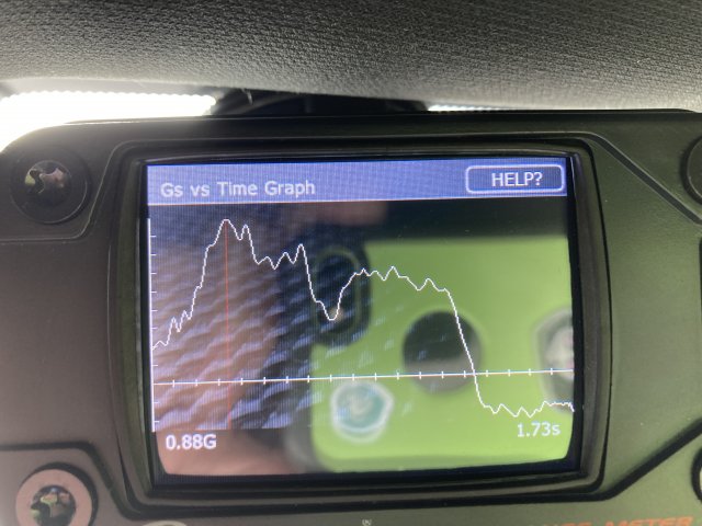

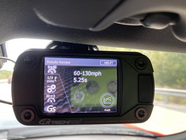

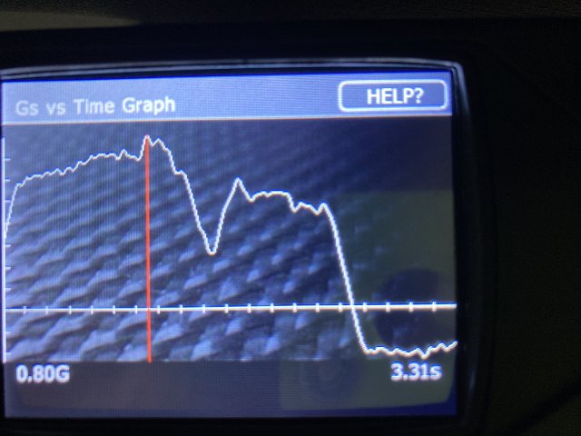

GForce graph of that 5.37 run, shows the declining G Force of the reduced timing up top during the 3rd and 4th gear pulls
8B4FA4BE-3A2B-446A-BA80-B26F2F4B5745.jpeg 93F710D1-53B0-44C1-8FB5-695A3E051CE0.jpeg
Verse a 19 degree up top run
5F5B9675-7CED-4DFA-8280-1DCE62F12ADA.jpeg 792E0173-A3C8-480E-8F85-929E029ED512.jpeg
Less wheel spin from less timing probably netted the better time.

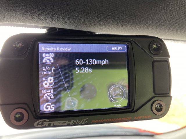

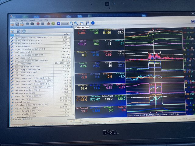

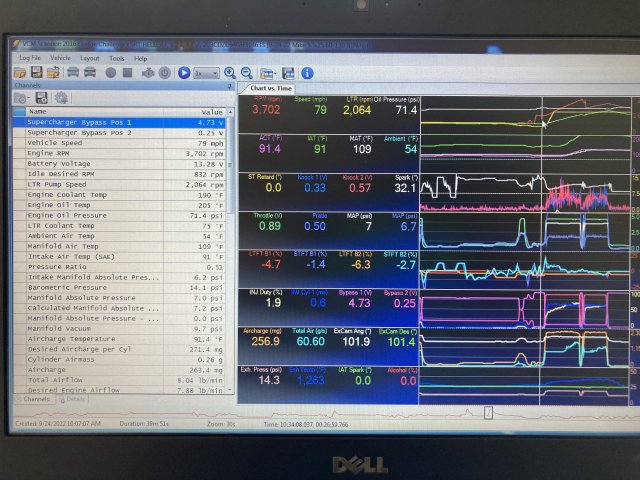

Injectors pretty dialed in now, Still a bit of fine-tuning to do to get them as close to zero as possible but they’re runnable as is. @jonx96 desired fuel curve working well, pump system kept up even on a “extended” run.
