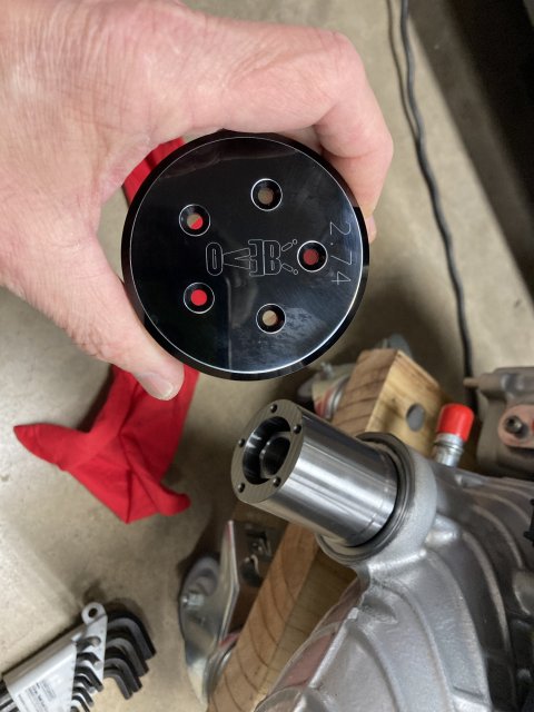

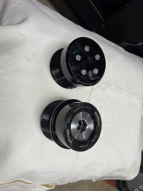

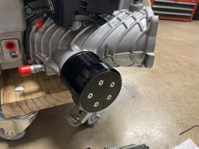

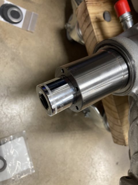

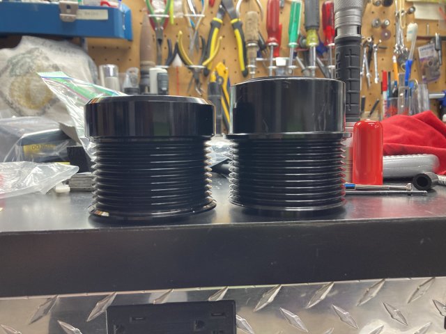

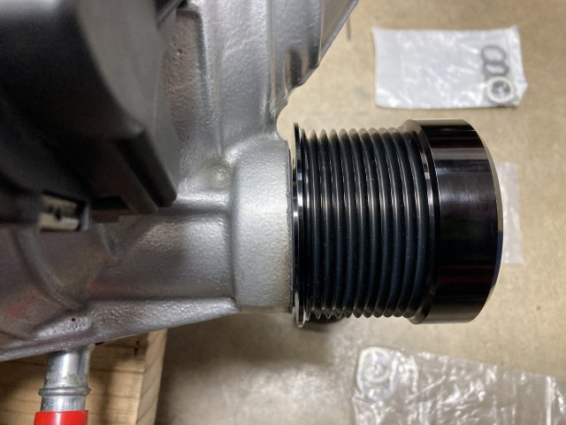

Satera Rings of Hell pulley arrived the other day. NICE piece!! It’s actually lighter and shorter than the Litens. It clutches instantly with about zero drag, in fact if you spin it on the shaft you cannot spin it back off the shaft by the pulley, it clutches instantly and so friction free the ring just spins on the hub and you have to put a socket on the hex to turn it off with your fingers. Give it a flip backwards and the lobes don’t even move!! It’s also a bit shorter which will make getting belts on and off between the stock Tstat housing easier. When my heads return from Thitek (on their way) and it’s back together the 2.4 is going back on instead of the Whipple, mainly to see if this totally free spinning pulley gets rid of the over rev I see between the 3-4 shift. It’s about the same cost as a Litens, except you can change rings easily and quickly, it’s advertised as 5x stronger then the Litens, and best of all comes with a 5 year no questions asked warranty!!
Can’t wait to give it a spin!!!
3A47CEDC-B28E-4A79-92EA-1C36870CED60.jpeg CF2C3D27-0596-4775-956B-CA439012ACD8.jpeg 44A4F225-AC95-4C3C-A769-754EF49F9566.jpeg 2844445B-5608-4DDF-9E9E-F9EAAAFE3649.jpeg 8FA5D628-4851-4B27-A532-BBF154282F90.jpeg 9601007E-3E73-46F7-8290-6EEF4BBD4C24.jpeg 96F5B56F-8DD7-4E71-9D28-042B7240370A.jpeg
View attachment 94240 View attachment 94241 View attachment 94242 View attachment 94243 View attachment 94244 View attachment 94245 View attachment 94246
What's the price? Did I miss it?
