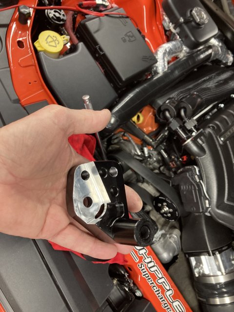

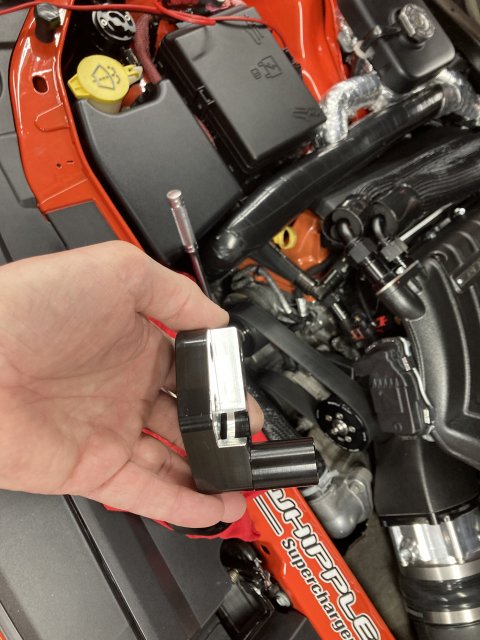

Hopefully my AAD Idler pulley mount modification works and I get it mounted tonight, get some more wrap on the pulley and tension on the belt and get some high rpm fueling and pump data soon.

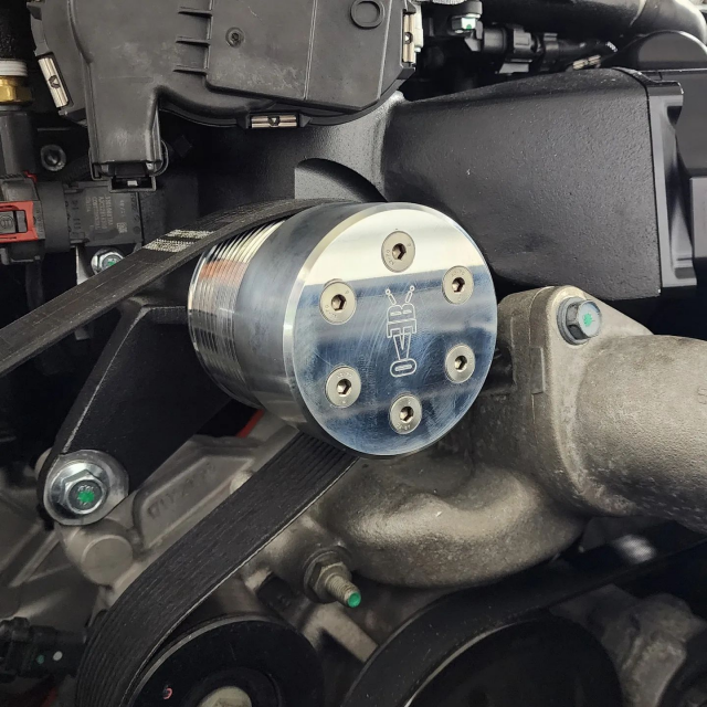

***NEW PRODUCT TEASER***
SaT.Tun / B.Evo are proud to announce...
@whipplesuperchargers Gen5 3.0 / 3.8L CLUTCHED PULLEY
That is right, the prototype is complete.
Our Rings Of Hell Series Gen2 Clutched pulley WITH swappable rings.
Quick Change and Clutched...
We have a few testers lined up, but hoping to release these for full sale very soon!
Sizes will range from 3.0" to 3.75"
Stay tuned!!!

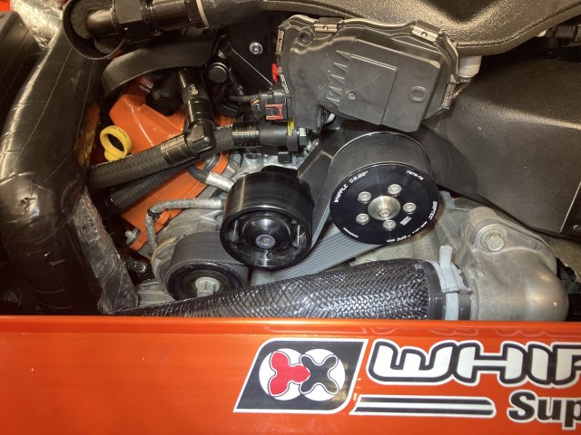

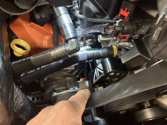

Got the AAD idler to work with the Whipple, hopefully get a test hit in today before it snows again. LOTS or wrap now!!

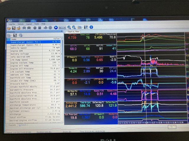

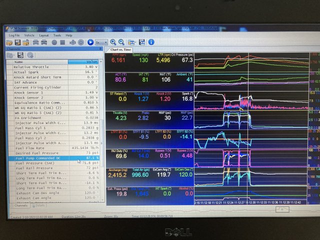

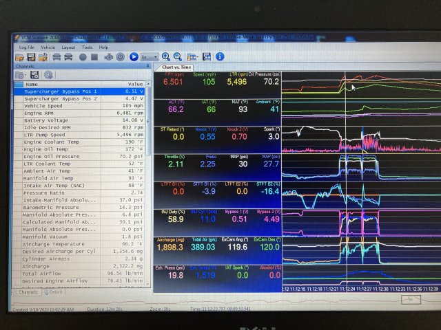

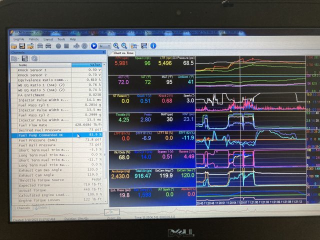

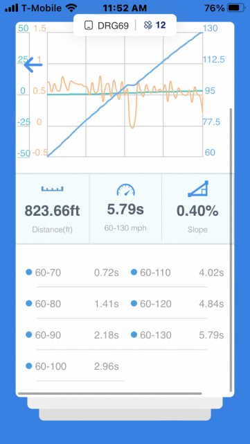

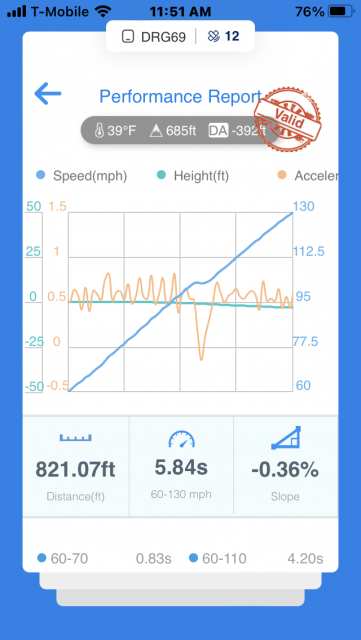

All I can say is FU€KING WOW!! WHAT AN ANIMAL!! Unfortunately 60-130 times of only 5.84 and 5.79 return pass but spinning all the way to 130, was a HAIRY ride and for me to say that is scary lol.
Fuel keeping up to 24 psi and 2430 Aircharge with room to spare. I hit it about right on the mark with my prediction of 65% inj DC, DA was -392 to -492 and 39 F. No more belt slip!!
Looks like I can take some of the fuel back out I added

Major spin at 78 on the first run, pants filling 5 seconds lol
3F779E59-83C8-4592-BF5A-6F10176BDF61.jpeg 6B7280D8-3F69-405A-A781-020BACCFA565.jpeg

This screen shot shows MPH is calculated just by the rear tires not the fronts as see the rpm climb and dip and the mph follow? That’s not a shift, that’s wheel spin in 3rd, shift to 4th occurs at about 105

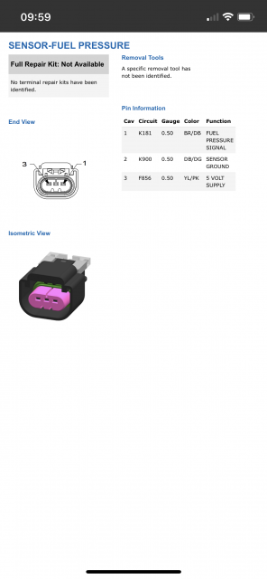

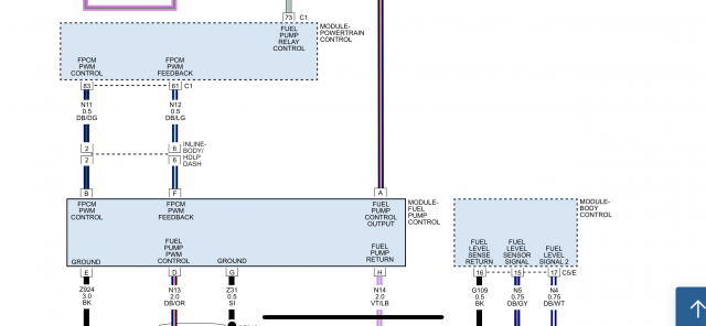

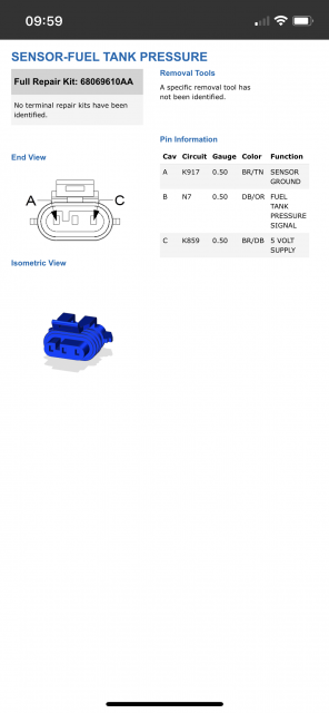

@Speedy! (or anyone else even) Do you have a schematic showing the wiring pin out for the fuel pressure sensors plug? I have a spare harness here and can figure it out but having such without get that harness out and put it out with a meter, etc. will get me to testing the sensors all the quicker if someone can supply me a schematic please. I have a test rig figure it out already. I just need to know how to hook it up to a meter to chart record it voltage versus pressure applied. Both sensors will be hooked up to the same pressure supply and and a chart recording voltage meter on the output of each sensor to plot what one gives out versus what the other gives out at the same pressure at the same time, ie a totally valid and real time comparison of one to the other, from 0 psi to 110 psi.

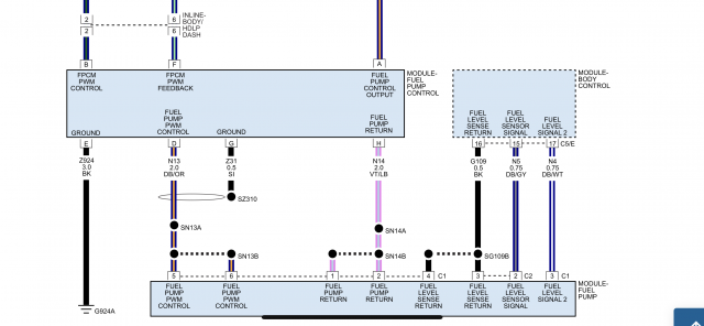

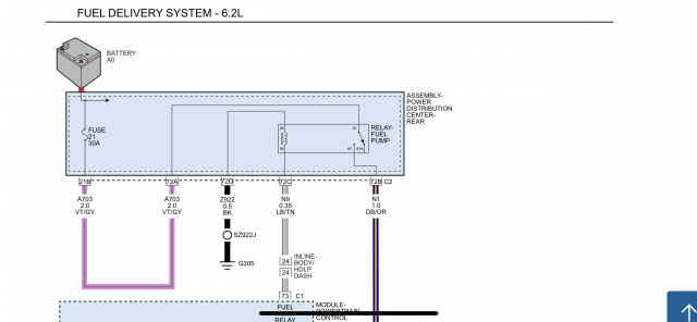

Have a wiring diagram for 2015
2BCC5364-6589-4E0C-9BF3-0C47B660850A.png FDED4B25-90C7-4748-BFD3-0718D6284DDD.png D593DC9D-0F0B-48B4-A69A-E087FA733875.png
http://connectors.dcctools.com/details.htm?id=196430&print=1
http://connectors.dcctools.com/details.htm?id=196506&print=1

Nice!! Exactly what is needed but I need it on fuel pressure sensor itself.
