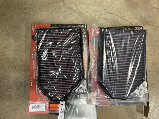

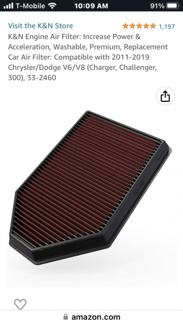

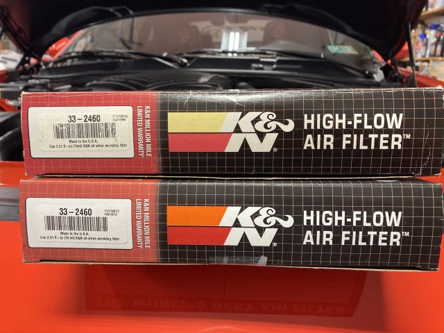

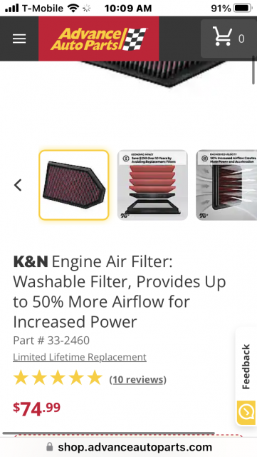

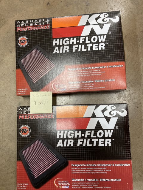

K&N filters for sale in the for sale section,$120 for both shipped.
