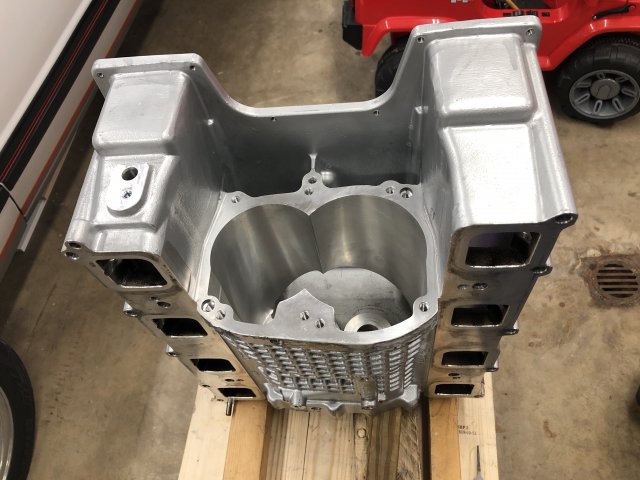

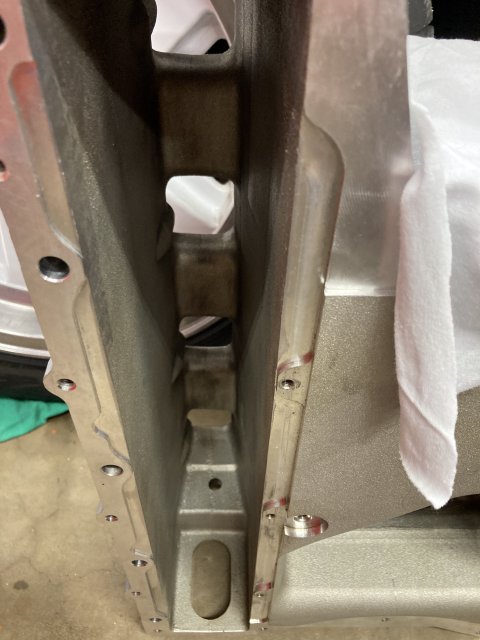

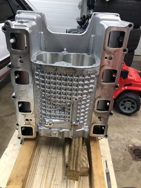

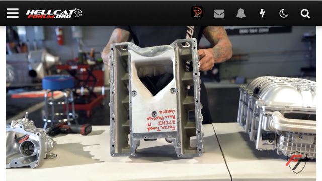

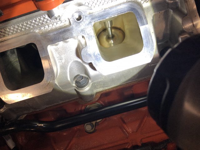

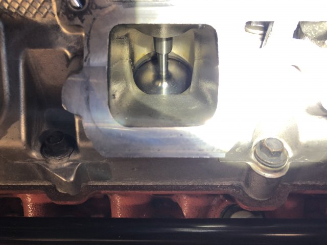

Here’s what makes the newer blowers stronger. See in this 2015 to 2017 design the wide open shared chamber area between the valve ports and the SC case body?
Now see up in the port of this 2018+ blower the added runner that goes from the bottom of the blower to just under the cooling bricks? It is between every port like this on newer blowers. It adds A ton of rigidity and strength to the case to help keep it from flexing out of shape and causing the case to squeeze down on the rotors spinning inside it with only a .003-.004” gap (cold) between the rotors and the case. These “ribs” can be seen in the Forsa video which was on Speedy’s recent SC thread. I’ll post a screen shot of it in next post

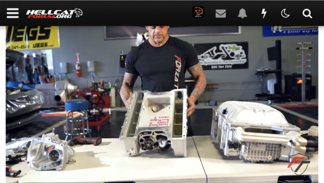

This right here about a minute into the video, Seeing this prompted me to bring this topic up of the difference from older superchargers to the newer ones and why one of the reasons the newer ones last longer and possibly make a bit more power. See the “separators” between each port under where the cooling bricks go? Earlier blowers this area is wide open and the casting material very thin. And this is where the bolts are that hold the SC to the heads are, which is also helping to stabilize and hold the top of the V together.

So that explains the "intake change" that was made to 2018 and up superchargers and also caused them to see a bit more boost with same pulley size as previous models.

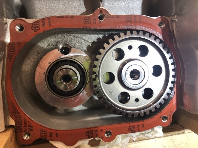

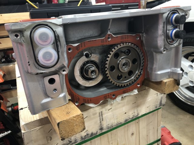

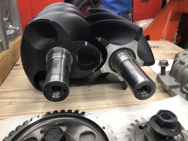

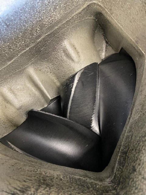

That’s more than the Teflon worn off the rotors, your blower is either knocked out of time or you have bearing issues. The timing on the rotors is not fixed, it’s held in place just like the harmonic balancer is on the crankshaft, clamp load from a left hand thread bolt, now I see why IHI wants a clutch pulley on it. See the shaft to the left of the larger gear, it’s smooth, timing is held in place by a washer!! View attachment 15701 View attachment 15702 View attachment 15703 View attachment 15704
How did you get these bolts out and how’d you get the rotors to stay still while doing so

I think you have to just jam the rotors with a rag.

Do you know the torq spec on the rotor gear bolts ?....Loctite would help since your there.
Yeah, thanks

And rag between the gears on the back gear bolts. Remember, the smaller gears bolt is left hand thread. But lossen the big gears bolt first as it’s a press fit on the shaft, the little gear once the bolt is loose it’s now loose on the shaft, that’s the one held in place by the little ring only.
But just to loosen or torque down the bolt on the female coupler on the front plate, is jamming the rotors enough or also need to open the rear and jam those gears too?

Best to just jam the rotor the bolt is in, that way no chance of disturbing timing, jam rotor to alignment guide in the bottom inlet area of SC housing.

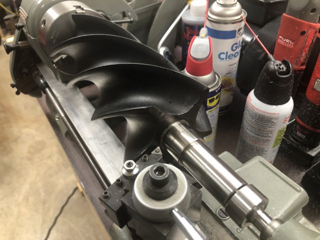

#99
Rotors look pretty when they're naked out of the case.
What's the coating on them?
#23529
29
62
Melbourne
Australia
2018 Jeep Grand Cherokee Trackhawk, 2009 e ssv ute
Teflon I think
