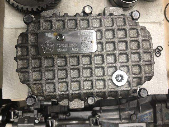

Back of supercharger on gear case cover are 2 1/8” NPT drain and fill/level plugs, they even have little magnets in them.
I’ll post a picture of the cover showing them for you later after I get home

Here you go, the drain unfortunately won’t get all the oil out of the unit, you have to remove the unit and tip it back to do so. I Wouldn’t recommend just changing the oil unless you have the supercharger off since it really can’t be drained properly in place, the oil that’s in it is good for 100,000 miles its said.

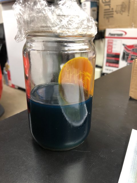

Here’s how much factory oil is only in one, that’s a16oz mason jar, so about 8 oz minus what was lost removing it

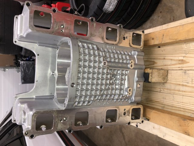

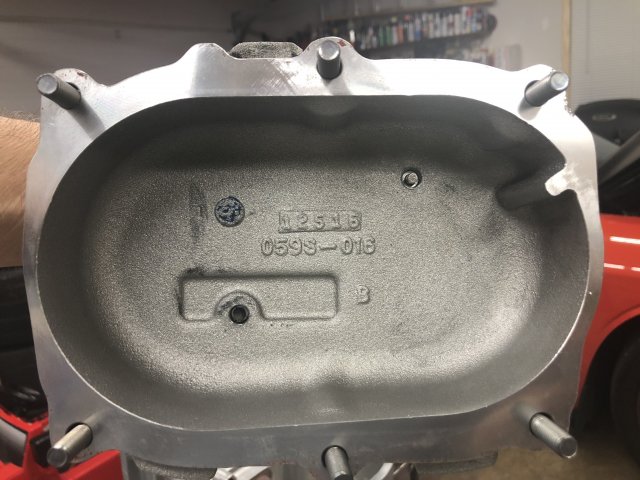

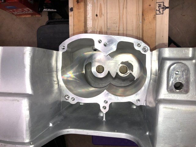

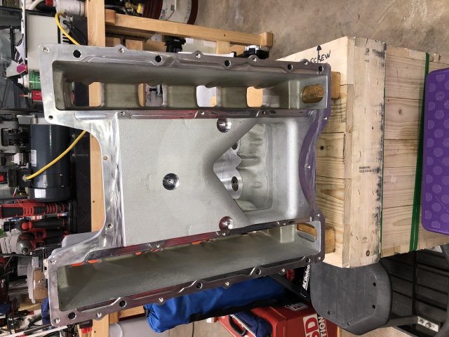

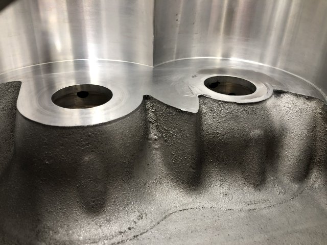

Supercharger is ready for assembly finally, maybe this weekend, this isn’t going to be a task to rush through.
Area Damaged from rotor getting pushed back from FAS bearing plate bores being too tight milled smooth and filled with Devcon Aluminum Repair putty and polished smooth. Next tricky part is going to be getting the rotors through the Teflon seals without ruining them and in through the bearings without ruining them as well.
EE1873E2-C13E-461F-B9C2-9D5224B99A9E.jpeg 65BE6C5A-ABFF-4424-8CC1-47874DDE9B9C.jpeg 30DF5A71-779A-4757-8F00-59A31C25B505.jpeg 99F3B8A0-8F43-4292-B9BD-62EEB0F1F819.jpeg
