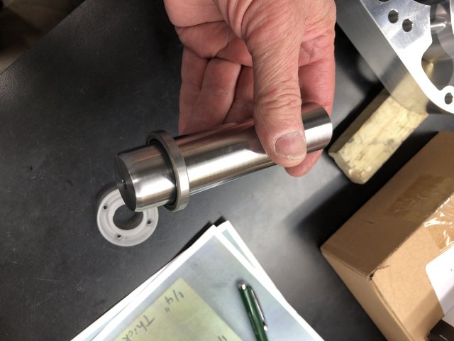

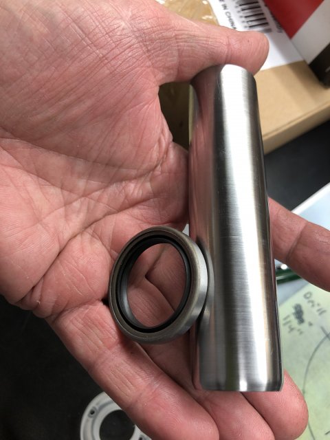

Taper tool polished to mirror like finish to not scratch the Teflon material. There’s no getting a seal onto the shaft with out it, and if made too big stretches the seal too much, sacrificed a $50 seal learning lol.

See the fine line in the shaft near my index finger in bottom picture? That’s the place to stop stretching the seal at, that shaft has a very slight taper too it. Hopefully they retain their shape at 275 for a few hours, will find out this Saturday morning lol

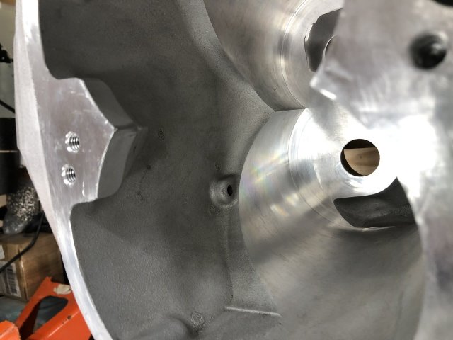

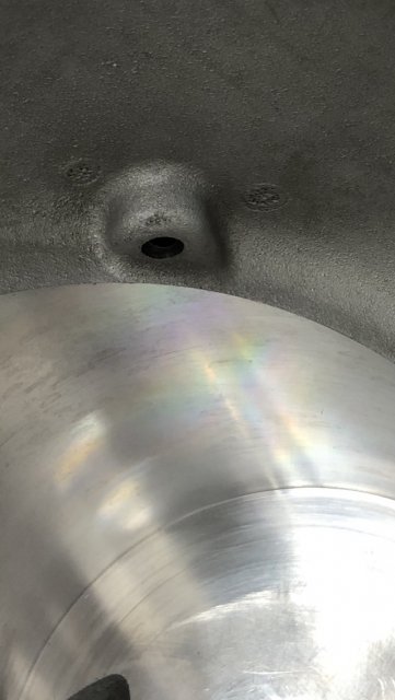

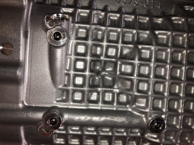

See the port in the blower inlet area? It’s connected to an area between the case pressure seals and the gear case oil seals, that area is under a vacuum and if pressure leaks it’s recirculated back into the rotors.

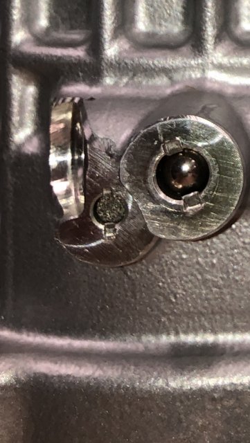

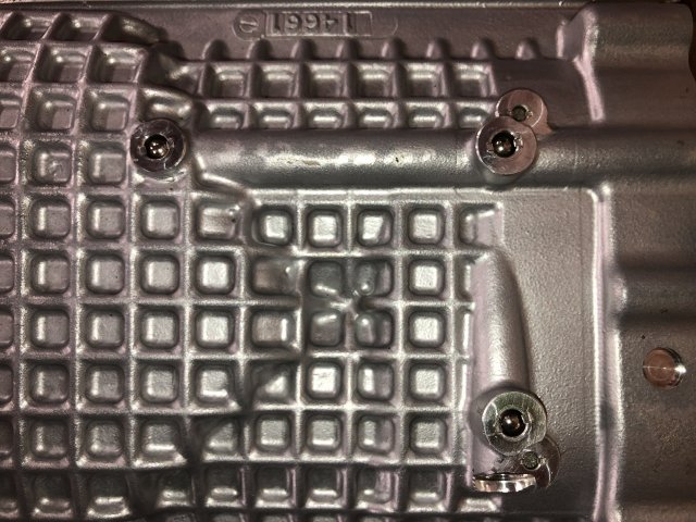

#71
Now look on the belly of the blower, there’s 2 tiny vent ports under there, next to the seal balls. There connected to an area between the pressure seal and the gear case oil seals, any oil that gets by the seals will vent out through these 2 vents. The sealed gear case vents to this area as well through a small hole in the hollow driven rotors shaft, the bolt that holds the drive gear on has a tiny hole drilled through it and that’s how the gear case vents to atmosphere. That why you always want to store these blowers level not on end, or on their sides, upside down would be ok. 8CCC92FF-9D45-4F7C-9588-C4288AA63B94.jpeg 55D5B432-2030-4331-A346-C59E577ADAF8.jpg

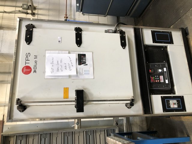

Seal passed the oven test, with stood 350F for 4 hours no change in lip tension or fit, so far looks like it’s going in the oven on the weekend lol
View attachment 16351 View attachment 16352
Dude....That is Fuc&*^% GREAT! You have to change your avatar to MAD SCIENTIST . LOL. Next sign on the oven put "Test in progress... half life of nuclear material... Please do not touch." :LOL::ROFLMAO:
