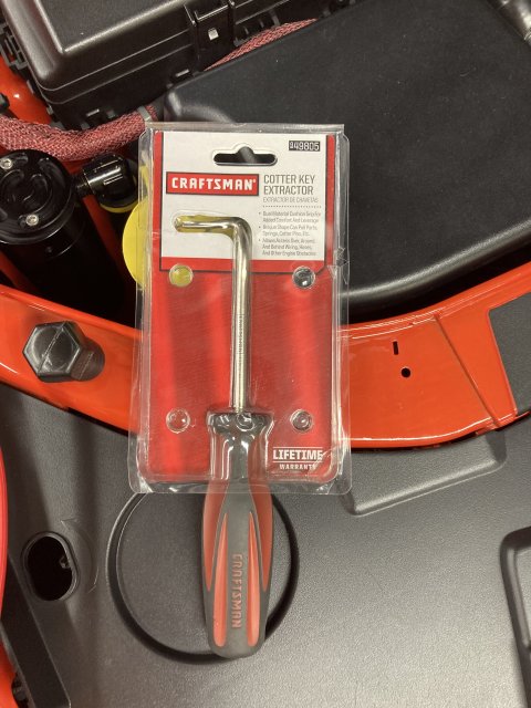

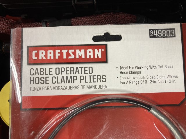

Yes you can disconnect the hoses by the tank and the other halfway up alongside the valve cover so you don’t have to mess with them behind the supercharger and then transfer the hoses over to your new supercharger going on and reconnect them in a place that’s easier to get at the clamps. But I do it at the supercharger manifold using one of these cable operated clamp tools they are great for these clamps especially in awkward places and I use this cotter key removal tool with the end blunted so it doesn’t poke a hole in the hose to get under the hose between it and the fitting to get the hose loose off the fitting so you could twist it and then I pull it off and have a cap and plug and hand and put my thumb over the hose and put a cap on the fitting on the supercharger then I plug in the hose and do the same for the lower hose. I put paper towels under it all fluid loss is minimal, be sure to crack the cap on the surge tank to get rid of any pressure first and then put the cap back on it to create a vacuum which helps keeps the fluid in the hoses. Don’t forget to disconnect the coolant temperature sensor in the back of the supercharger before you try to lift it off or you’ll break it off and not be a happy camper or spend 35 bucks for a new one that you could get from advanced auto or AutoZone. Disconnect the fuel line, and pressure sensors, TB, etc and just lift it off. You have thermal spacers and a blower blanket? A friend of mine has new stuff for sale if you’re interested let me know would be shipping from Phoenix so I could get to you quick in like two days. Probably get it for 350 shipped. One blanket comes with the spacers, the other is mine already.
F8F2C885-C7BA-468E-8AA3-0875DB459E83.jpeg E6F60796-70FF-4F1A-8A7D-659EA92C4368.jpeg 418B11AD-E44A-44F1-922C-5D8E5C1991C4.jpeg

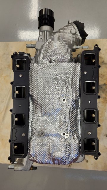

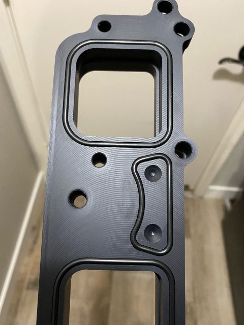

Awesome thanks for the tips. I'm getting good at this. 30 minutes and it's ready come off.

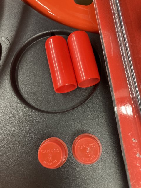

Crew Chief Greg is gonna make some 21mm plugs for the coolant lines.

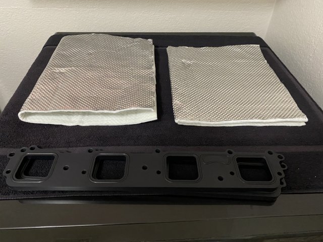

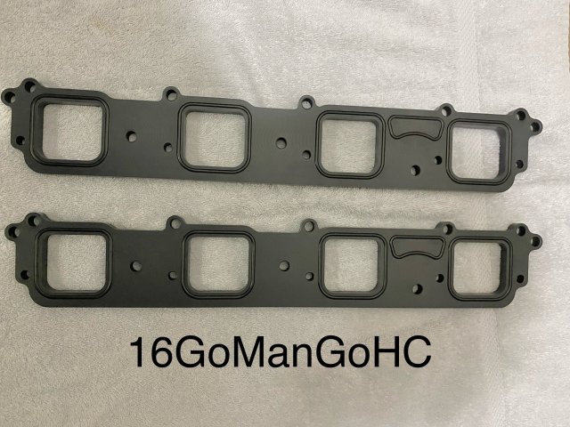

Yes I have spacers and blanket, wish I knew your buddy had them for sale but I got mine back in July.
3,808
9,019
O, I forgot to post the pictures along with my post lol
These plugs and capacity cost about $for all of them lol. The caps go on the SC manifold fittings and any barbs, the plugs go into the hoses.
31746FED-0F4B-4EA3-AD42-3F57F3127AD2.jpeg 081E1505-FAB0-4BCB-A9DF-010F9149C82B.jpeg E4690E1A-932E-448E-B784-B0378468EC9A.jpeg F3E189E0-26A6-4F0C-A120-849F5E418558.jpeg

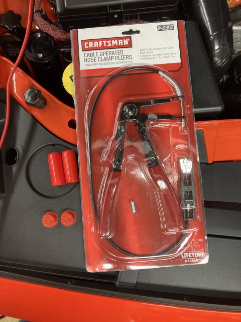

I have that exact hose clamp tool

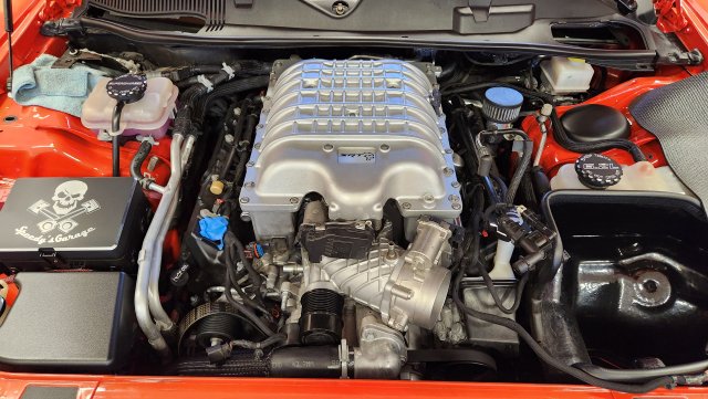

Thread Starter #211
Ready to go on
