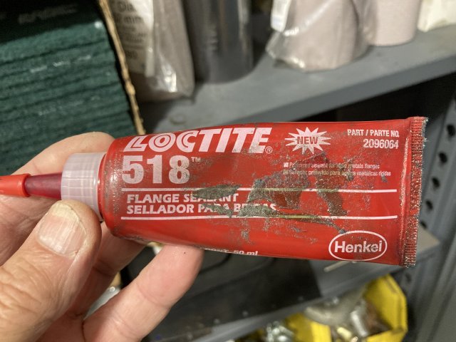

I just tighten them by feel for bolt size. If you want to find a true torque spec just look up the torque spec for the thread size in a button head and use that. But yes I use blue Loctite on them they don’t have to be overly tight but yes you don’t want them to come loose either lol.
The anaerobic sealer that I use is this Loctite stuff works great doesn’t Hardin until made it and you wipe off the excess that squeezes out and it makes it perfect seal.

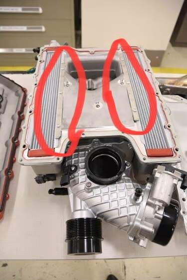

Saw about 1/2 dozen things I’d do different in that video. One thing I did notice in that video though right in the beginning notice in the supercharger under the bricks the individual runners that came up from the valve area to the bottom of the bricks. Thats one way one could tell a newer supercharger from an older supercharger. That’s one of the things they did to stiffen the case and also make individual port runners like a tunnel Ram intake. you can see the difference in the pictures here of an old blower empty case that’s wide open above the valve ports and in a newer case look up inside you can see how the runner extends all the way up to the bottom of the cooling bricks?
Newer supercharger, about 2018 and up, notice the runner that goes up to just under the cooling bricks
Older supercharger, 15 to appx 18, notice how the whole area is open and no connection between the supercharger chamber and outer walls where unit is bolted to the heads. This type is weaker and likes to break apart easier when twisted on hard with increased rpm and boost.

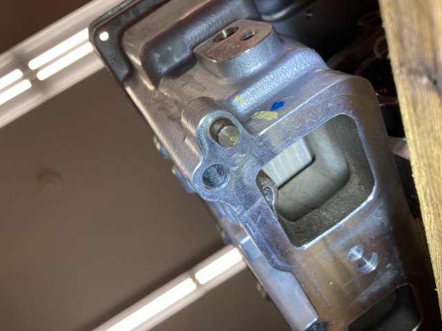

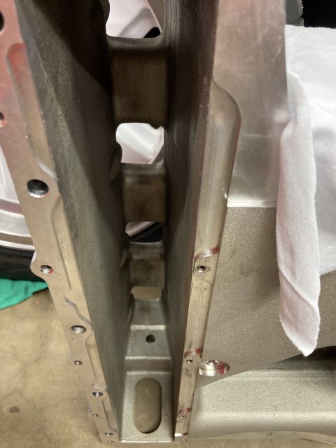

Got the blower disassembled. I think I found what happened to it. These Litens pulleys are supposed to be decoulper, so when you lock the shaft it shouldn't spin clockwise, but SHOULD spin counter clock wise. That's how the decoupler works AFAIK. This one was locked up. Wouldn't back spin. I go to remove the pulley, flip the snout over and the 15mm shaft bolt head literally falls off. It had snapped and this was before I even touched it. My "guess" is that the decoupler or something went bad and somehow caused that bolt to break?
Getting that pulley off was MUCH harder than on my Hellcat. I have a big boy impact, Nitrocat 1150 which as 1295ft/lbs breakaway torque. It wouldn't budge it! I put a heat gun on the front of the pulley for 30 seconds or so and brought it up to 150° F and hit it again and it broke free. Crazy it was that tight. No loctite on threads. That had to be over torqued?
