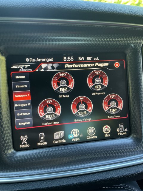

So after my last few passes at the track I noticed the car was not cooling down to the usual 192 degrees after a pass. I have a Jet Performance 10183 thermostat. While driving today, 66 degrees out, the car would not get cooler than 204 degrees. So a couple of things I’m thinking may be the culprit.
  1. Mechanical failure.
  2. Tune somehow has fans set for 204.
  3. Air bubble.
I’m ruling out #3 because this would have surfaced a long time ago… And I can’t see if #2 is the culprit as the tune is opaque from OST… if the thermostat is stuck, does anyone have any recommendations and should I go with a cooler thermostat if I have to replace it?
  3. Air bubble.

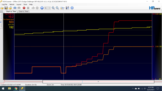

Have tools, use tools... Decide to setup a quick graph to log the fan pwm, fan speed and ECT to see if anything was amiss in the tune. 100% not the tune. As expected when I sent my tune to OST for refinement, I had the fans kick on at 185F in which they did.
Then an interesting anomaly at 192F the thermostat struggle bused, opened and then closed again it looks like:
Then from there the bleeder valve in the jet (at tdc) was able to prevent total meltdown. Waiting for the car to cool down to pull it. Gonna toss it in some 185 degree water and see if the filament moves. If not, then something else might be amiss like the pump, car is down, I repeat we have a code red, car is down!
