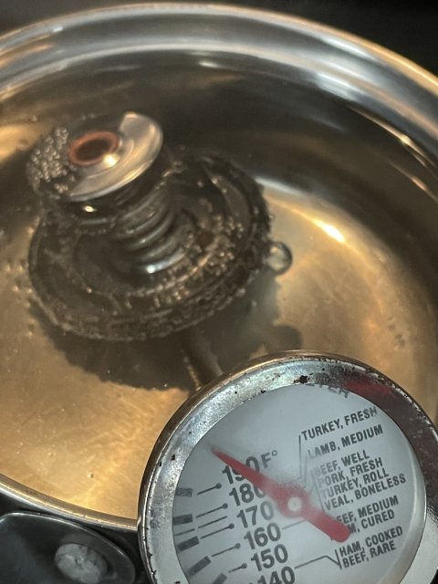

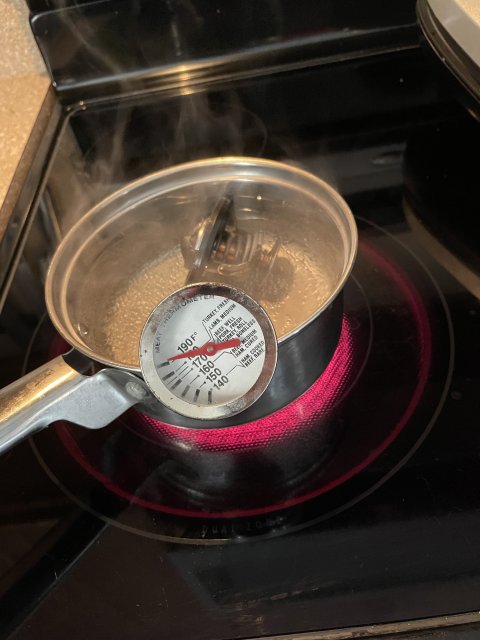

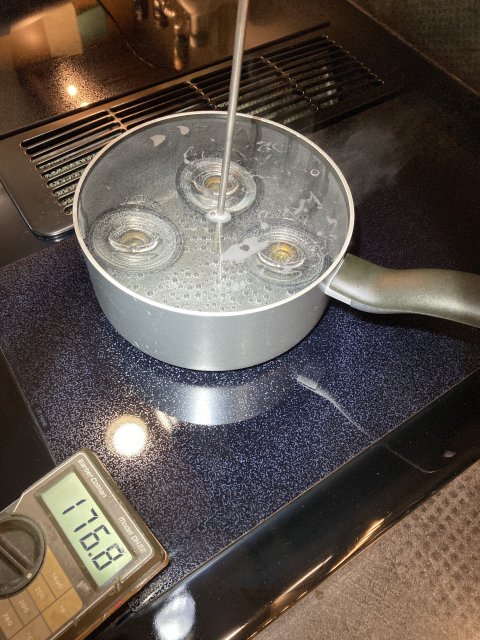

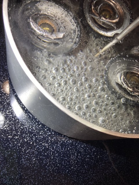

Just got the new thermostat… didnt open at 180…
got it above 190 and it opened, not happy…
Dont know if I should install or just throw it in the trash… Motorad… 🤬

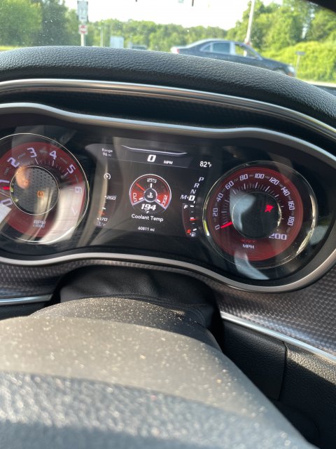

I had a Motorad originally I think, been a couple years, and mine failed so I replaced it with a Mishimoto and it's worked great. It's a 180 and I'll see 185 on the screen. Once it hits 192 I'll hear the fans for a moment and then back to 185 lickity split.

The initial open on the Motorad always seems to be over 185, they have been like that since the old days. I don't think that's strange and IMO is a good thing because it helps prevent the CEL of 3 consecutive starts not hitting an initial temperature... if it opened later around 180-185 and then stayed open I think it's doing it's thing. Now the whole concept of partial opening, that's kind of new to me. How do we know? I don't disagree with swapping to the Mishimoto as it seems to have such a good track record.

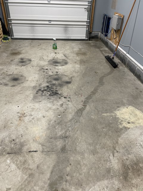

The that is currently in is the one from your link in your OG video. This one is from HHP. If it goes, then Ill order the one you linked. Also now have a giant purple puddle…

Well tested the old one… didnt even move…
Cleanup on isle 3 has commenced, not a single towel caught any 🤣
You gotta throw in a few of those chicken bouillon cubes once the water boils :LOL:

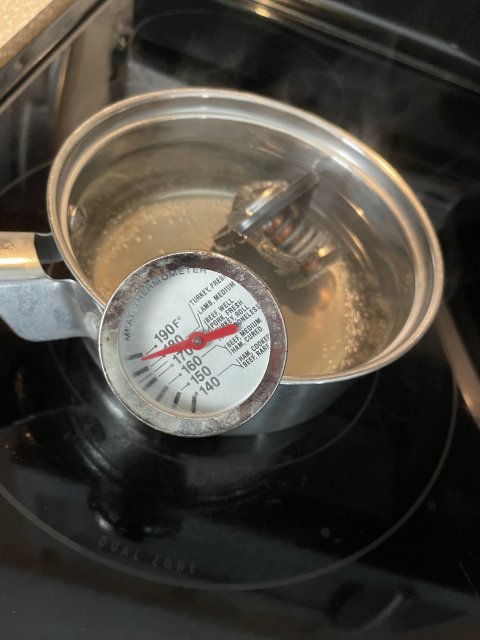

That seems about right, 180s seem to open around 185, and don't fully open until about 15 degrees or so above their rating.
Try a digital thermometer to double check the reading, but that Motorad seems to be normal.

I wouldn't assume that an old cooking thermometer reads within 10 degrees.
Yep a meat thermometer is definitely not accurate. Picking up a heat gun tomorrow for future use.
Truth lol…

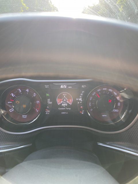

then when the fans kick in
very happy shes a happy kitty again, wonder if the high temps were robbing me of some power last time at the track 🤔

So is that the Motorad/Jet 180 at work for you and working properly?
Yep everything is good, car is cooling as expected. Very happy.

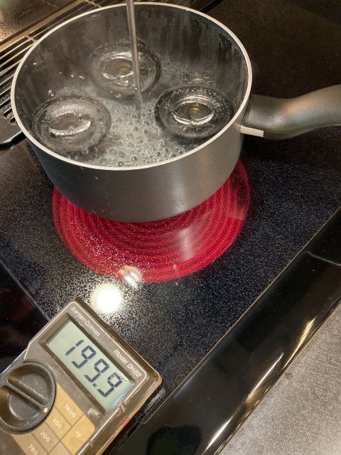

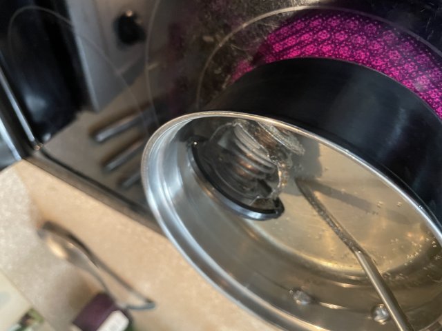

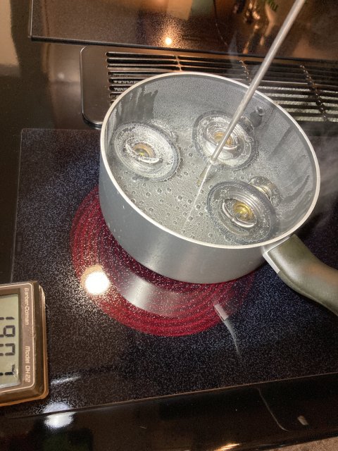

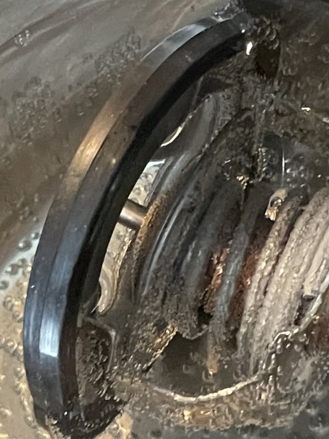

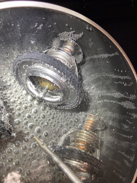

Testing T stats last night, one is out of motor before rebuild, it’s NOT going back in. Got it from HHP, at 205 just started openning, it says 180 on it. One I have new in box that says EVENFLOW on box, same design, same insignia in the stat well where temp rating is stamped, started to open at 185, full open at 190, on cool down fully closed at 178. I tested a 160 I have as well, same insignia inside it, it was fully open by 170 and closed back up at 155. I have no idea the OEM on these??? I won’t be using the 160 so if anyone wants it let me know, $25 shipped. I just ordered a new $50 180 Misimoto last night, will test it too when it arrives. T stats where offset in pot and pot offset on burner to keep direct heat away from their operating end. Heat applied slowly so units had time to respond to heat change, tested with digital gauge, I’ve done this with every t stat I’ve ever changed, I hate antifreeze about as bad as caulking so repeat work for a non working t stat isn’t in my game plan ever so I test them before use, most times old one and new one in same pot just like this, my wife loves it lol. Now I know why my fans ran so much, t stat I was using SUCKED!! EF338E45-938E-41A4-987E-D1E43E24550D.jpeg CF5C4AF3-6964-4D54-8AB2-01DDBE915012.jpeg 7F6440D0-7AB5-419D-B2A9-E30309321B55.jpeg F6FFC491-DC3D-4A86-A455-2124A5AAD102.jpeg 22D96605-58F9-4260-95D0-F29F31703790.jpeg

I ordered one, I’ll test it next to the Misimoto, it looks like a Robert Shaw unit, I’ve used them in the past with success
