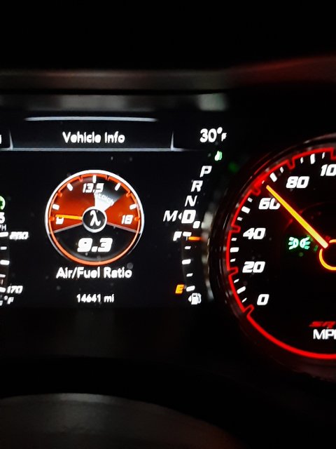

Caught it on a high bounce. It's been hovering around 9.1 or 9.2 for the majority of this trip. That's how you know the good sauce is in the tank.
Cruise set at 65 and yes it's 30 degrees and snowing on I-79 right now
Full send.
Full send.
That’s great racing weather 😂
