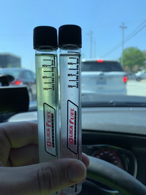

I’ve run e70/e85 for 15k straight. Believe it or not, I still look at the fuel before every fill up in my mason jar. I caught a gas station error with a “miss fill” in the e85 tanks. I just no longer use the test tube.
My 1D1300s have been fine. I change oil every 3k.
