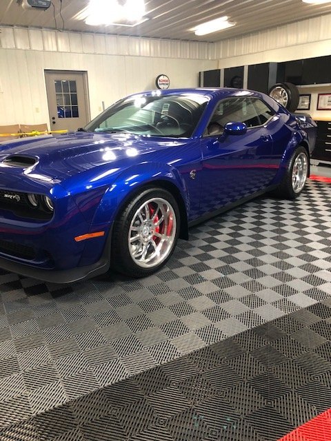

Got mine finished up. All I needed was 2020 hellcat rotors that had a 15.2 "diameter and then did a end mill adjustment to the mounting holes on the calipers at the machine shop to set them down .285 lower and had inserts made to go into the slot with the mounting bolts back side that are also .285 to fill the void. You can still go back to the 15.8 rotors by changing the insert back the other way.
#56
BTW,, 3:40 am again. Calipers were painted a bright orange for the Universitey of Tenn I attendeded to after Military Acadady,, Ha ha. Funny but not. I then found out Tenn did,t do very good and had them repainted red with the engine red and calipers and the red eyes hell cats and rear end , goo look, DoDGE rear end painted and hell cat heades with his eyes with red eyes done by electrical engineer from Cali and attacheded by friend from Clear wataer, electrical engineer attached. Redone in red. The whole moter is done in red and black. Where the silver Hemi is done in silver is now black, and the cold intake is now red with the plastic electrical pices are done in red. Red and black. That was done 2 years agow with a rice tag og $10,000 with the heads and other colors done in black. Just had a painter look at it and re going my handeled red plastic done in red, redone. Black Hemih still good in black. Red eyes still done. But better red eyes. Bumper and DODGE better red. I need to take pics of these to imaginge the looks of the $10,000 paint job on all of these painted red with black satin black. All redonde again after 3 years. Even the 70' s 396 Hemi big block Chevelle thought it did well, and the BMERs and Roush Stangs and the 6.1 non in impressive thought it looked great. Some what noe one has this fit,, yet.,, not yet. See what chay think from a Tenn guy and Fla guy. Broke sholder still hurts and other parts does also. 4 weeks in the Hospital and 4 days in Baker Ackeded and wonder hyw my guns were taken ahey by the cops.
