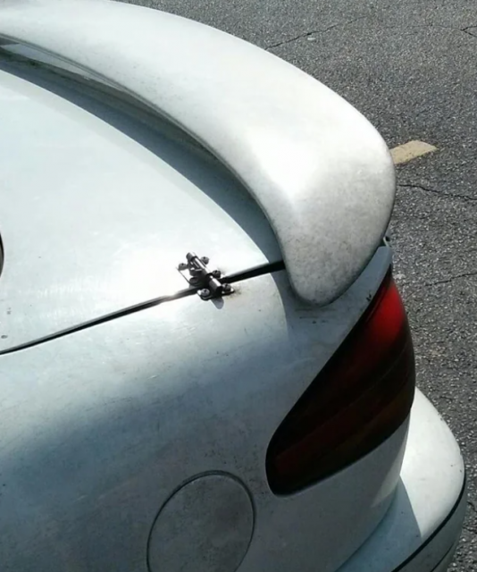

$5.00 at Home Depot and your all fixed. Easy peasy!
