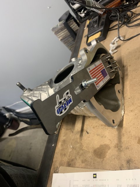

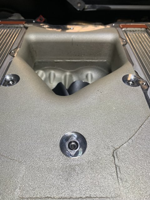

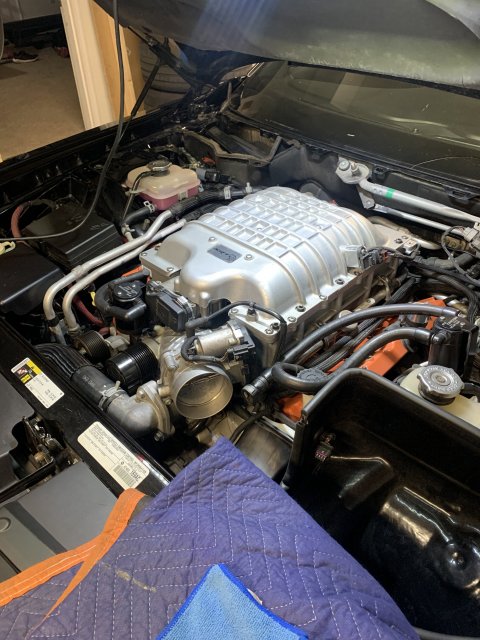

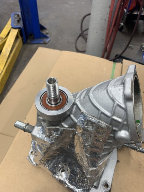

Cleaned that god awful dirty lid and got the snout off. Forgot I had the heat blanket on and that was a joy to cut. Snout off just waiting for my 24mm hex insert.

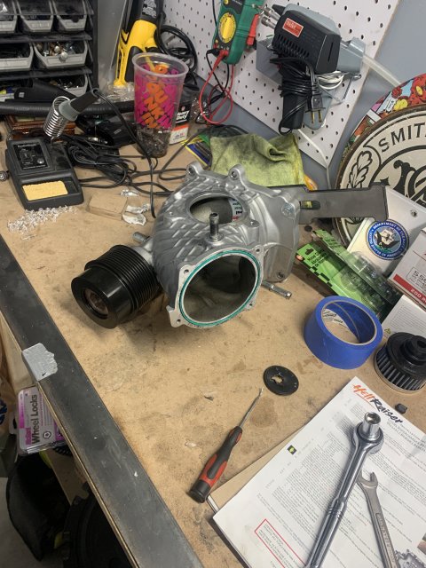

BA0C6E29-0260-4FA4-8861-570AC176C5EF.jpeg 8EA9C18D-8F24-424C-9D7A-AA4E89BE667C.jpeg 2A40192A-DF6C-4595-8CD4-8734023A3F74.jpeg BDB038E5-2C43-4F28-BA9E-06B86D8D9138.jpeg It was a good day, got the forgestars on. Got my gasket kit as I plan to replace the gaskets (at least the ones I can get to) since the SC has 58K on it. Also got the pulley off. A note about the god damn pulley, I tried a breaker bar, impact driver and my electric ugga dugga. Nothing. Took it to my friend who has pneumatic ugga dugga and after a few brr brr brr, it came off. Meanwhile i stuck around to help drop a trans in a durango he was yeeting. Also snapped a pic of his turbo scatpack... the car is nuts... im sure the mopar world will see it soon.

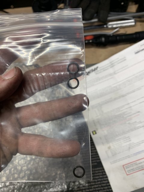

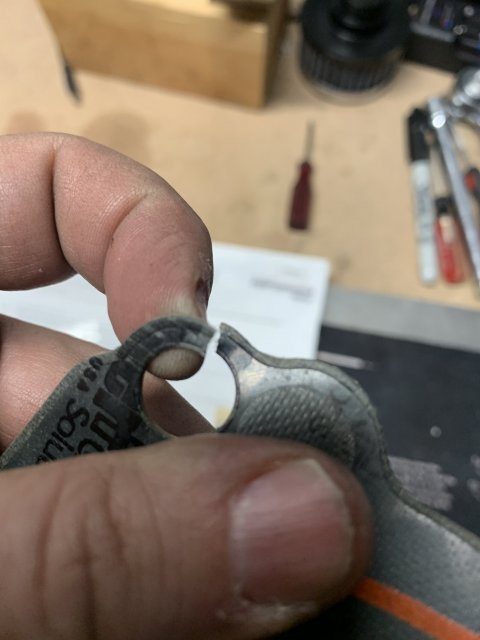

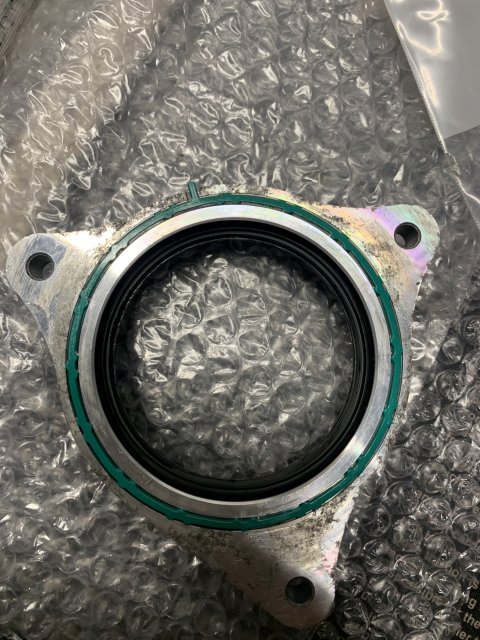

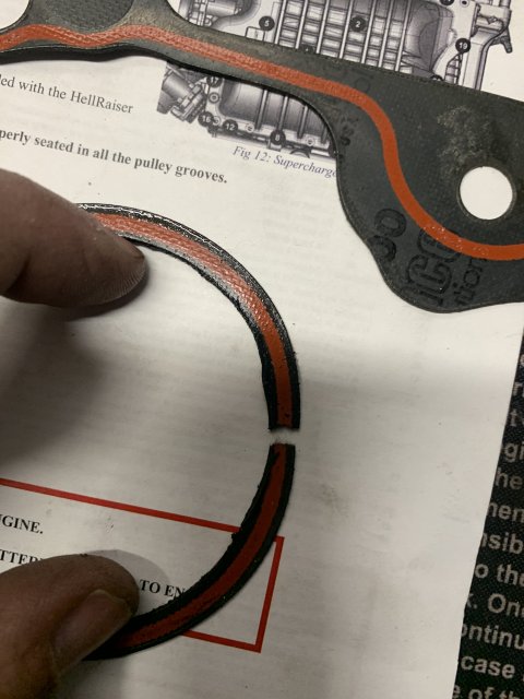

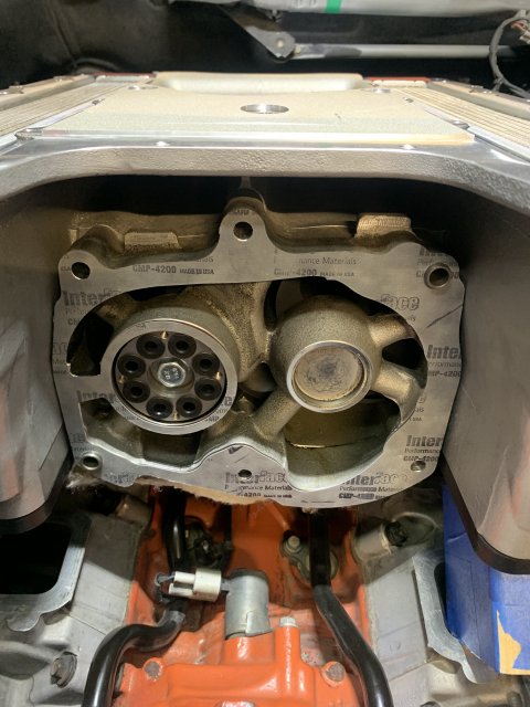

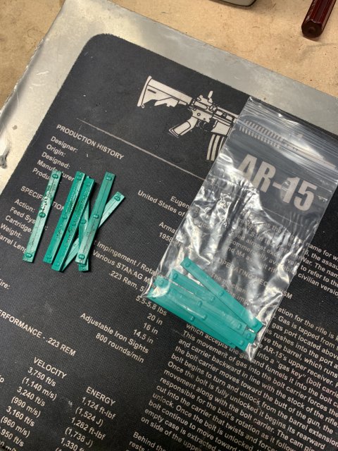

Pic heavy sorry! Glad I replaced the gaskets and inspected the bearings. Everything looks good on the bearings, no play. Blades move smoothly. Although the coating is looking a little worn, no blades are damaged. Replaced all gaskets and rightfully so! Check out these that were broken on the snout.

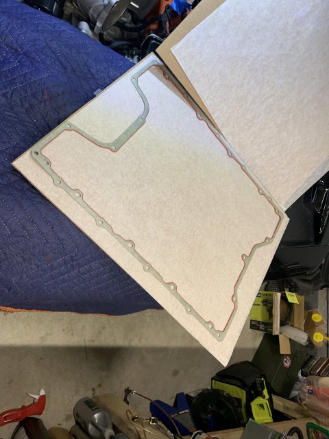

Then I moved onto the boost controller gaskets.
2D5C4C13-72C6-42CC-A014-7E72BBBA8ADD.jpeg 1958FF24-4AA3-4C91-82D7-4C56EEB31D5F.jpeg

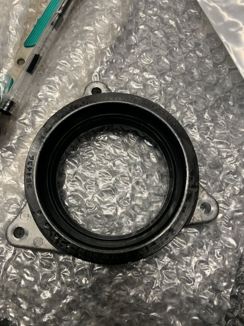

Lid o-rings were next. Hit all gaskets with some 0W-40 before insertions (multiple insertions).
BB47EC7F-AD75-4942-95A4-E1811197B572.jpeg 19A375A2-7372-419E-B728-2680F768FE3D.jpeg
I also replaced the gaskets to the side of the o-rings. Forgot to snap a picture, also couldnt find a torque spec to hand cranked them enough to hand snug then, one quarter turn. Final assembly was the lid with all new gaskets. Wish I could wrap this up but belt wasnt delivered in time. :(
View attachment 39907 View attachment 39908

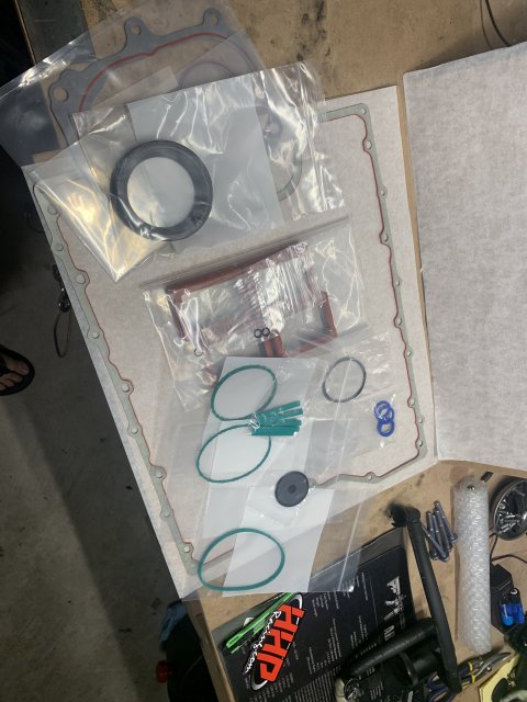

The item I ordered was from HHP: https://highhorseperformance.com/mopar-hellcat-supercharger-gasket-kit-68267539aa/ For some reason you can't find them on mopar.com :unsure: Also went back in as we talked and added blue locktite to the bolts I couldn't find torque settings for then torqued them to 5ft lbs. Didn't squish the gaskets and don't have to be paranoid about the bolts backing out.
