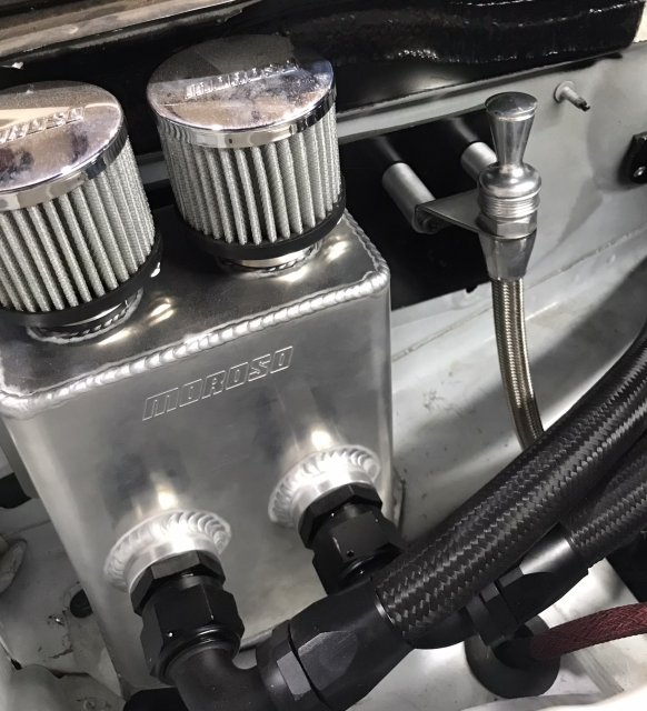

Something about catch cans. As the boost goes up… the need for a can goes up because crankcase pressure goes up. Stock boost motors in good condition have little need. The valve cover baffles do the job of controlling oil and if you use a breather on the valve cover to relieve crankcase pressure…. You’re good. If you do want to run a can that actually works and is not just for looks…. mount it away from the motor where it is going to stay as cool as possible. A hot can is not going to condense anything, and that is one of the factors in how they work. If you are in the 1000+ hp club….. I suggest you look at the vented type cans like the Motion Raceworks I previously mentioned. Nothing else compares for the price. Educate yourself on how a catch can works and why you want one instead of just doing it because others have. This is what I use (no I’m not suggesting that you use this one). But as you can see… it has breathers that relieve pressure and there is no return line, so there is no (as in zero) return to the engine intake. If you don’t want to be injecting oil, water and fuel vapors into your intake for your engine to breathe… a vented can is the way to do it. 4627799E-C7CB-4699-9622-4667F74860F5.jpeg BB4D41A4-F417-4B48-8765-50817B4B326A.jpeg

Looks pretty sweet but it's pricey
You get what you pay for, the dual valve model is for boosted applications. But it is pulling all the time when it's under boost or normal operaton

Something about catch cans. As the boost goes up… the need for a can goes up because crankcase pressure goes up. Stock boost motors in good condition have little need. The valve cover baffles do the job of controlling oil and if you use a breather on the valve cover to relieve crankcase pressure…. You’re good. If you do want to run a can that actually works and is not just for looks…. mount it away from the motor where it is going to stay as cool as possible. A hot can is not going to condense anything, and that is one of the factors in how they work. If you are in the 1000+ hp club….. I suggest you look at the vented type cans like the Motion Raceworks I previously mentioned. Nothing else compares for the price. Educate yourself on how a catch can works and why you want one instead of just doing it because others have. This is what I use (no I’m not suggesting that you use this one). But as you can see… it has breathers that relieve pressure and there is no return line, so there is no (as in zero) return to the engine intake. If you don’t want to be injecting oil, water and fuel vapors into your intake for your engine to breathe… a vented can is the way to do it. View attachment 98831 View attachment 98832
Excellent explanation 👌

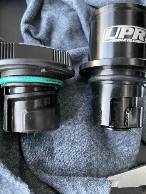

I just got the 15-20 hc UPR breather and it doesn't fit. The grooves don't quite line up. I thought I was going to break something trying to force it. Any other brand ya'll are using?

I got it from lethal and they want me to send them some pics. The notches are really close but just a little off so it won't lock down.

Yes. Its only off by a small fraction but I was going to break my oil fill tube before it would twist in so really didn't wanna do that. I'll post some pics. It looks damn near identical to the stock cap so idk. I'll check w a caliper.

The grooves are tapered on the cap so are the notches in the oil fill tube. You can see where I’ve been pushing down and twisting pretty freaking hard by hand. No luck. Not trying to use a hammer and wrench to get my oil cap on and off lol.

Looks.like the bevels on the original.and not.on the upr model
